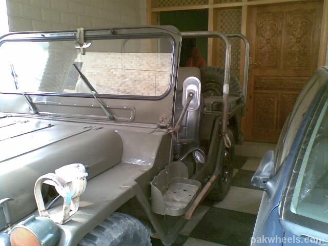

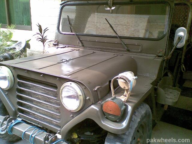

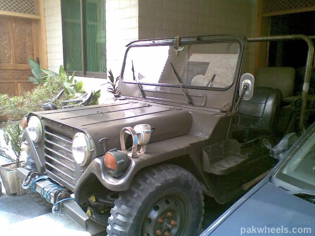

yes iftikhar is gud, and i havent assign shakeel for paint Job, most of the parts that require different color like red and black will be painted in my friends paint shop and remaining body will be painted at Garden.
@Arif
yes this includes orignal bench and hood bars, soft top and two doors aswell. it is M151A2.

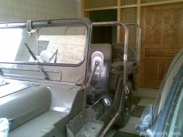

i have seen there M151A2 with side single benches and recoilelless rifle stand, this means either Army has altered those that way or A2 has this capabilty. though i know that require double shocks as mentioned by sherwan, but those machines were with single rear shock each side.
If you see the pictures i have uploaded you will observe that it had side single benches as well and were removed.

No Amin, M151A2s comes as a forward control jeep as well as a gun/missile carrier. The gun/missile carrier is the M825 variant.
The holes maybe there on the FC jeep but they are stock, as the wireless set can be installed there.
The ones with fender seats also have two handles on each side for the occupant to hold on to.

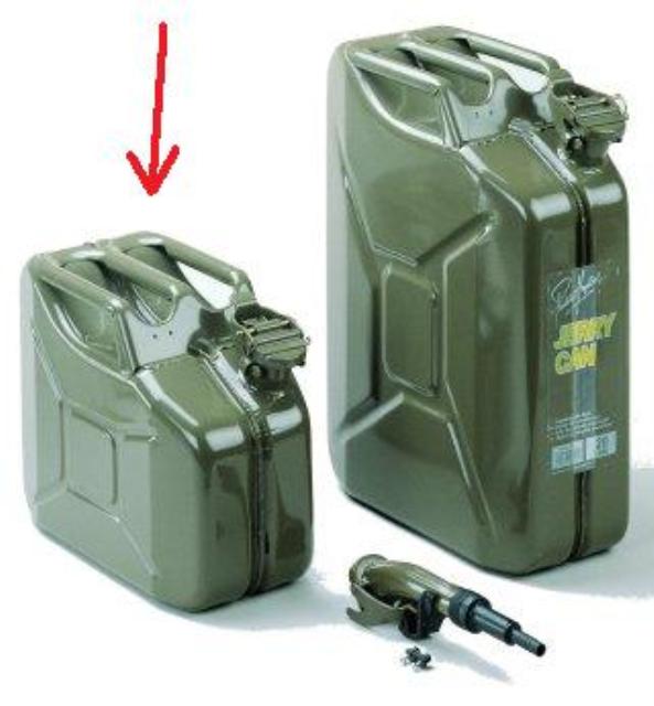

Anyone seen these 10 liter jerry cans around anywhere ?

If you end up finding them, i pre-order 5...

5 ....... thats alot
I'm thinking of cutting the big ones and making them out if I dont find 'em

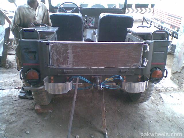

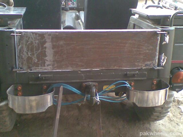

Nice ..... a few question though !
1) Why ?
2) Does it open ?, if so what side ?
__________________
Real jeeps have horizontal grills.
sarmadqureshi is offline   Reply With Quote
Old 02-11-2009, 12:33 PM   #554 (permalink)
156 days old at PW
Location: Multan
Age: 33
Posts: 370
Default
Sam
I have few reasons to close the back.
1) I have to put in front forward two seater bench in the tub, so i need to close it from the back.
2) i like the gerry and spare wheel mounted on the back.. so m closing it and will mount another can and another spare wheel.
yes it does open, door opener is right behind the driver side from inside.
work is in progress in this picture,, not completed.

Ok, so you didn't want to go with a standard cut shaped plate at the back ?

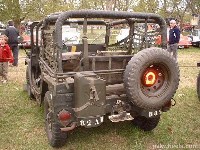

Had always seen the last picture in the series of it, finally got hold of the complete set.

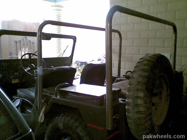

Blackout light, Wipers, Back view mirrors, rollbars, rear single seat, rear gate, extra spare wheel mount, extra gerry can mount installed.

Looking nice, so you went for the roll bars outside fit.
Is the rear seat original ?
