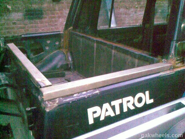

Converting my Nissan from High Roof to Low Roof Double Cab, weeeeeee!
Chopped the roof today, the adventure begins!

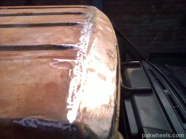

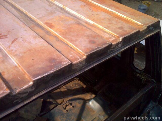

Just an advice.. If you can, try to find someone who can MIG or TIG weld the roof. Normal stick welds or gas oxy-acetylene welds will cause a lot of heat distortion and denting this out to near perfection will be cumbersome if not impossible specially at the curvy parts of the roof..

Great progress there. It is looking awesome.. Thanks for sharing.. Just an advice.. If you can, try to find someone who can MIG or TIG weld the roof. Normal stick welds or gas oxy-acetylene welds will cause a lot of heat distortion and denting this out to near perfection will be cumbersome if not impossible specially at the curvy parts of the roof.. Ehsan
Thanks Ehsan,
Fortunately the welding is all pnuematic, gas welding, and i'm doing it. A professional denter is. So its all in good hands. I handed over the project to the denter just after the eyes thing.

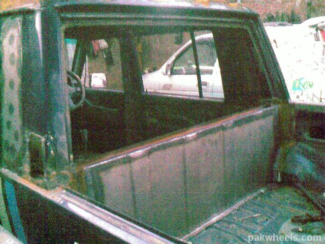

Update....

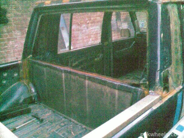

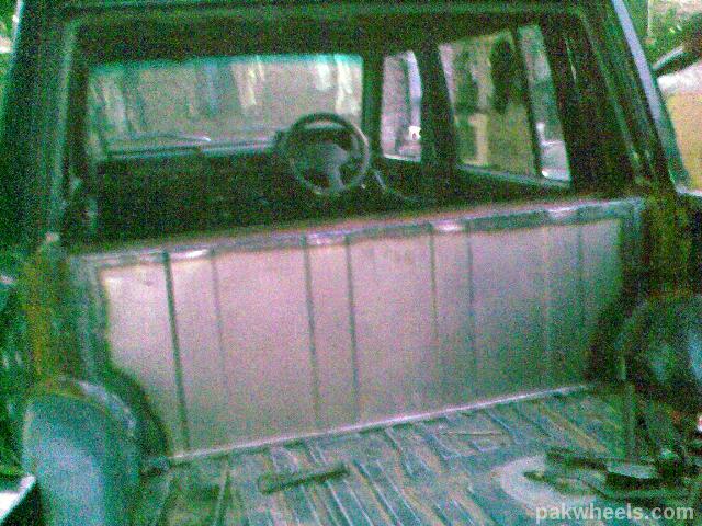

Update, Sorry for the bad quality of pictures, couldn't do much because they were taken at night.

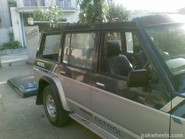

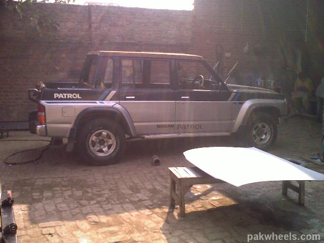

Another Update....:p
