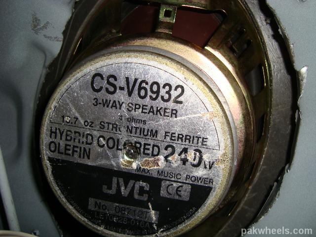

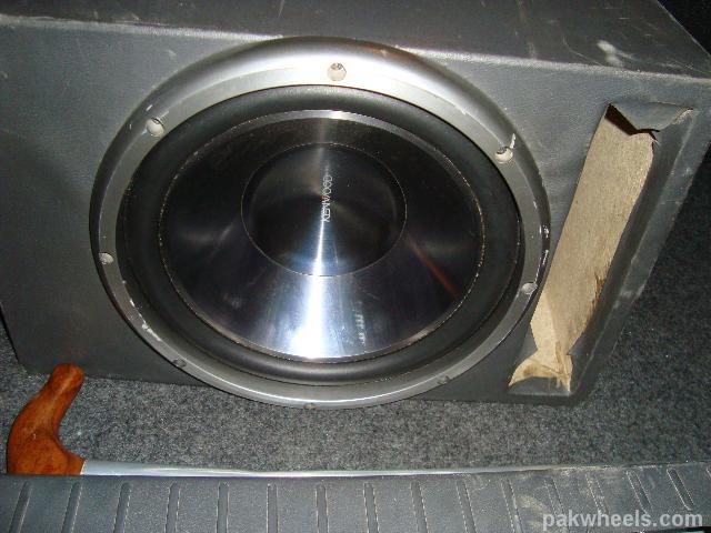

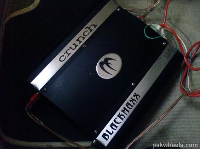

im looking to buy an amp in about 9k price range.currently im using a crunch 500w 2channel amp n n im not satisfied with it,running a 12inch sub n a paire of jvcs with it.
before that i had a audiobahn 1600w 4 channel amp which i sold n made a stupid mistake.im planning to sell my crunch but the question is what amp should i go for???
the problem im facing is the sound gets distorted at high volumes
how wud u rate this crunch amp keepin in mind that ive to run,
a 12inch kenwood sub n a pair of 6 x 9 speakers
any suggestions would b welcomed
these r the stuff im using for the time being + 2 pairs of door speakers which r directly connected to the player

this amp not bad .. but the problem is that u r not using it correctly as its 2 channel use it for speakers or use it for woofer..
well i would suggest either buy another 2 channel amp and use that for speaker and use the current for woofer by putting it on LPF... or wise versa..
or exchange ur amp with a good quality 4 channel amp and use 2 channel for speakers and a bridge connection for woofer...

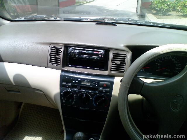

i c a sony pre ..which i think it has no crossover or a sub out wid basic options ...start wid a good powerfull headunit always ....
secondly ur getting the mids in ur sub becoz in ur setup speakers and sub both are running on full crossover u cannot tune ur speakers to hpf and sub to lpf at a time....so find out a 4 channel amp if u r not intended to change the sub....but if u want to add another sub or any SPL then buy a heavy 2 channel amp or a D class mono
