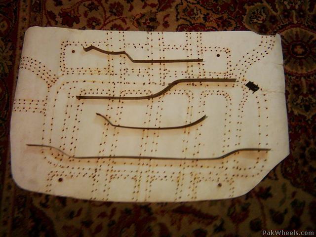

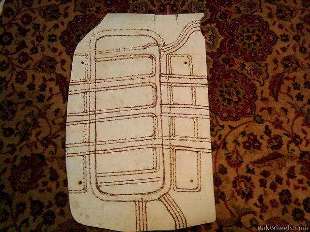

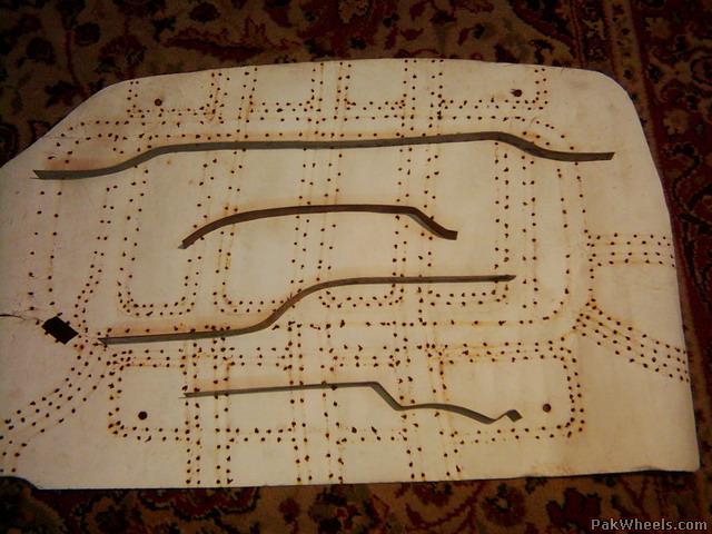

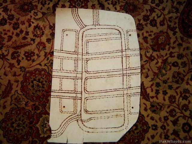

Quote:
Originally Posted by spitfire

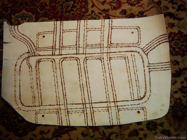

If you pay a little attention to these pics,you can see that these floor pans are very complicated.note the inner tray and the pattern of different types of grooves and their different depths and the water drain channels.I made again a pattern like I did before on a chart paper which took me 3/4 days and a lot of patience and hard work.just have a look at the pattern I made....also note that I made steel strips patterns of different depths of grooves and shapes to check and ensure the exact duplicate of the original floor pan......see the pics of pattern...
Mind Boggling, havent seen anything like this before. Amazing skills, too good stuff indeed!

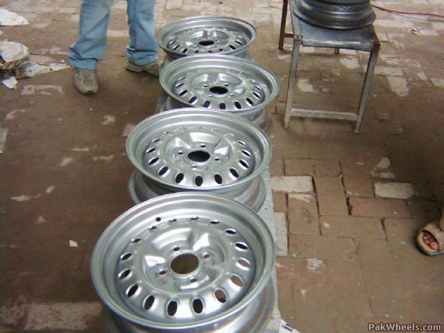

Four of them???
The guy did a great Job. Moggie has reached similar state, all RIMs need cleanup/removal of old paint and rust followed by "Old English white" spray on them
Basharatu is offline   Reply With Quote

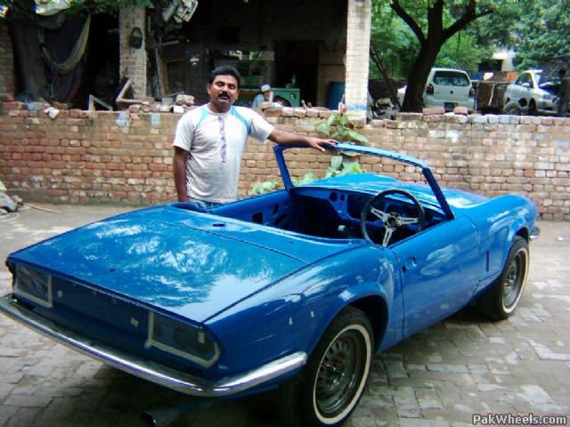

decided to do this car in blue ...but which blue????it took us 2 months to decide the correct shade....
made many samples in the meanwhile but nothing clicked.

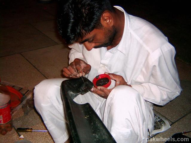

salamz pakwheel brothers,
After a LOOOOOOONG break we continue this thread.Tha last pic posted was of front air dam being repaired..maintaining the sequence....
After making small steel plates for repairing,adhesive (magic epoxy steel) slow drying one was applied...
A TIP...if a little metal powder is added to the mixture of magic epoxy/depoxy,it adds to its strength.
spitfire is offline   Reply With Quote
