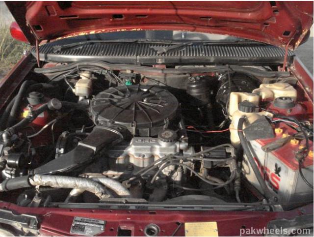

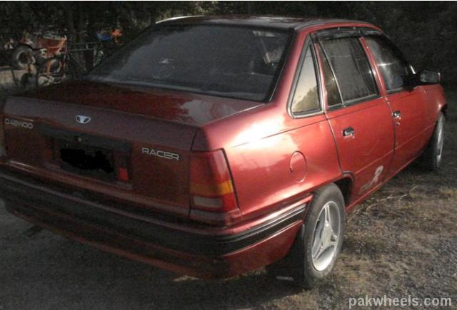

Hello all! I am an owner of Daewoo Racer for the last 11 years. It has proven to be a very comfortable and economical car throughout this period. It used to give an average of 13Km/L within city and ~15Km/L on long drives. Here are some pictures:
[check the link for
http://my ride at PakWheels
I would recommend buying this car who want a better car at low budgets!
Any member having used a Daewoo must share their experience....(y)

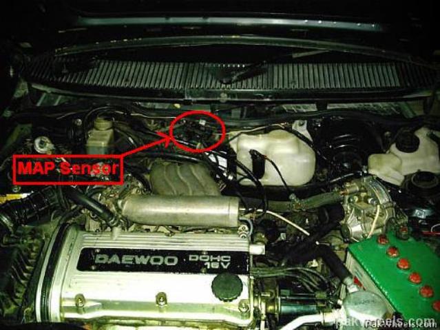

@Testdriver: Thanks for your detailed reply. Mechanic has checked CO adjustmnent acording to your defined specefication.
He is not aware about MAP sensor vacuum pype (they may call it with diff name). Can you pl tell me its location in a picture.
Thanks again.
Yes u r right, silencer was black. means dry Kalack (not oily)
Thanks again.
Shah73 is offline   Reply With Quote

Quote:
Originally Posted by Shah73
@Testdriver: Thanks for your detailed reply. Mechanic has checked CO adjustmnent acording to your defined specefication. Yes u r right, silencer was black. means dry Kalack (not oily) He is not aware about MAP sensor vacuum pype (they may call it with diff name). Can you pl tell me its location in a picture. Thanks again.

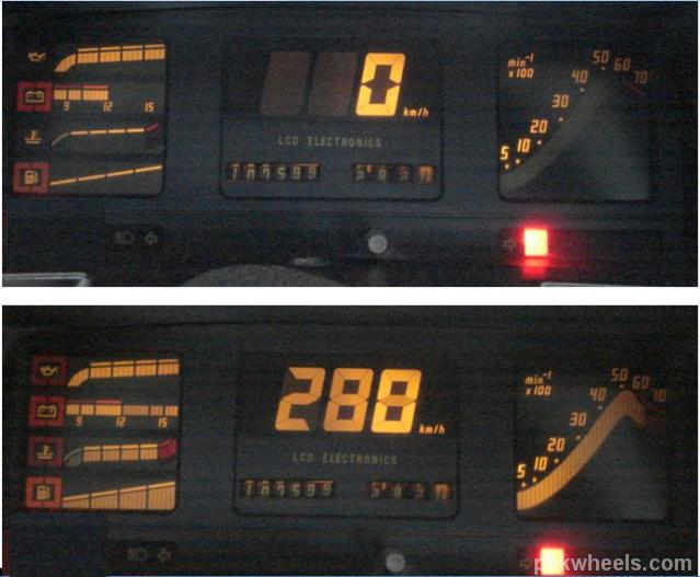

Salam Bros. I m also a very big fan of Daewoo Cars. I m enclosing some pics of my ride. I owned this since last six months. I never got a daewoo before this one. I love its ride, comfort and speed. I traveled many cities, like Lahore, Peshawar, Mianwali, Kharian, Gujranwala in this car and never faced any problem Alhamdulillah. B-)

nice ride mashallah, bro i m also looking for a digital meter for my racer, kindly guide me to the place and some expert technician to install it well.

I got it from Mr Khair Mohammad Ahata Mithu Khan. He imported the same from Dubai thru his brother. It will cost u round about 8 - 10K depending upon the condition of the meter. Mr Akhtar Alam is the right person for its installation. My meter was also installed by Mr Akhtar. His cell No. is 0333-5509919. His workshop is near Kohinoor Mills, Rawalpindi.

nice ride, digital meter looking cool,

nice ride bro! i like your digital meter. does all the indicators on that panel are working just like the stock panels?

Thank u bro. Everything of the meter is working perfectly. All indicators are accurate. Once i checked this meter by racing with a city and found it accurate.
