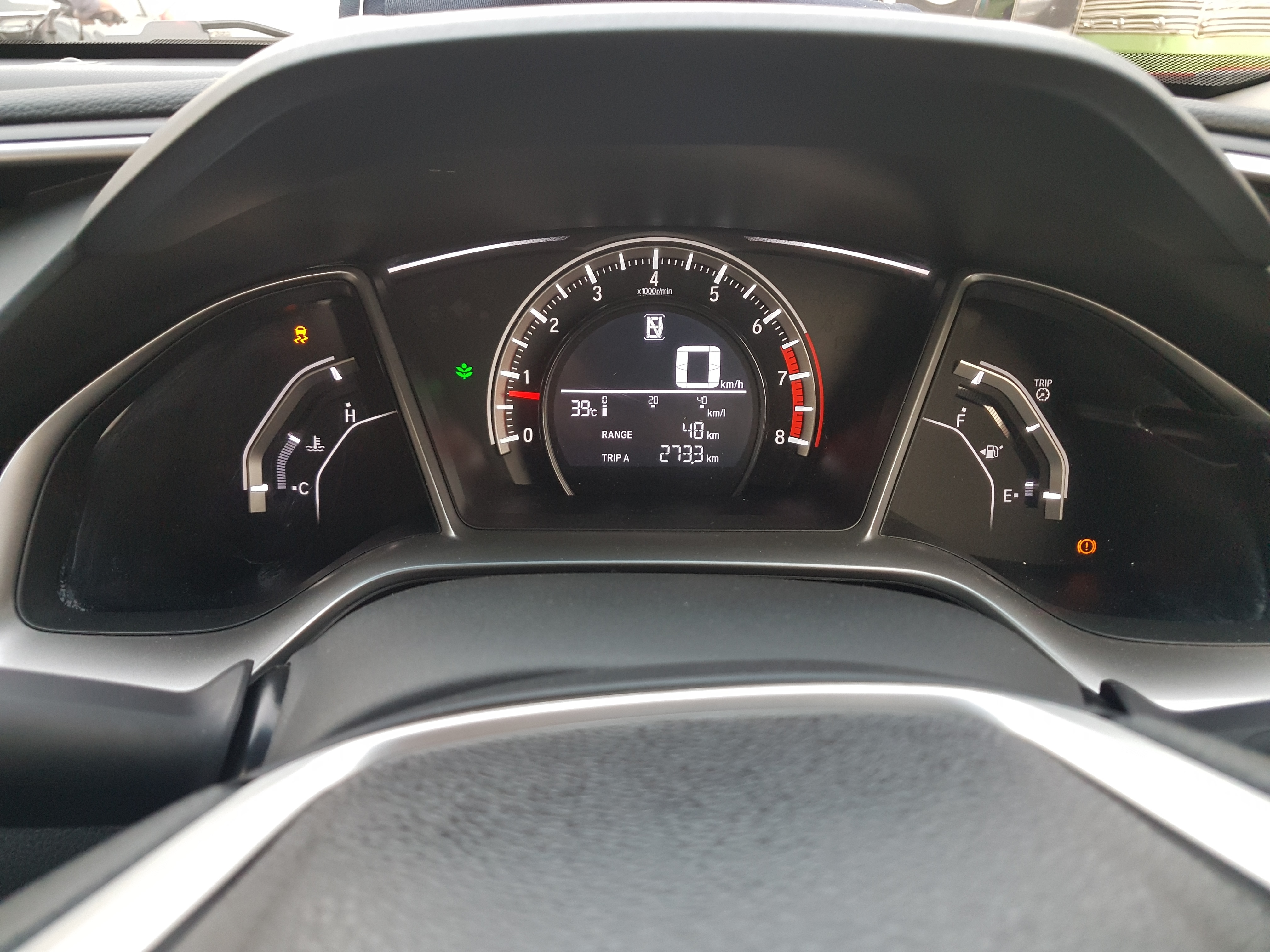

well....found some useful article on battery drains...it's likely the case of Civic X i.e keyless entry..it might be the culprit...
