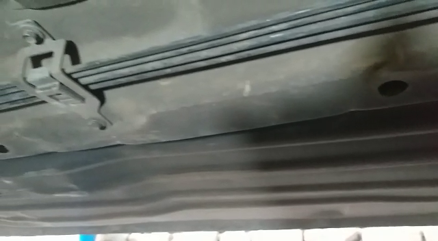

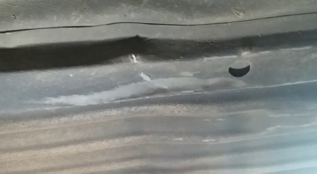

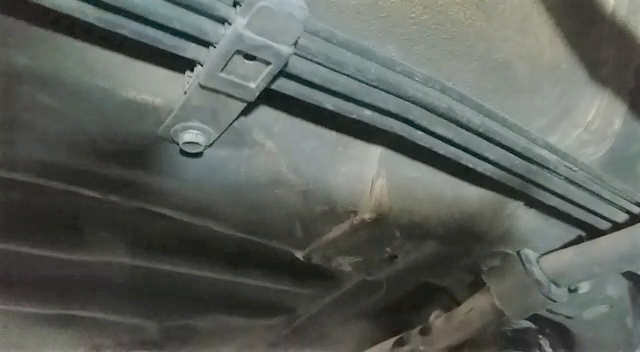

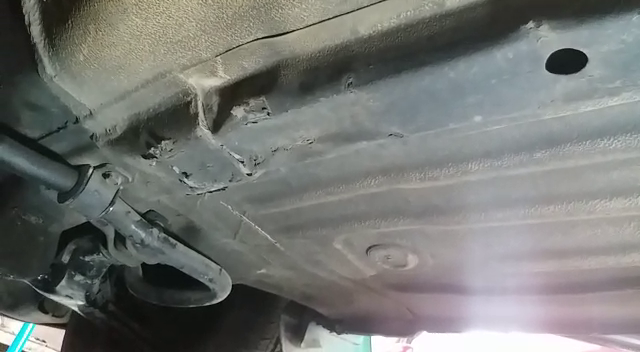

So we started doing out of the box thinking and a detailed inspection of the car's frame revealed a damaged section. This section had been dented and had moved about 1.5 inches from its original position causing a misalignment in the rack which makes it impossible for the steering to return by itself.
We are now attempting to correct this dent and bring the frame piece back to its original position.
So far this has been a very costly and patience taxing endeavor. I will update this post again after the dent has been removed and further testing.
Right Damaged Side
Left Undamaged Side
