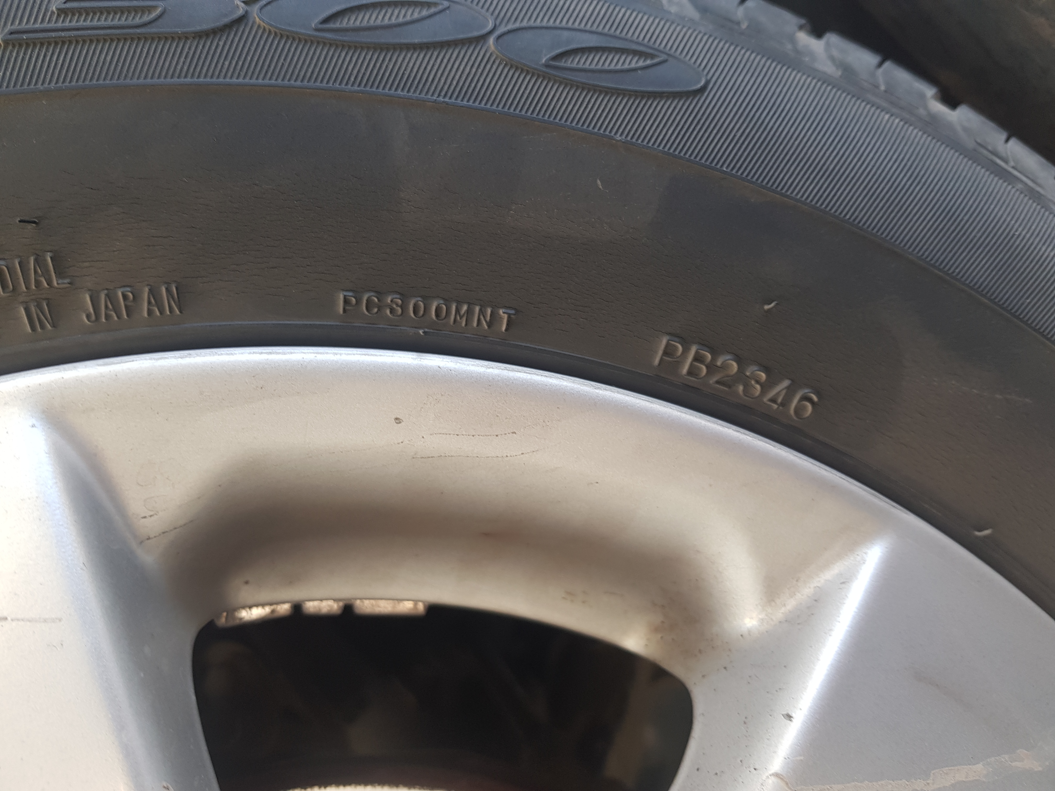

Couldn't find the manufacturing date on tyre on dunlop sp sport 300 checked all four tyres, is it possible???? Attaching images if someone can identify it would be great help !
if i remember correctly eurostars don't have manufacturing date either
I think, in the following pic:
PB2346 has got to do something with the manufacturing week and year of tyre.
Year; I am unable to find out, but week? It seems tyre was manufactured in the 23rd week of that particular year.
Eurostar do have manufacture date
It could be on the other side of the tyre, inner one, that is.
Check it on the inside as well. Tire walay are most of the times stupid to put the wrong tire side on the inside even when most tires now have mentioned in/out side
Yeah it was inside date was 32nd week of 2014 manufacturing year, i think should get it changed by now
Yes sidewall has also started cracking. Best option would be to replace
Yup small cracks on them
