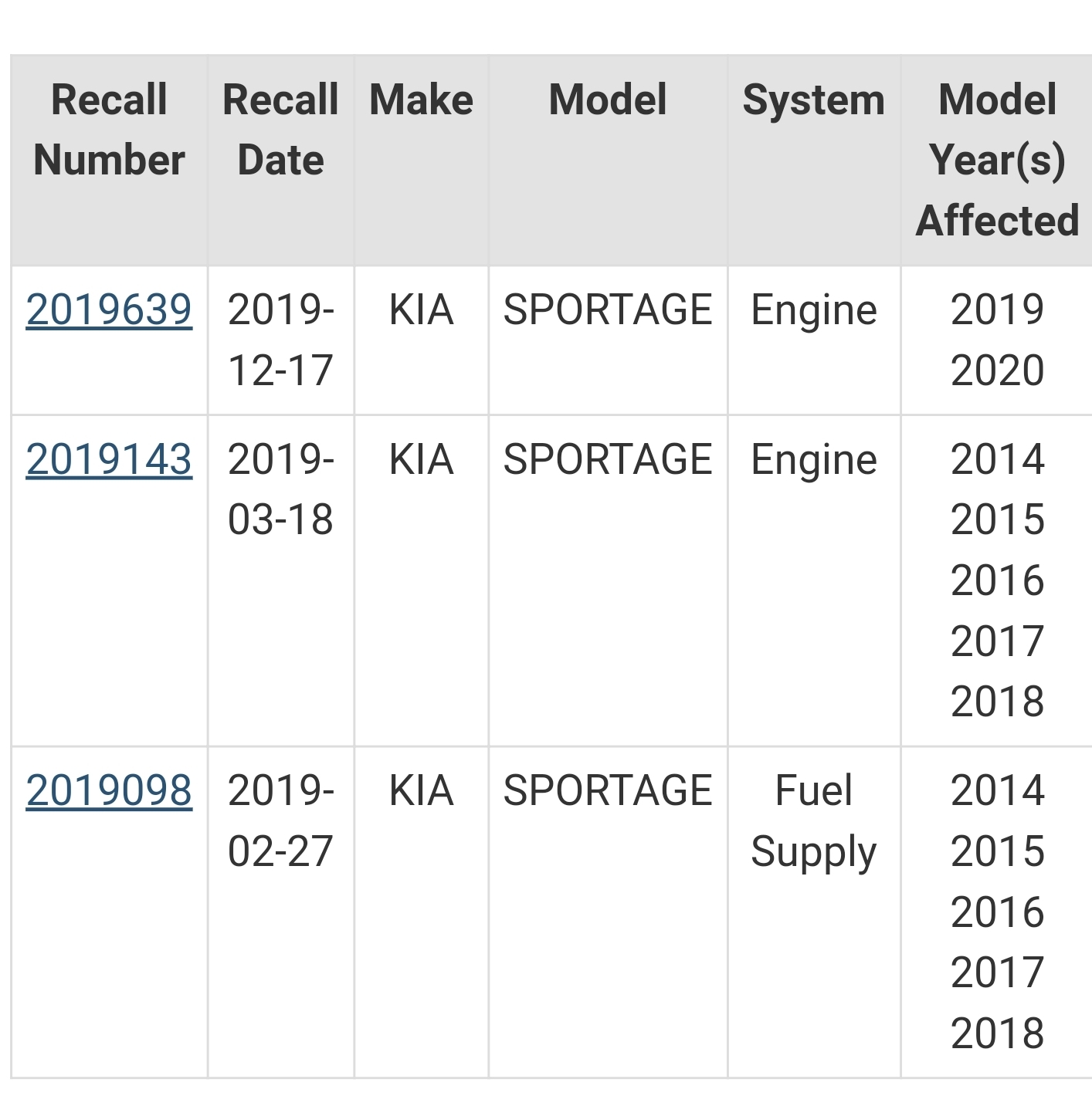

Engine oil was checked through the dip stick BUT was the engine oil drained and checked for any solids? And in this case any metal shavings ? Was the engine head removed and inspected ? Was the engine de-mounted from the vehicle and inspected for any damage to engine block ? Checking the oil level via dip stick does not tell all the story. Was the head gasket inspected ? If not then how come we can say that everything is fine with an engine?
Were fuel rails inspected as well as fuel feed lines ? Because there is a very recent recall in North America from KIA / Hyundai for the low quality material used in manufacturing the fuel lines which can crack at certain vehicle operating conditions and can cause fire.

As a backup info, Hyundai/Kia reached a 760 Million dollars settlement in United States after a US government agency NHTSA completed its investigation into engine fires of Kia/ Hyundai vehicles in United States. There were over 3100 engine fires and 103 reported injuries and in all these cases , the fire started in engine bay without the vehicle being in any accident/ crash itself.
Beside United States, prosecutors from South Korea also raided Hyundai and Kia offices in South Korea in 2019 as part of probe into allegations raised by Civic groups and transport ministry of Korea that Hyundai and Kia attempted to conceal defects in some of their models.
Well, an engine fire issue in North America does not neccesarily means that we might have same issue in Pakistan but during any investigation of this particular matter, we should keep in mind the fire errupting in Kia and Hyundai vehicles in United States and affecting almost 5 million +/- units. Like all car assemblers in Pakistan , Kia also import engines and we should keep that into consideration.
