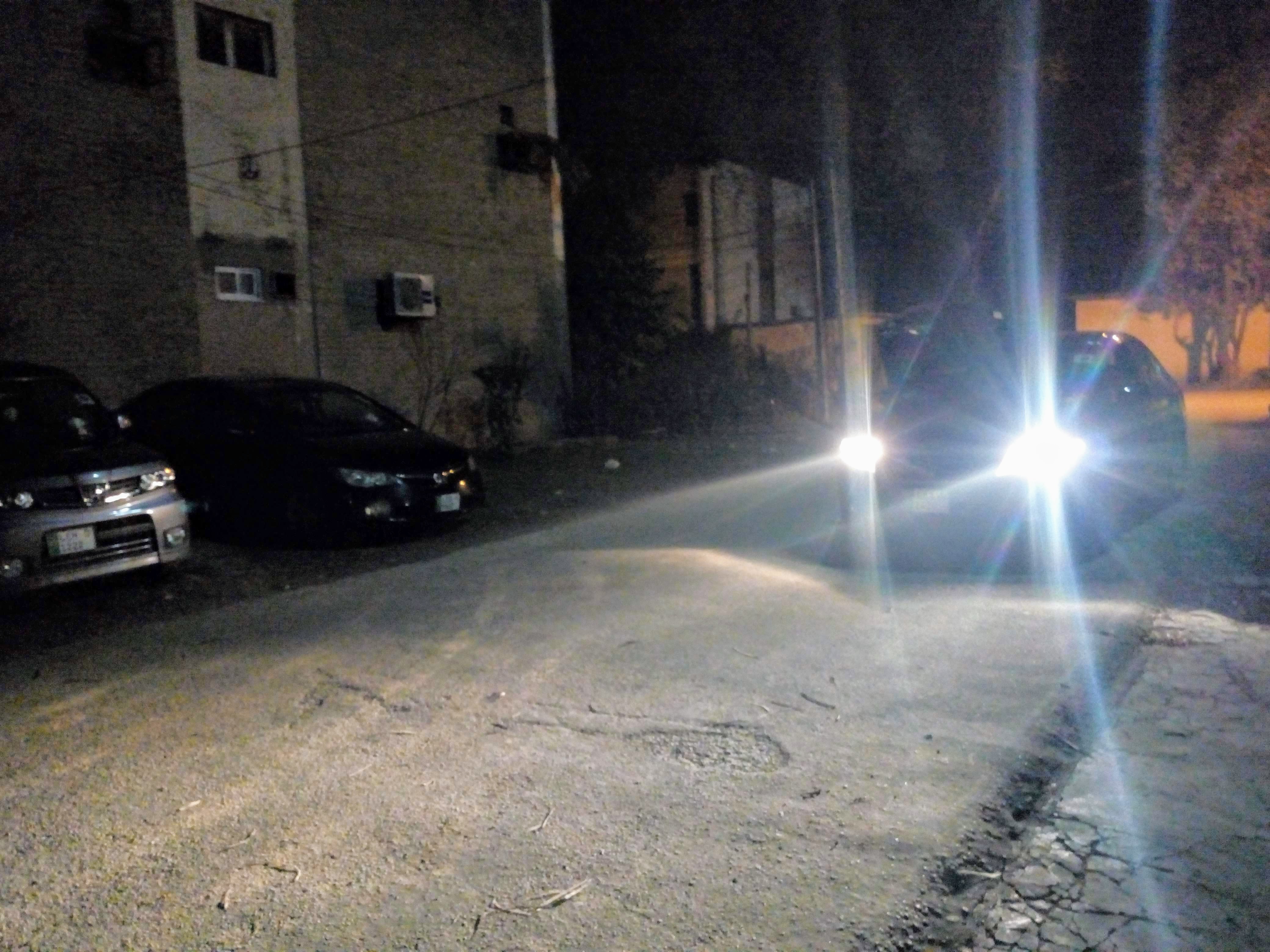

For comparison stock bulb on one side.

Stock on one side Philips on the other.

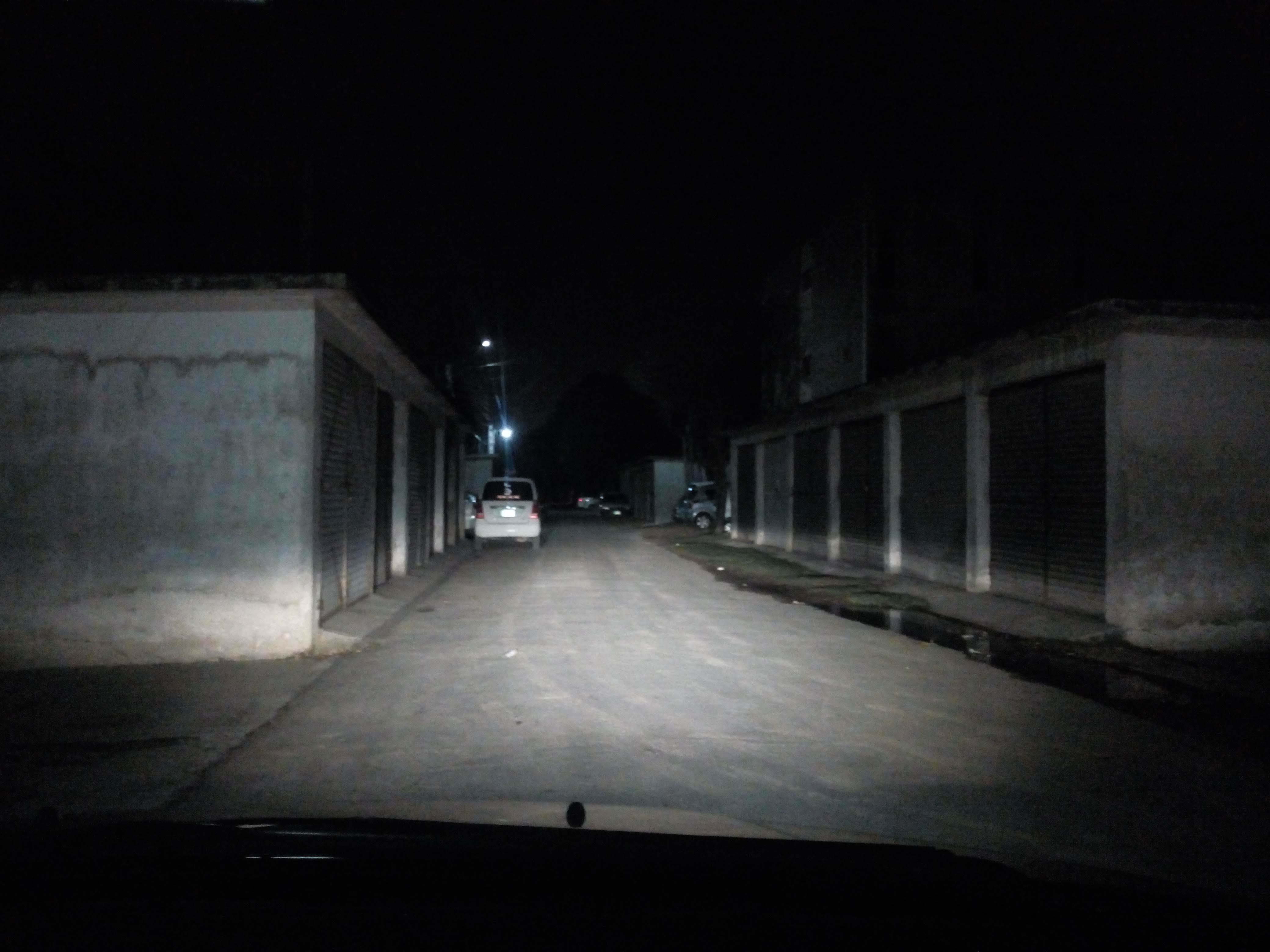

Low beam.
Cut off &
Light projection on road.
