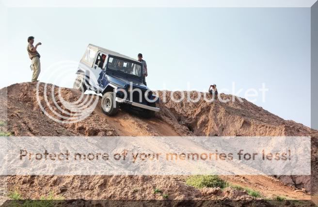

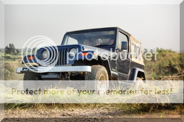

Re-introducing the original Jeep Baltoro: A Pakistan Army scrap auction 1979 CJ7 restoration with redesigned and hand crafted full body re-build:
With a Toyota 2L-TE Motor and a mechanical injector pump running a Toyota transmission and transfer case.

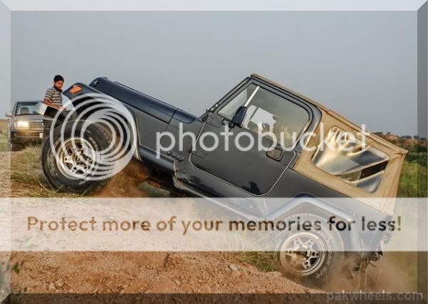

Stock CJ suspension with Monroe shock absorbers and 31' tires on 8' rims with 3.5' offset, Stock narrow track CJ7 differentials.

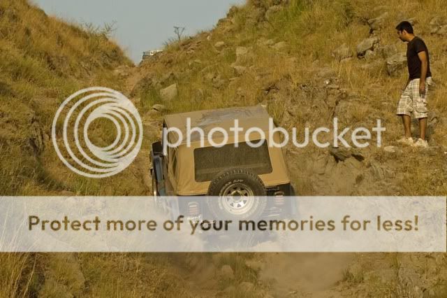

The soft-top is electronically controlled and conveniently rolls back after removing velcro side panels
The rig was completed 5 years ago and all work was done by local mechanics and denters. Since then its been used as a DD and is surviving weekend off-road treks with the Islamabad Jeep Club (Islamabad Jeep Club - Home)
Many thanks to NN, Aiman and Ehsan for the pics, Jameel Ustad and Babar for the body work, Tufail Ustad and Farooq for the mechanicals and Ehsan Kiani for making it all possible.
