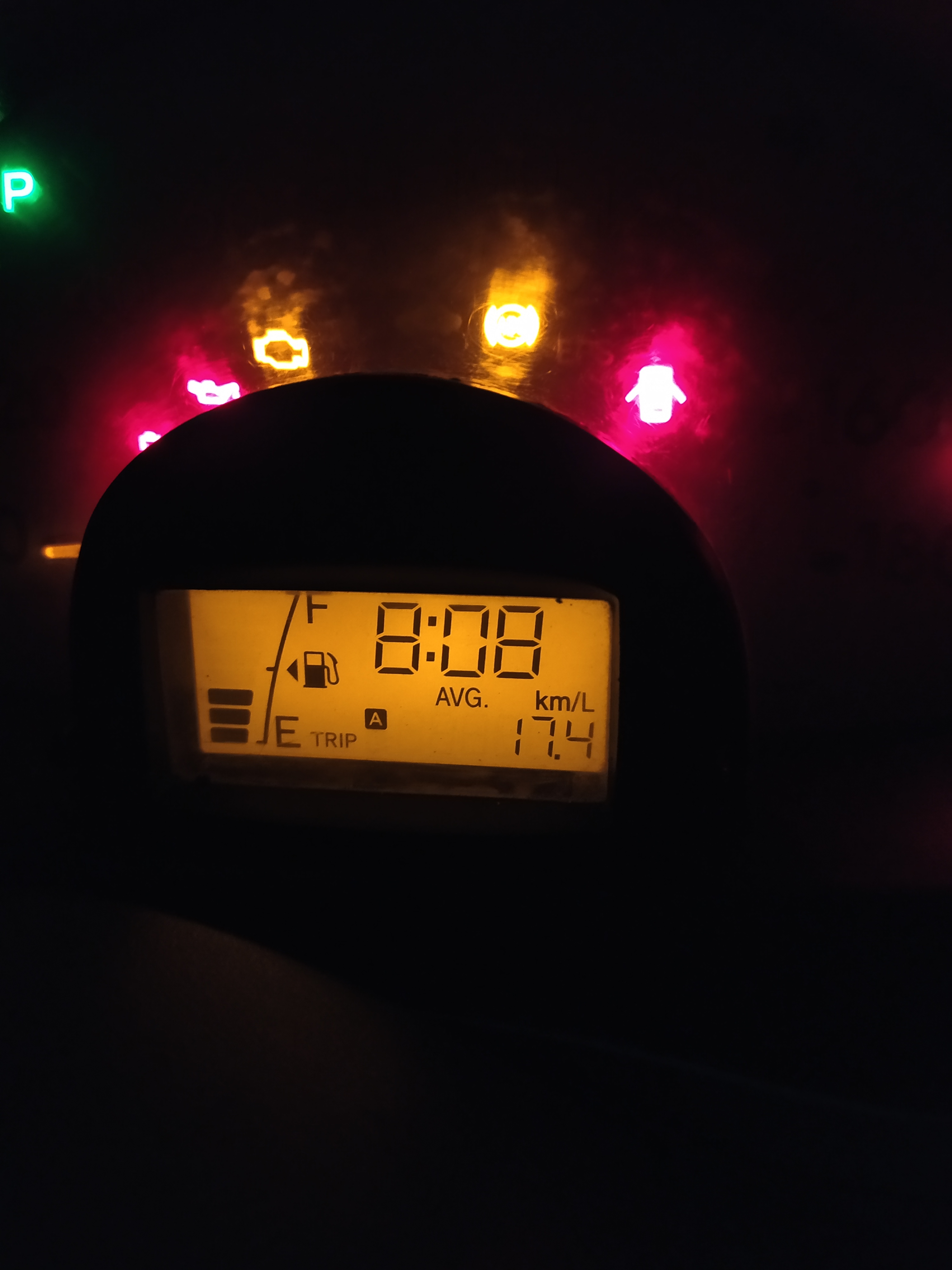

Motorway Hyderabad to Karachi with ac on all the way. After shifting to 0w20 Total fully synthetic.
what is the odo reading? which oil u were using before
Car is currently at 147k kms. Previous owner was using 10w40. I first shifted to 5w30, after seeing no oil level drops in last 5k kms finally shifted to 0w20. Loving the drive so far.
what are the gains over 5w30?could you guide us so that we may make an informed decision
Cold start is better. Engine reaches optimum temperature quicker. Fuel economy in city has improved by 1-1.5 kmpl, and on highways by 2-3 kmpl. 0w20 is the most recommended oil for 1kr engine anyway. But if you are coming from a thicker oil do look out for oil reduction.

Hyd to Pano Aqil via NH5. 360 kms, traffic denser than usual with multiple traffic jams. Ac was on all the time.Odo reading; 148k kmsOil; Total 0w20 fully synthetic
any unusual symptoms with 0w20?
Nope. No oil reduction, car has run 1200 kms on this oil already.
