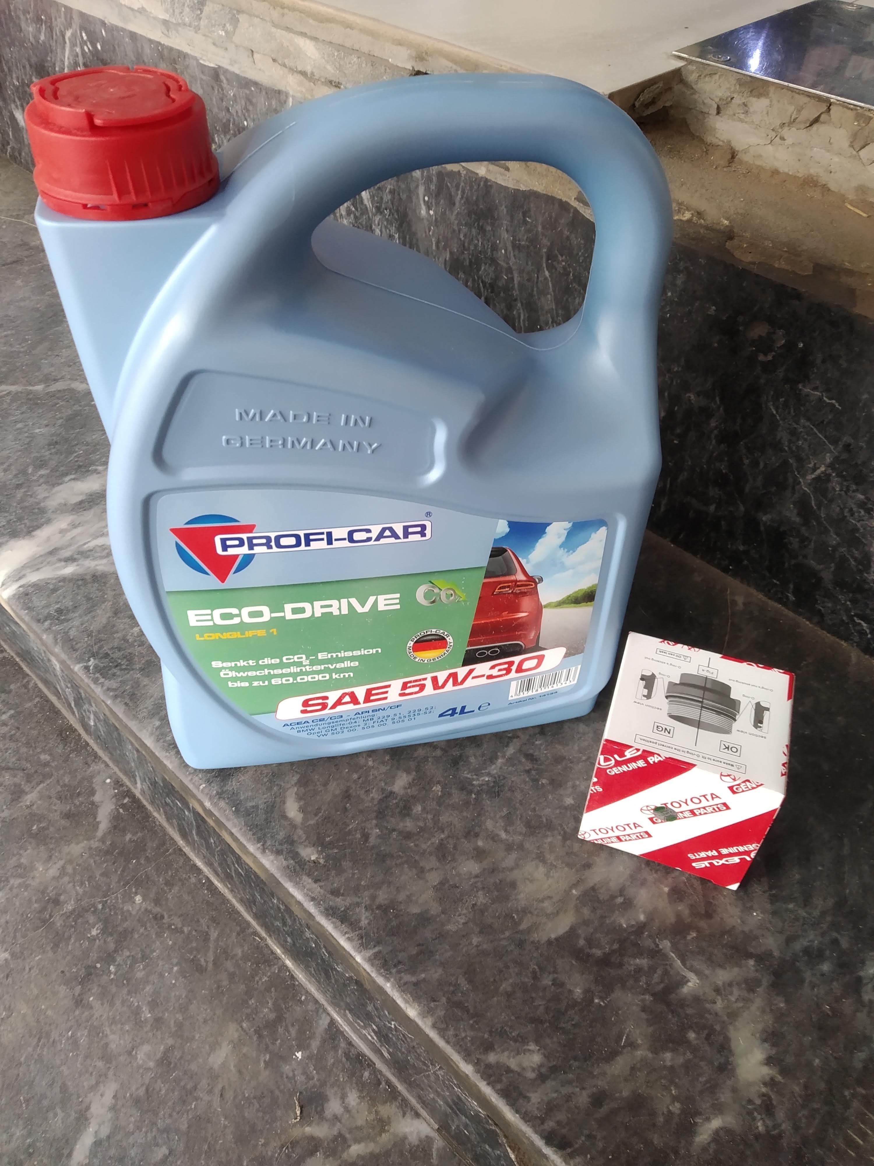

Switched to proficar 5w30 from kixx and fuel average has increased and engine noise slightly reduced. Easily getting 20kmpl in Lahore traffic now. I guess it's a very good oil (german) and extremely cost efficient. 3800 for 4 litre pack (paid 2850 for 3 litre).
Proficar kixx made in Germany.....
KIXX isn't it Korean

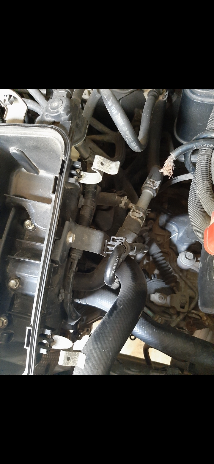

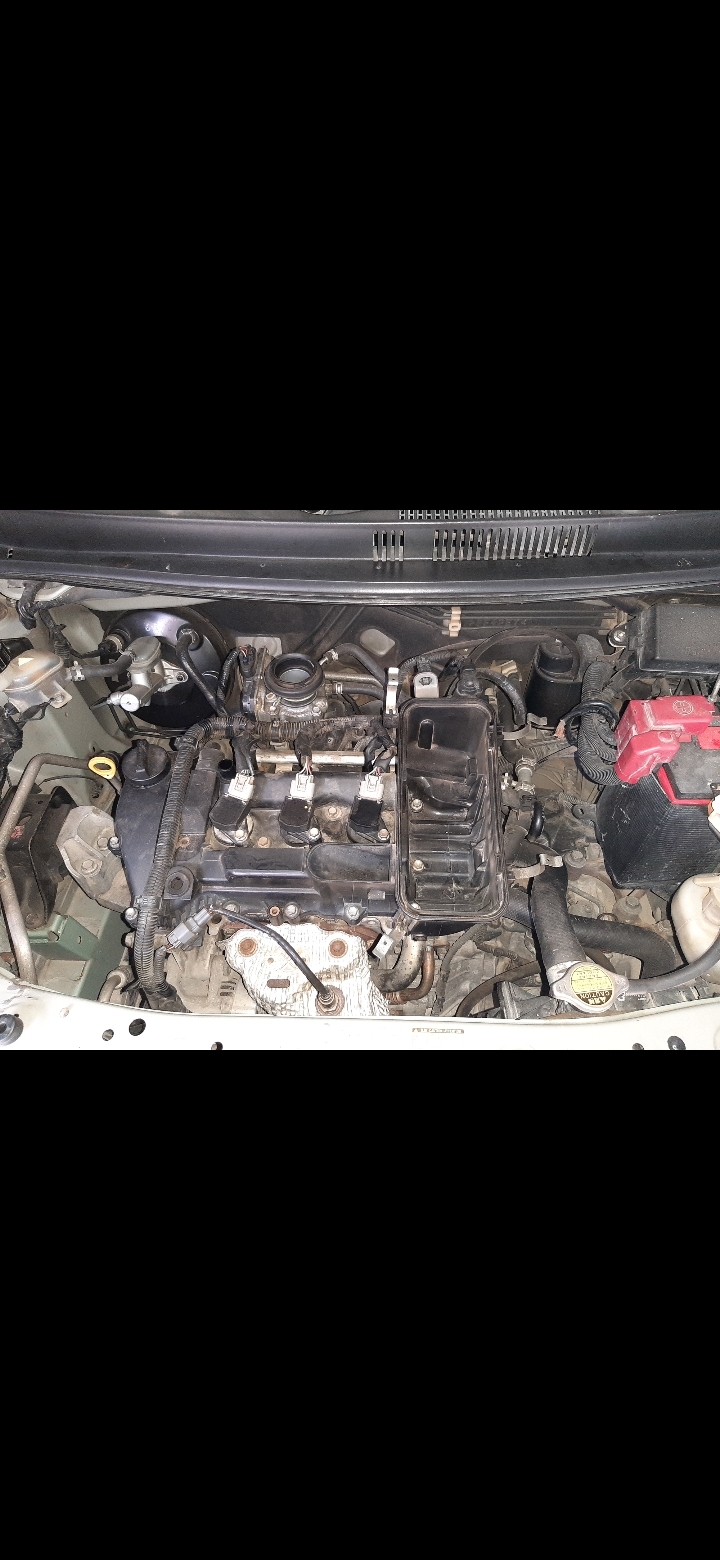

I want to know which one is the PCV valve? Here are some pics. Please mention in pic. Thank you so much.
I have found another post on PW with same issue and found the location of valve. Thank you.
PS: I should have searched on other forums, first. Sorry
