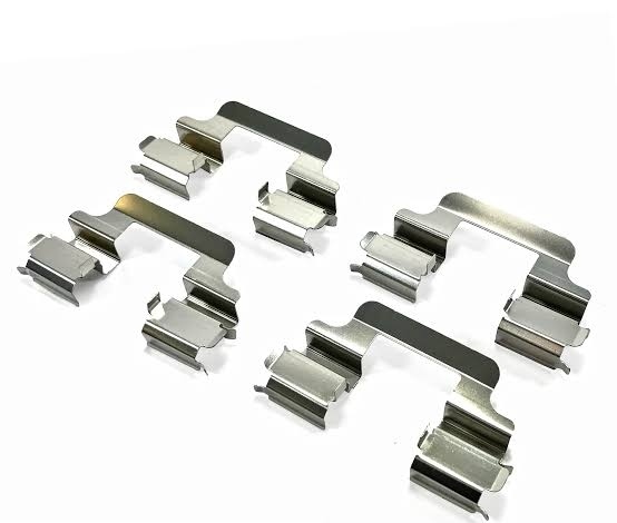

When you had you brakes serviced your 3s guy didn't put in the brake pad locks some things like in the attached pic. Hence the pads shake a little,
Plus the water / condensation on the disks makes your brakes squeeky...
