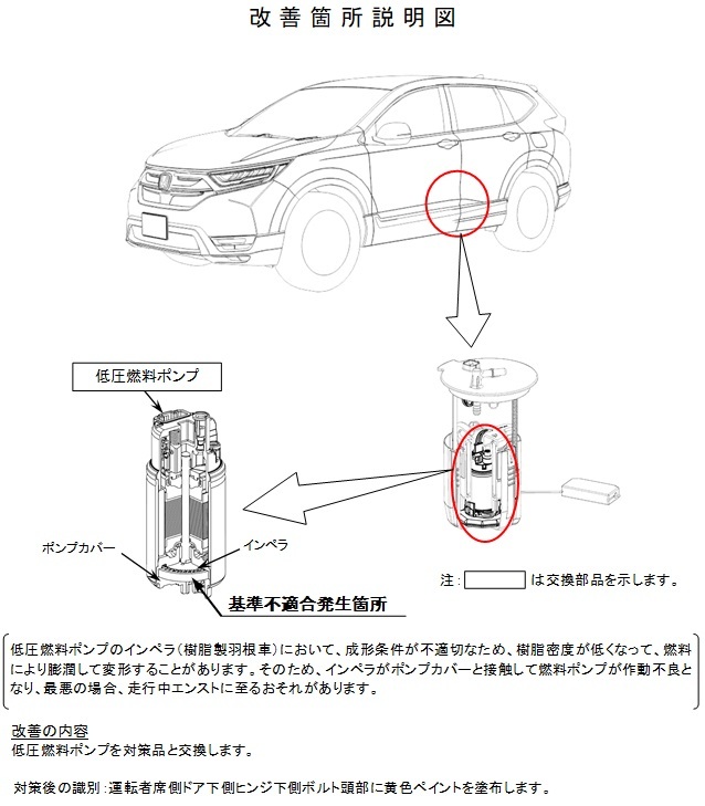

The fuel pump issue affects vehicles manufactured between 2018 to 2020 and depending upon the regions, it affects various models of Honda and its sub brand Acura inducing the NXS . This list also includes Civic, Accords, HRVâs, CRV, Insight.
The issue is with the low pressure fuel pump which is installed in the fuel tank and normally known as â LPFP â . The fuel pump has an impeller which is faulty and can cause loss of power and this results in the fuel pump stop working eventually not feeding the fuel line and vehicle can stop without any notice.
According to official Global Honda statement
" The impellers were exposed to production solvent drying for longer periods of time, potentially resulting in surface cracking. In the impeller (resin impeller) of the low-pressure fuel pump, the molding conditions are inadequate, so the resin density becomes low and the resin may swell and deform. As a result, the impeller comes into contact with the pump cover, causing the fuel pump to malfunction, and in the worst case, the engine may stall during driving"
