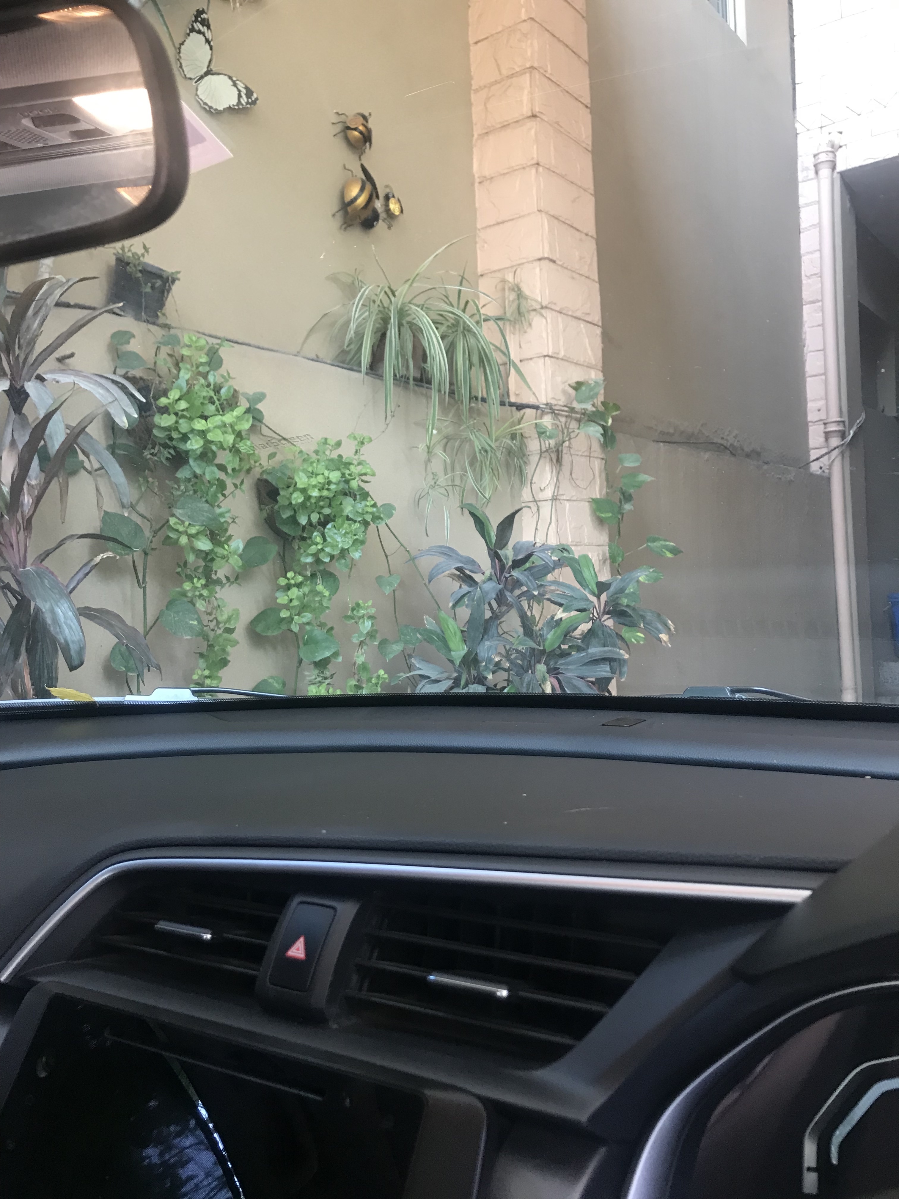

So Iāve been using Solarscreen tints on my civic for around 2 months
Hereās my review

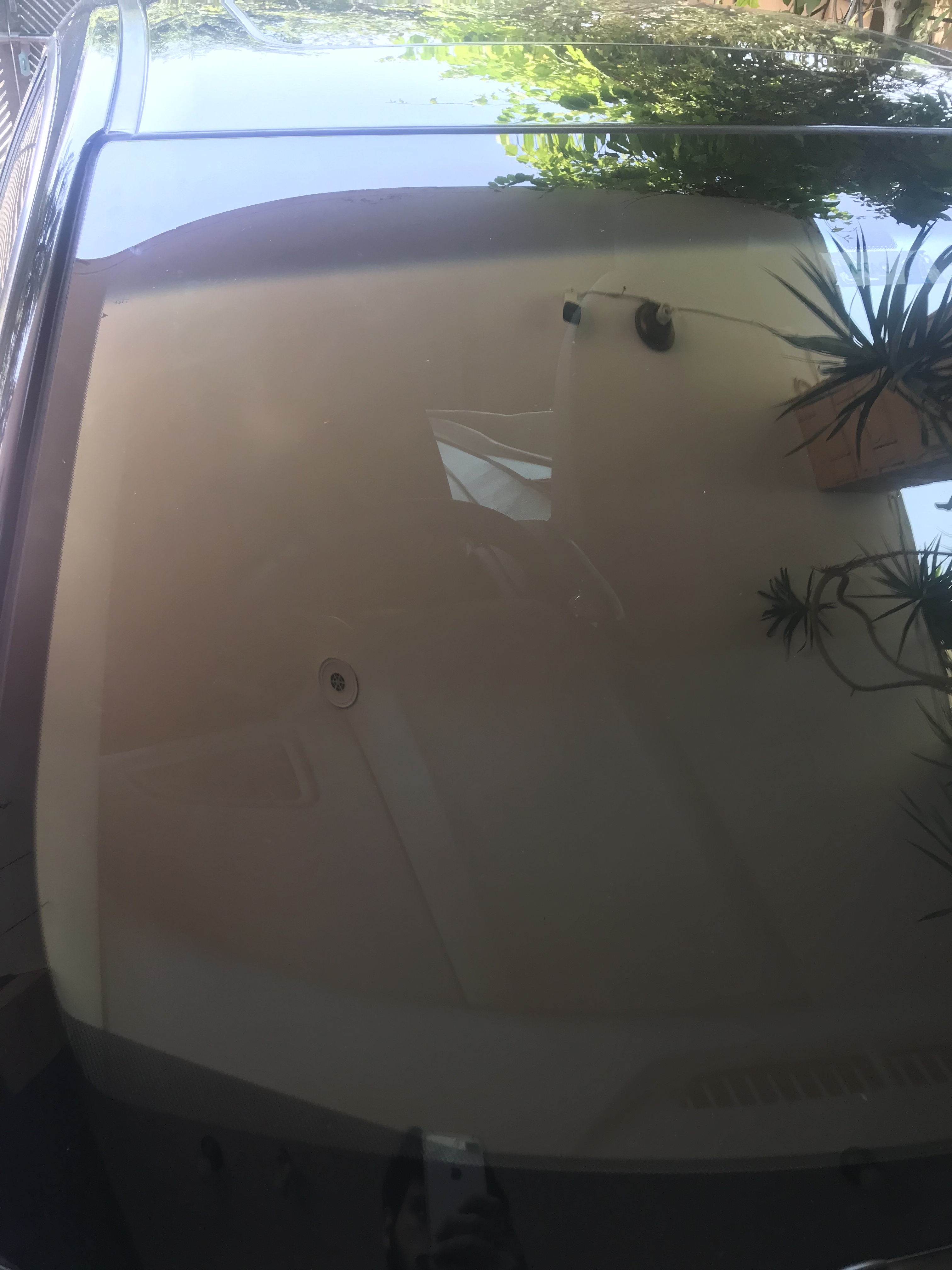

The windsheld glass with heat rejection films gets warmer compared to untreated glass as itās reflecting heat, not letting it enter the cabin.
So cabin remains cooler
