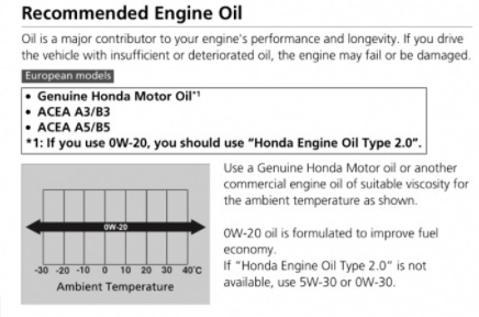

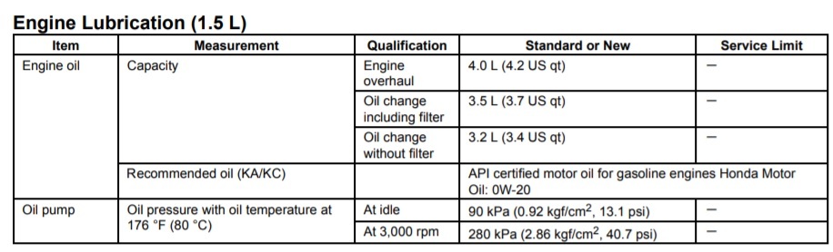

How much engine oil do we need to pour into civic turbo ?
3.7 litres exact 0w-20 oil(any good oil but Honda's own oil is also very good). And BTW, what fuel average are you getting from your turbo in city and @120kph?
3.5 liters (with filter)3.2 liters (without filter)
above numbers are taken from the workshop manual of Honda CIVIC X
further more,it says use 0w-20and if its not available then you can use other options.
My bad I just got my oil changed and he poured in 3.7 litres with filter

yes its my bad, in US it used to be 3.7 QUARTS which equates to 3.5 litres(I have not owned a turbo here.)
you should get the excess removed. Overfilling oil is bad for the engine. Is it showing correct level on oil dipstick or over max level?

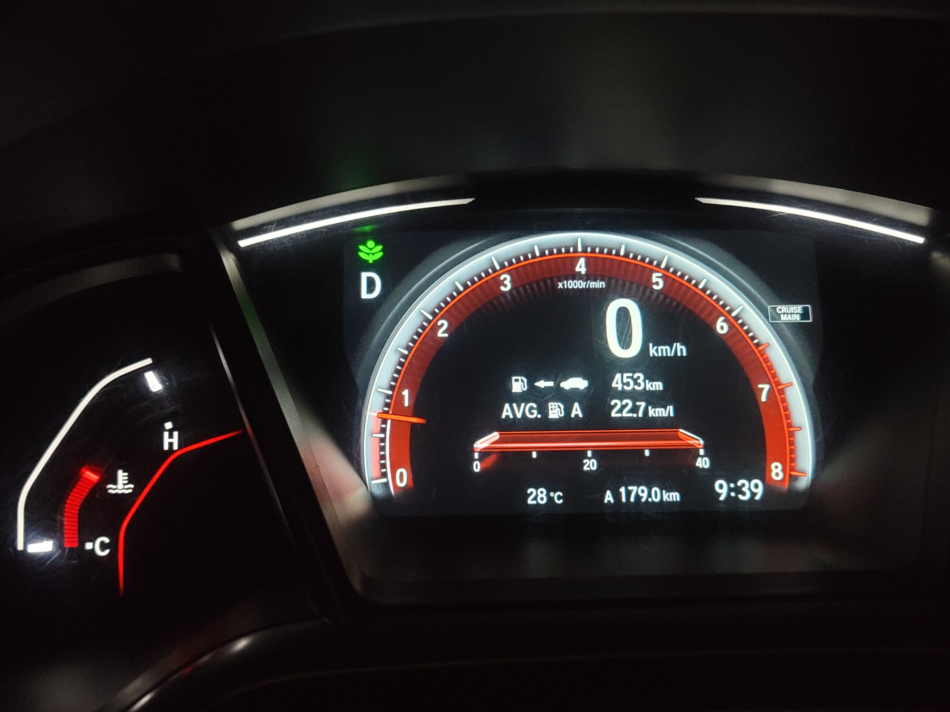

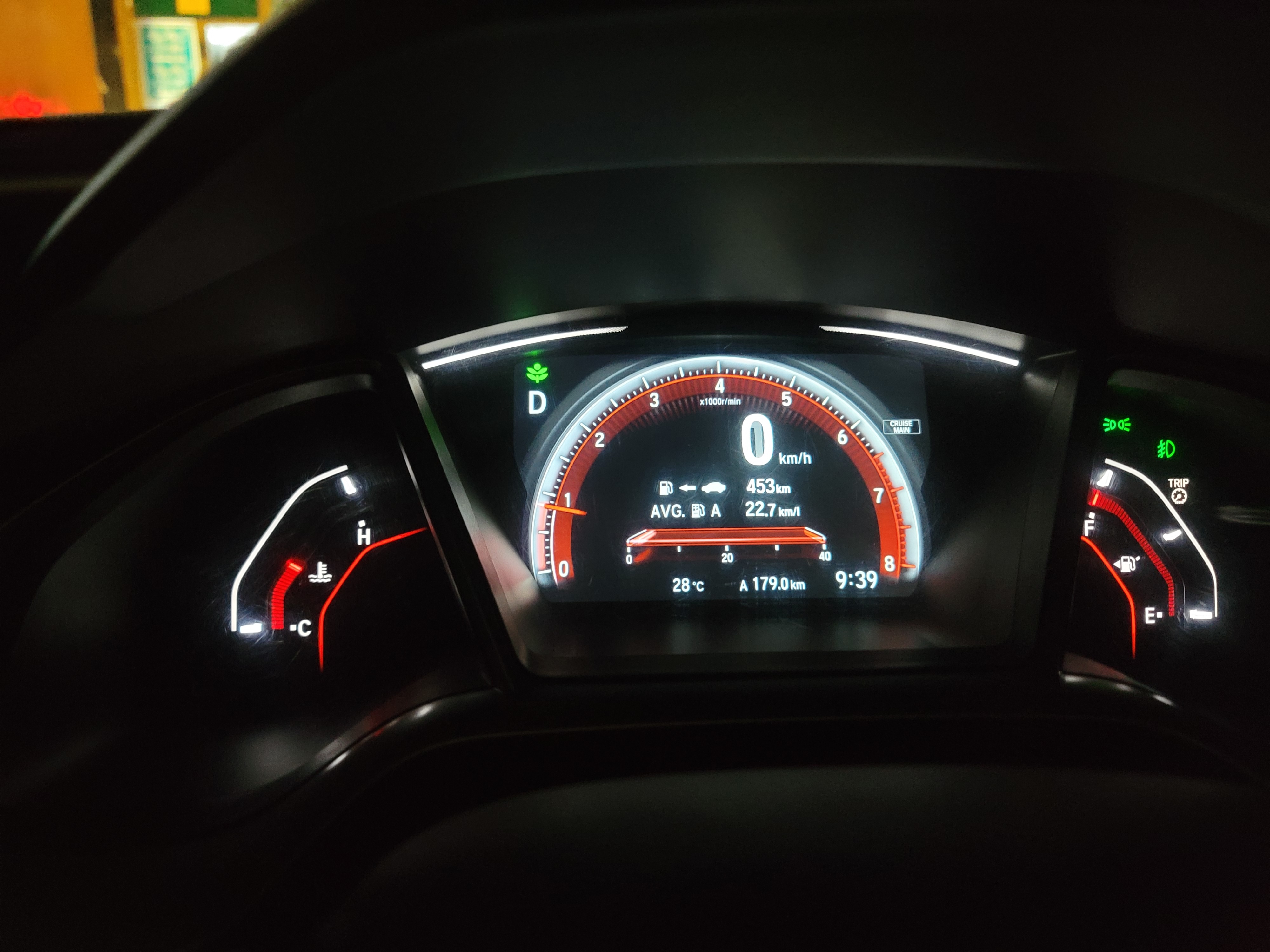

My average on motorway Picture was taken while waiting on toll plaza queue.
That's pretty impressive mileage.
At what speed and how much distance was covered?
I haven't been able to exceed 17.5 kmpl at 120kmph
