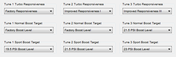

Once you've setup your tune levels and flashed the vehicle on the fly map switching between the tunes is easy!
