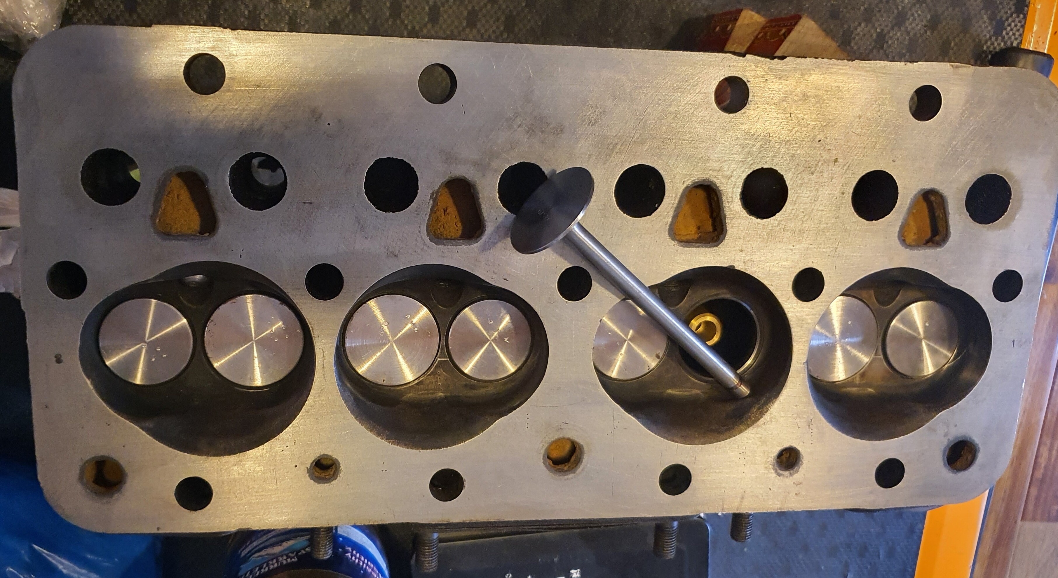

Next step will be to proceed with refitting the head.
