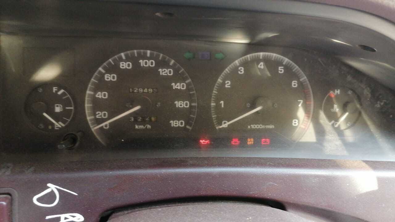

I have 1988 corolla in manual transmission. When i starts my car before starting i saw on speedo meter that the meter shows od off light in yellow colour. And i searched the whole car,but did,nt found the od off button. Kindly lead me that how should i find the button and where. Location of button Od off
Maybe this meter belongs to Auto variant of same model
it appears that the cluster is from some diesel auto transmission variant vehicle. i can see glow plug sign well
Red zone at 6200 rpm, definitely petrol. That is probably something else
does your vehicle have a puller choke. If the cluster is swapped that choke cable movement cause amber warning lamp to lit up momentarily.
