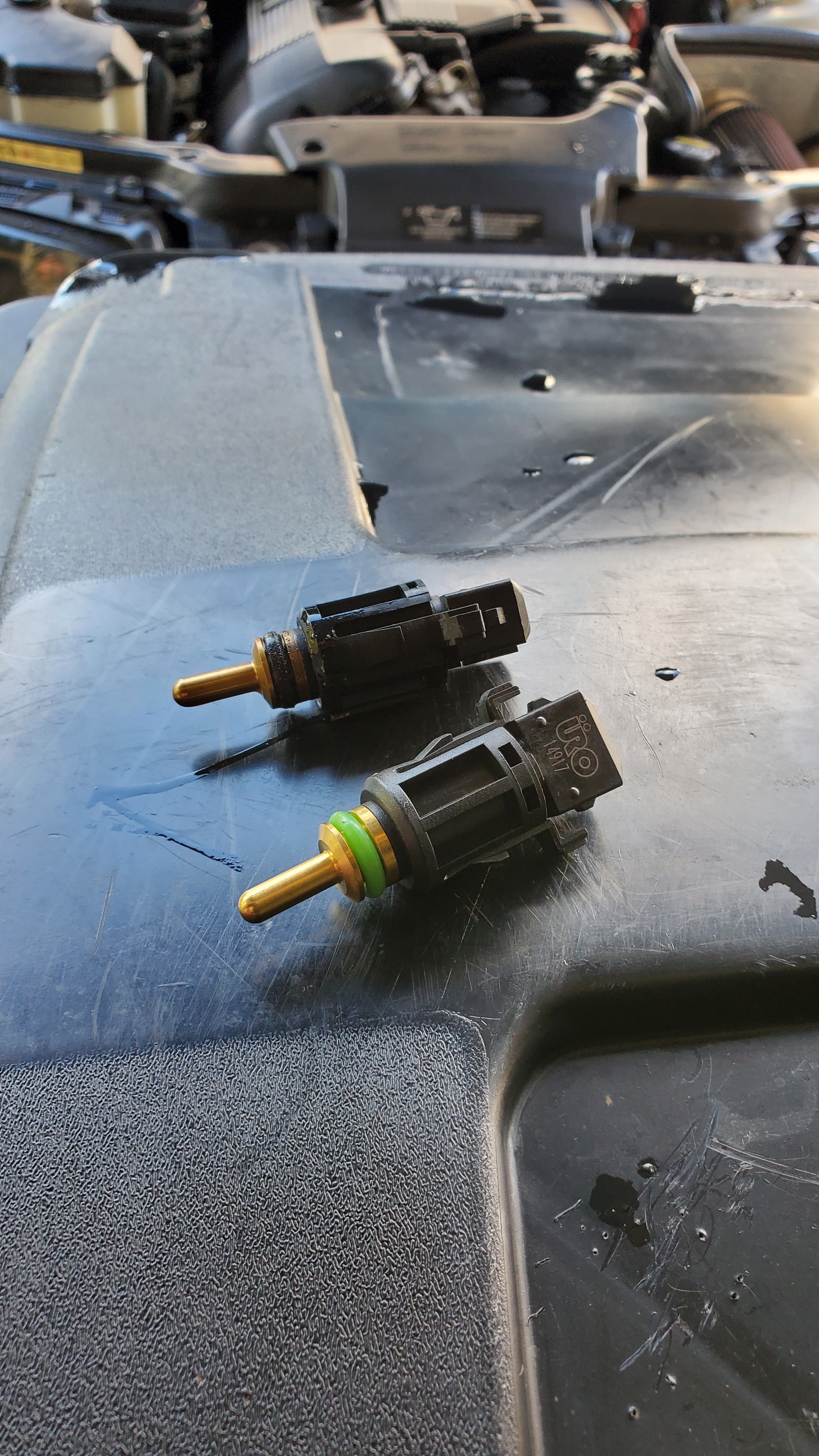

Diagnoses: turns out the temperature sensor may not be functioning right - radiator fan does not kick on with the temperature (it does turn on with A/C though) - so I'm hoping all my A/C related, transmission and heating issues may just be related to the temperature sensor - and now that I think back, I've had these symptoms for a while because I've mostly traveled on highways so did not need the fan very much anyway and whenever I was in traffic of stopped at a night, coolant temperature would get as high as 235 F.
So I'll replace the sensor today and report back on where things are.
