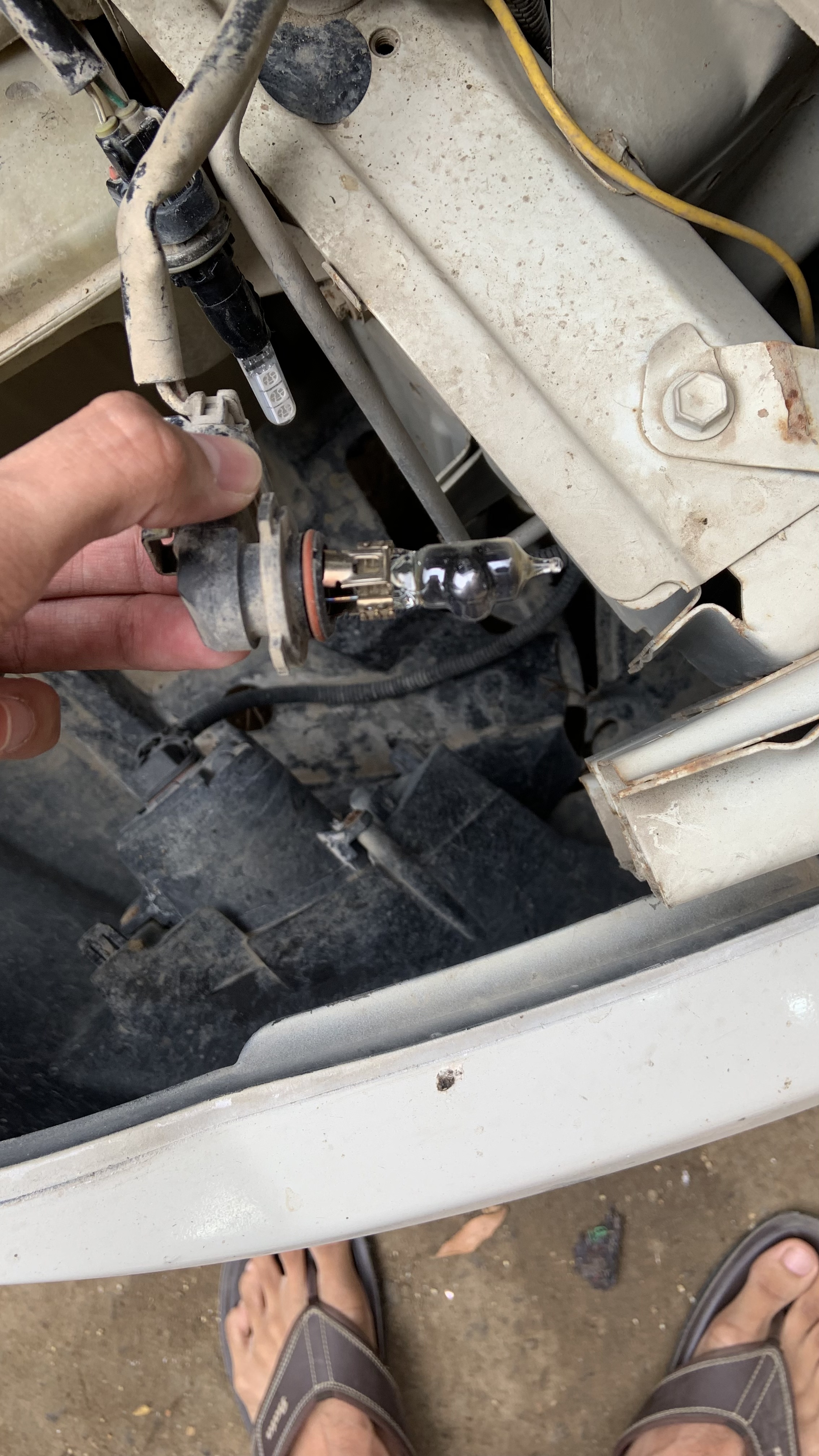

100w bulbs are a big no no. That's probably why you have that bubble. Lucky you didn't fry your electricals. Switch back to the factory bulbs

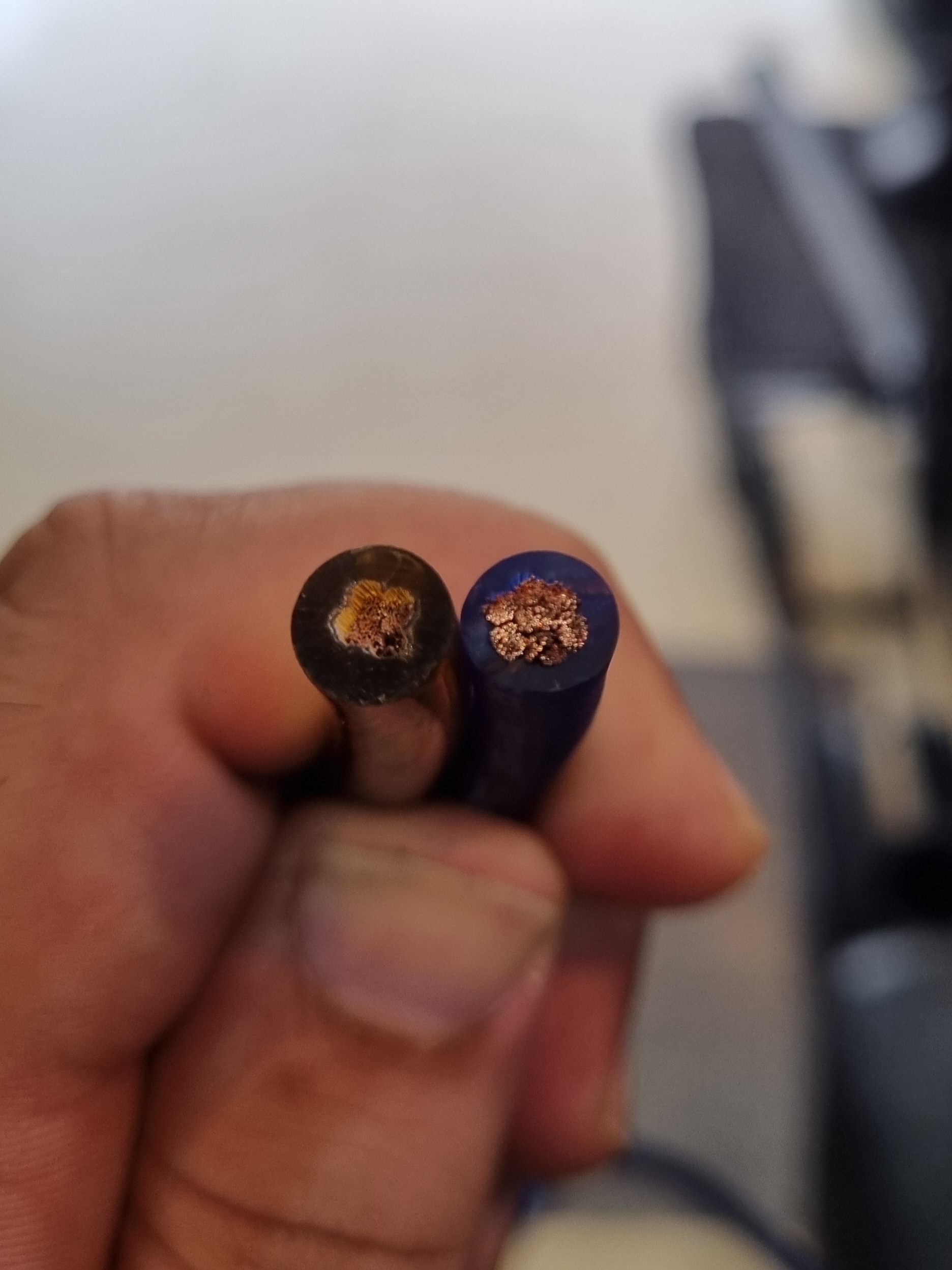

Regarding your electricals, your installer ran the same generic crappy 8 gauge pwr/gnd wire they all use. The way he's grounded that cable is probably by twisting it around the seat frame bolt with all the strands poking out. Wouldn't be a shock if he hasnt scrapped the paint off for a good ground. Push your seat all the way forward, take a pic of the amp he's installed under the seat. Also, a picture of the pwr wire he's run to the battery. I'm sure it's not fused either.
Btw, doing a voltage drop test is easy. You can YouTube some how to videos and check your grounds
