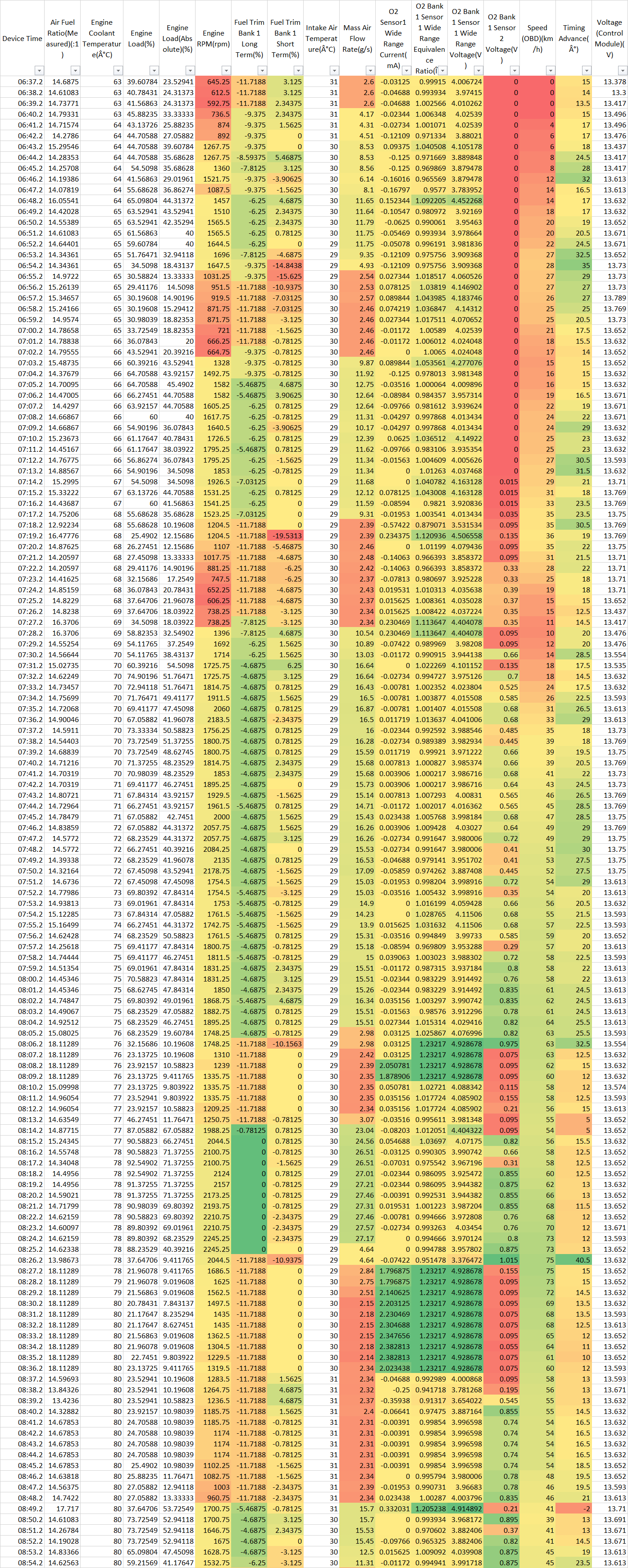

UPDATE: So yesterday i decided to unplug a few things in the engine bay to clean the electric plugs/connections with some contact cleaner.
- I cleaned the MAF sensor plug + the sensor itself
- Cleaner the injector connections and coil connections
- Cleaned the camshaft position sensor connection only (couldn't take out the sensor with my cheap brittle T wrench)
- Cleaned the oxygen sensor connection
- Cleaned the VVTI solenoid connection
Since the knocking / timing fluctuation issue was thought to be something relevant to the VVTI in our opinion, I thought of leaving the VVTI solenoid disconnected.
And then i drove the car, and still am driving even today. Well i only drove the car for several KMs since im at work again, i think the knocking is gone or atleast reduced.
What could this mean? Any ideas?
- Could it be an issue with the solenoid itself? (I checked the solenoid with direct connection the the battery few months ago and it operates that way)
- Could it be an issue with the electric current through the wire/plug that comes out of the wiring harness that gives power to the solenoid?
- or could it be a stuck VVTI Cam phaser?
Will appreciate any expert opinion. Yes Im trying again to fix this knocking and limp mode once again
