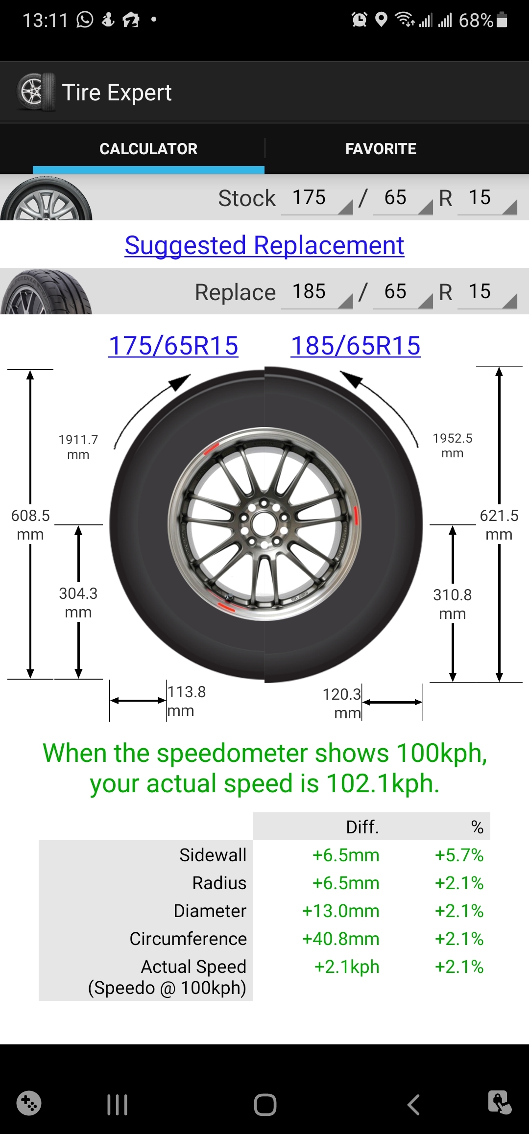

People bringing up international markets having same size products are forgetting that there is a big difference in the quality of local and international products. Local euros 175s are never gonna have the same grip as imported 175s. Local batteries never have the capacity or cca that the international same sized batteries have. So in my opinion it is better to have oversized stuff to compensate for the local quality. Like atlas could have used the bg trakko 185/60r15 like the yaris to at least improve the low grip issues of the city.
