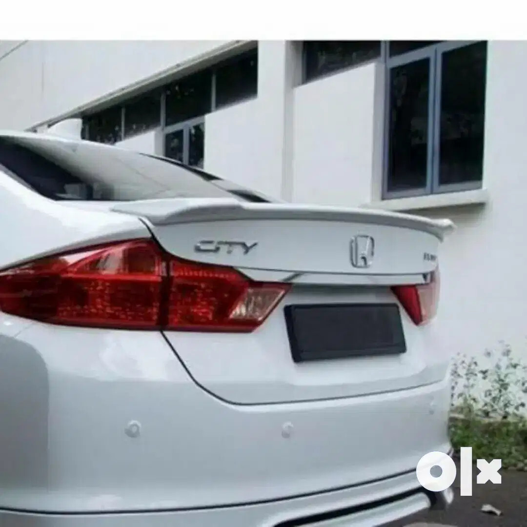

The second improvement you can do is use a lip spoiler. It will reduce both lift and drag at high speeds. This is how a lip spoiler look like

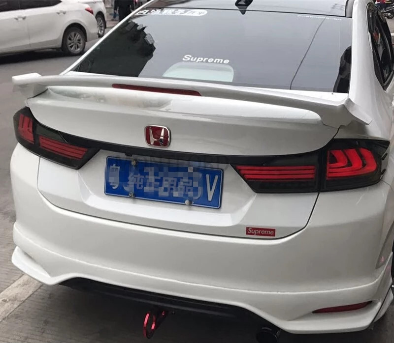

Don't use a wing. Wing on passenger vehicles is a big NO because of limited engine power. Wing is useful for performance cars or in motorsports application.
Just to clarify, this is a wing.
