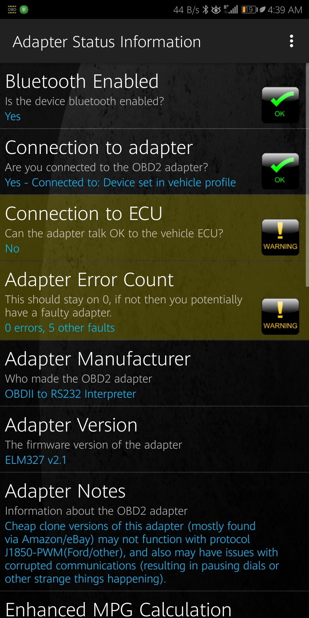

It should work. Have you tried it with any other app?
I will try tomorrow and reply... Thanks... Actually now my ECU is changed... Maybe it works...

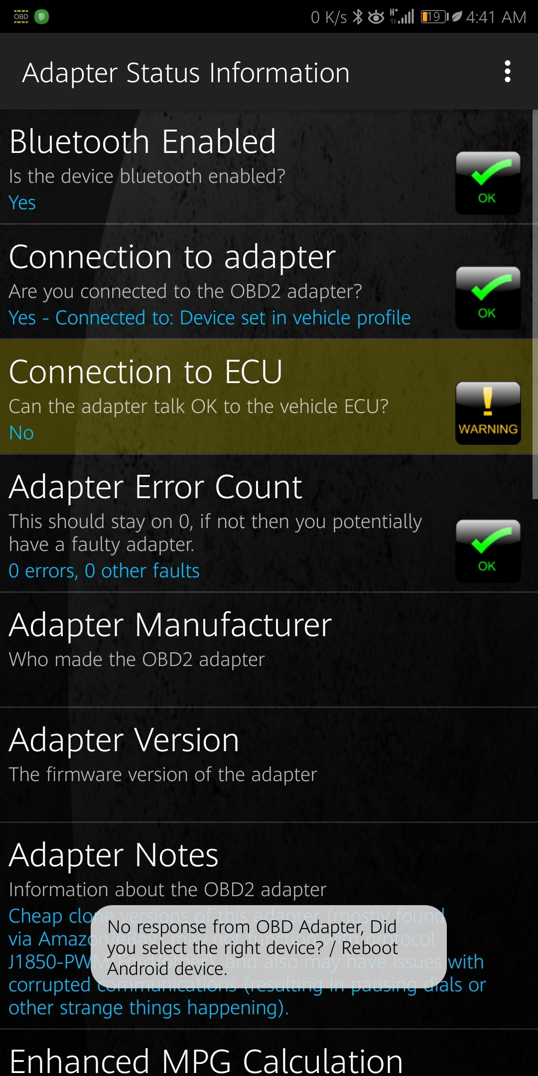

Maybe you have to add these strings in vehicle profile. In my corolla I have to add these:
Thank u soo much i will try... Is it 1nz? Ur corolla?
Which application is this... ? Torque? And can u post this string so i can copy...
My corolla and now 1nz swapped and still scanner is connecting without any issue
ATIB96\nATIIA13\nATSH8113F1\nATSP4\nATSW00
I am using Torque Pro
Thank u so much... Wait i go and try torque pro...
Tried the string but no luck... Bht hi koi sasta adapter hy shyd mery pas... Iska operation krn ga... Mainy 3 saal pehly mangwaya tha waisy... I am sad... Itni dair laga rha waisy...
Have you downloaded Torque Pro, not the Torque which is available free on playstore?
Download from here: https://dl.apkmos.com/download/dXBsb2Fkcy9Ub3JxdWUtUHJvLS0xXzhfMjA1LUFwa21vc19jb20uYXBr/h/ff9f2a70eaac4e5f7904a3e8999dd408/sh/d14be56707cc0333f36bb0df703fdec2
Yes, i downloaded torque pro...

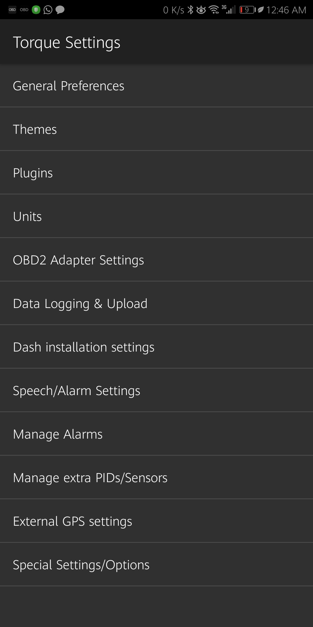

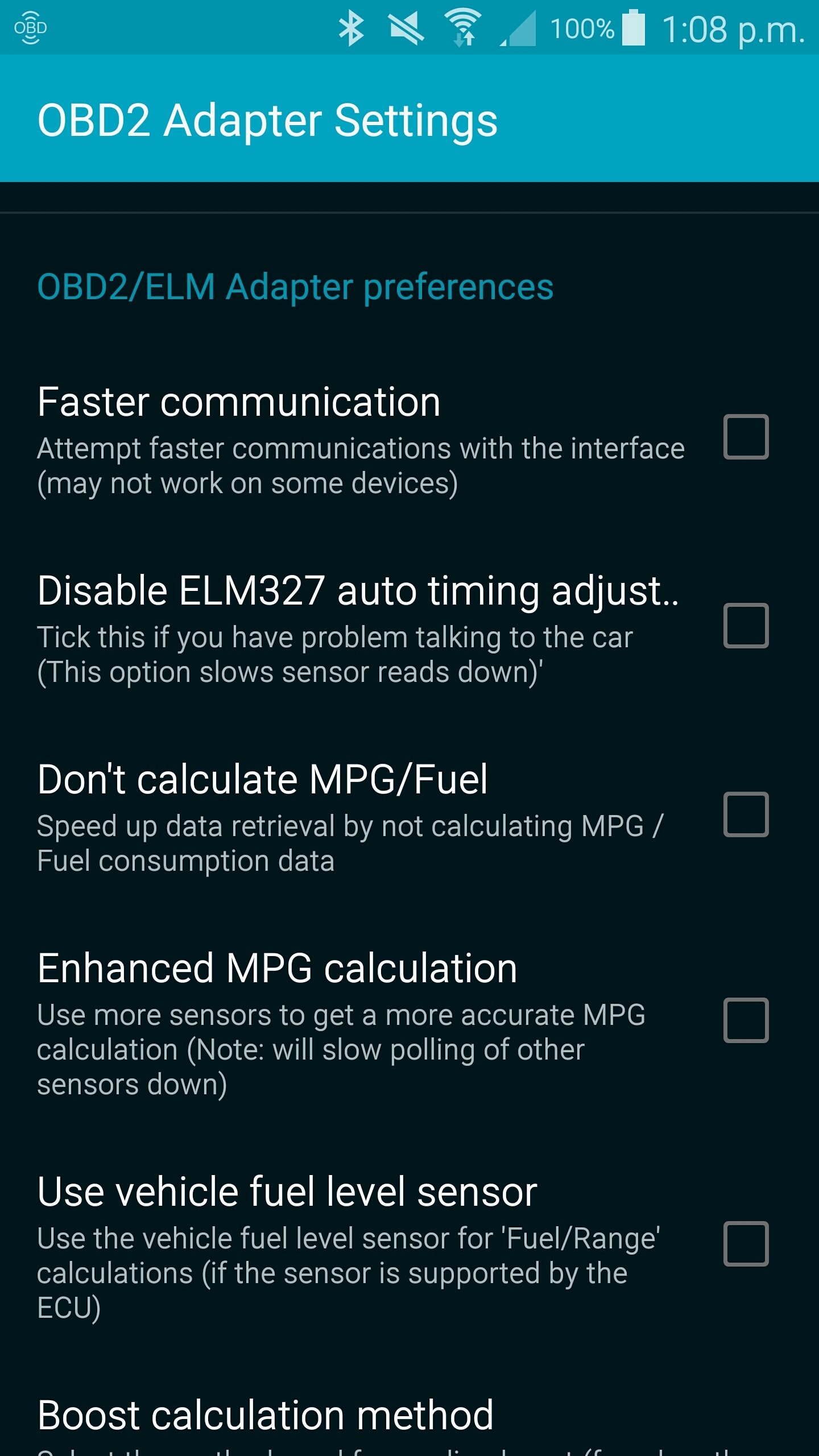

Mine does not look like this
Can u post image... Of exact same thing!

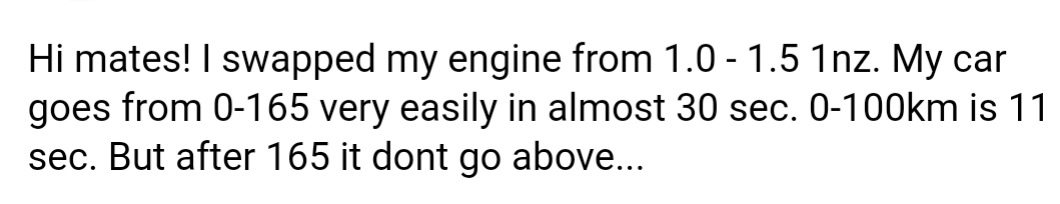

Bhai new problem b hy 🤭175 b krti hy but incline pr... My car is faster than grande i have checked but at high speed
Fuel pump can be a reason for this.
Mjy b blkl isi pr shak hy... Kai tuning waly k pas jata hn.. IA.
@Hassan1991 bhai pressure check kr k smj aa jaey gi na... Gauge sy yaa change hi kr loon 150k gari chal gai hy...!
