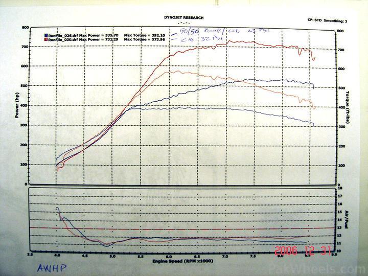

The big brake kit in front, and the dyno sheet
(2 runs - 1st run @ 25psi on 50/50 91 octane / C16 mix - 2nd run @ 32psi on straight C16)
