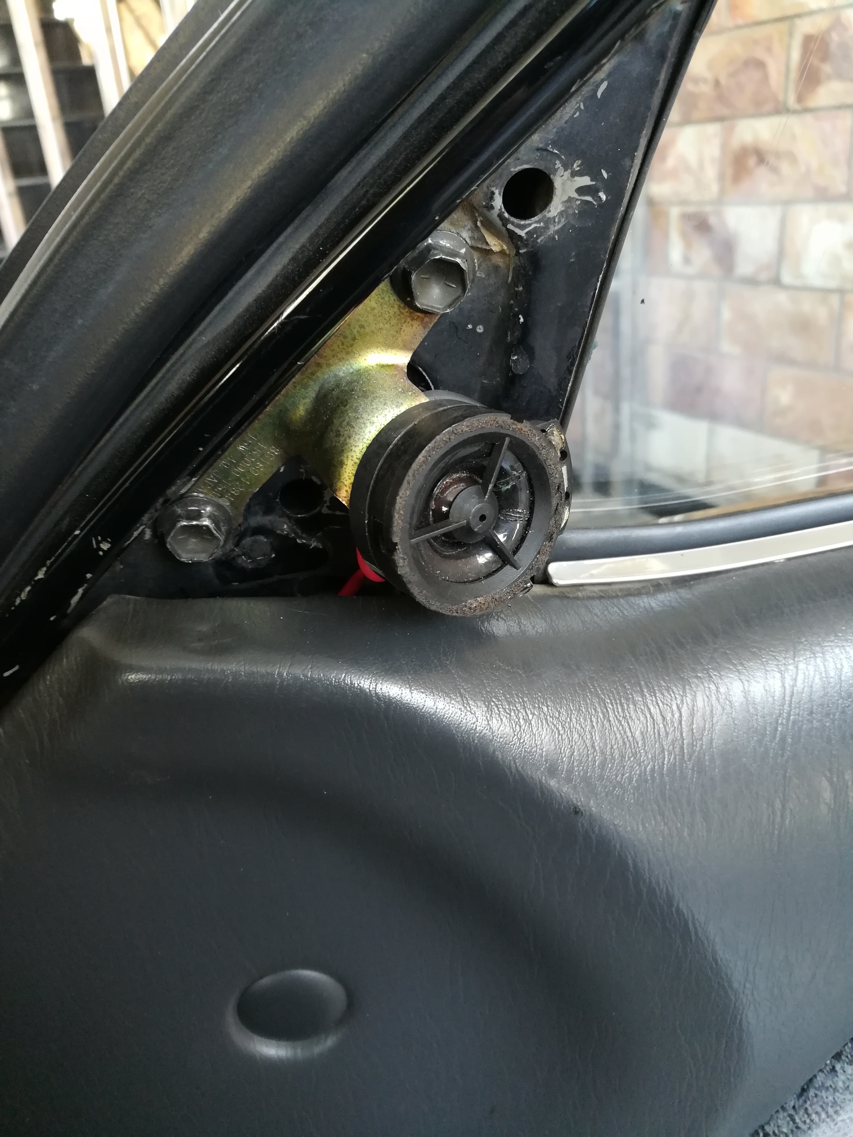

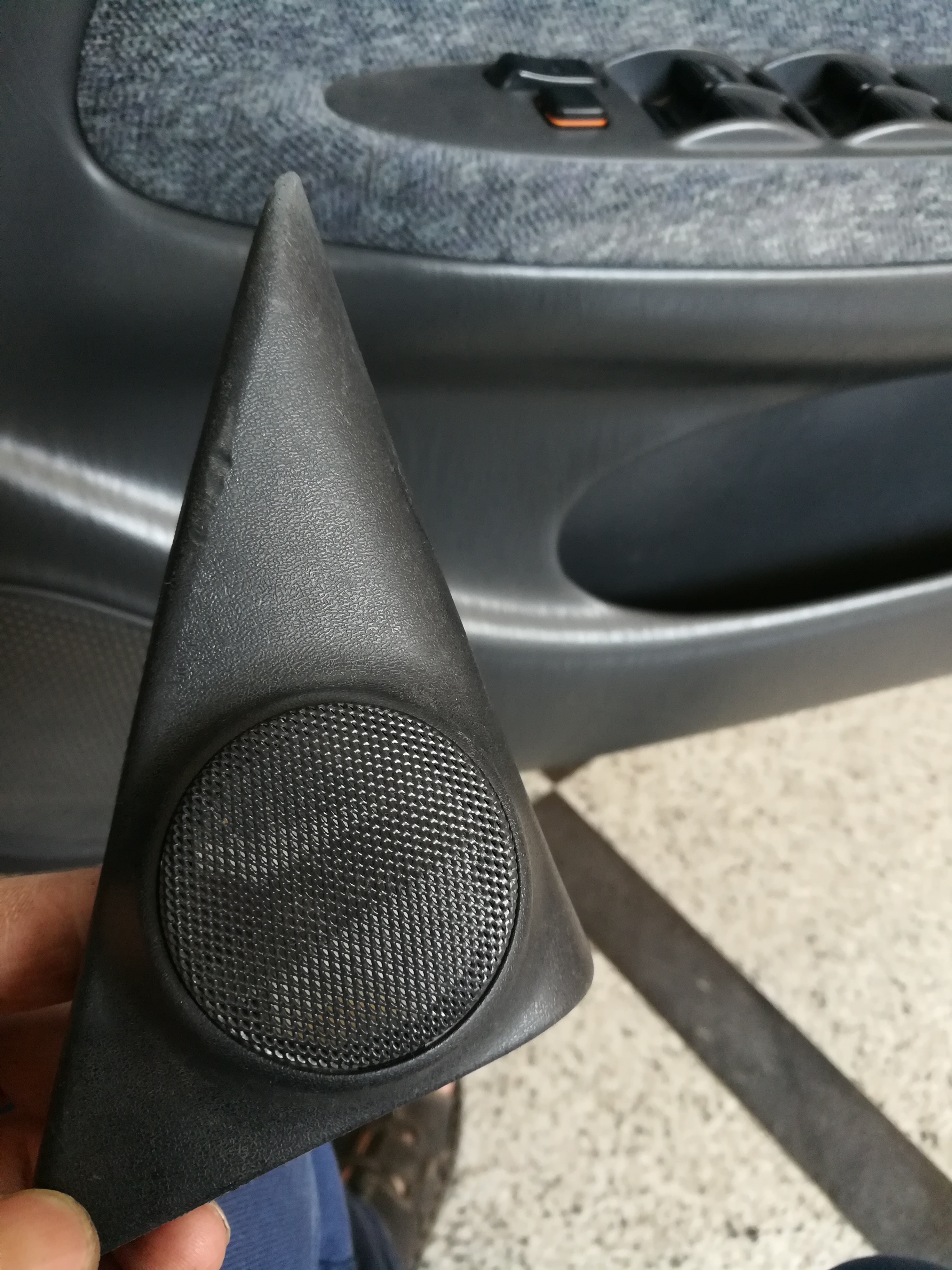

Installed Tweeter pods, Rare JDM item..

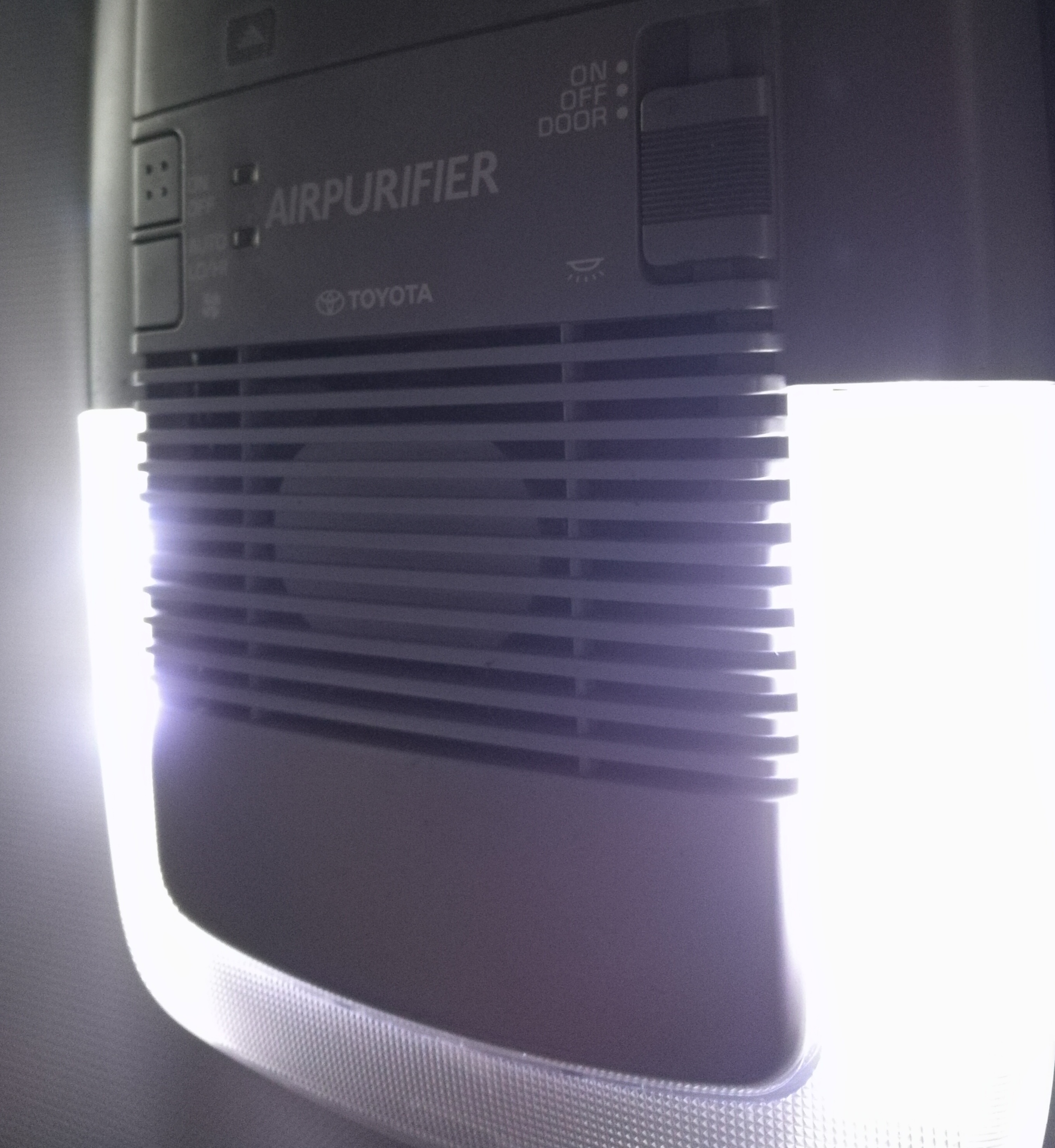

Added some leds to my air purifier...

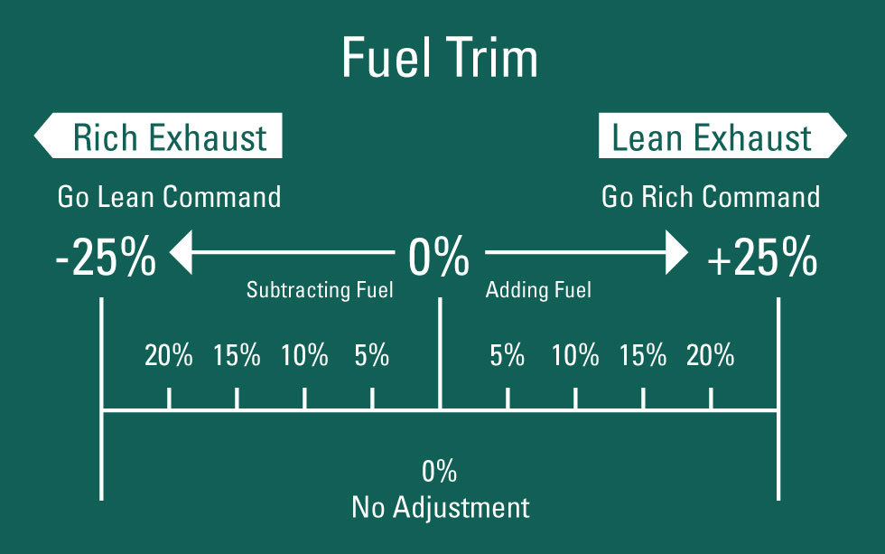

I have done reading some articles on google about trims values. According to those articles, my car's long term fuel trim seems to be on higher side, which means ECU is adding more fuel to lean the mixture although this value is not that much high to trigger up check light. It is showing +12% on idle, while driving when I press accelerator lightly, value came down constantly to 3%.In article, it was stated that if u observe the behavior (same as mine values), it means that there is some vaccum leak in the system.
How to check for any vacuum leaks in the intake system ? Any tips ? @capsat @Vaqas1
go through all outter vaccum tubes, air box seals last but not least perform compression test to check for engine health valve seals / leaking seats

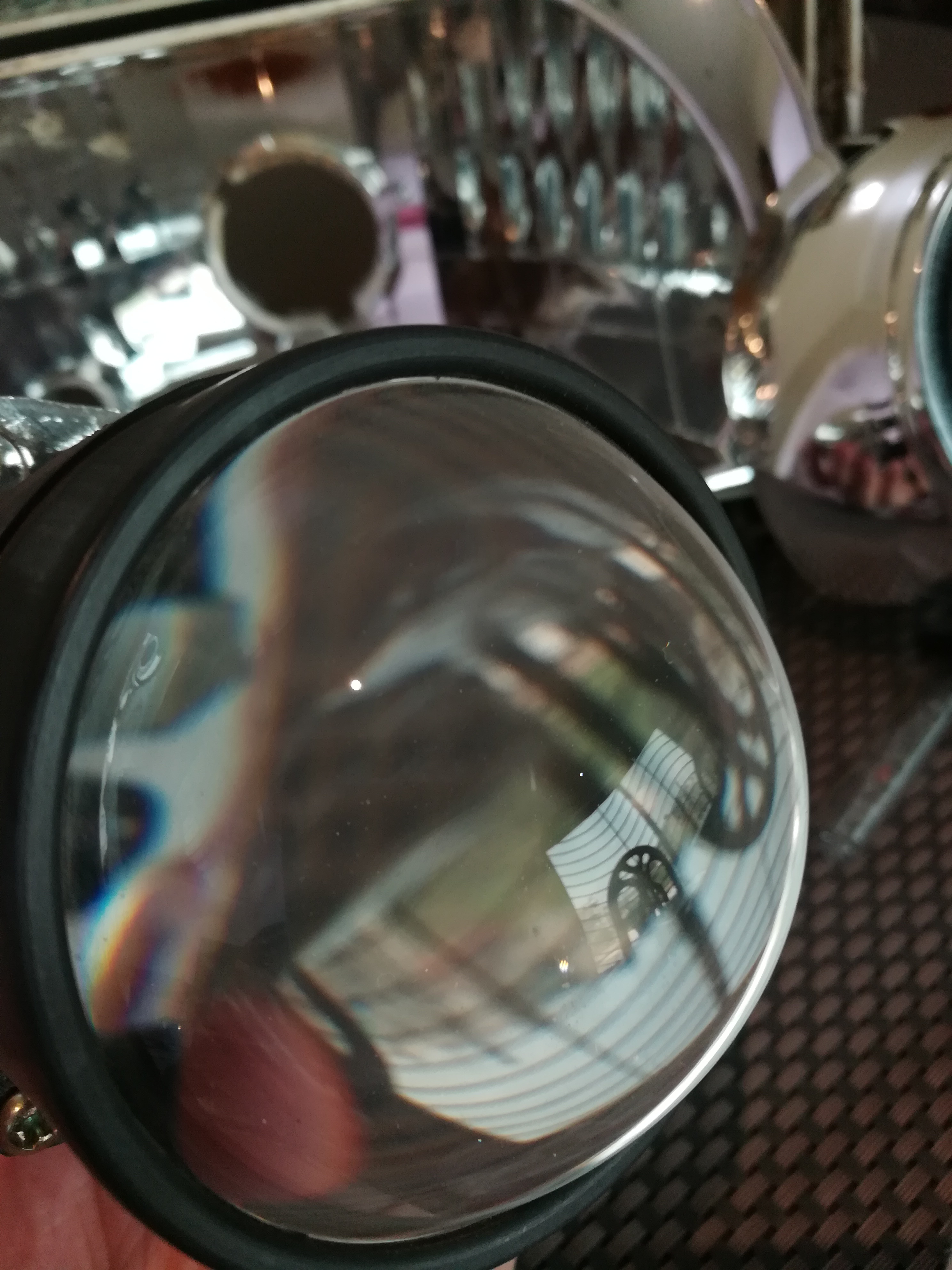

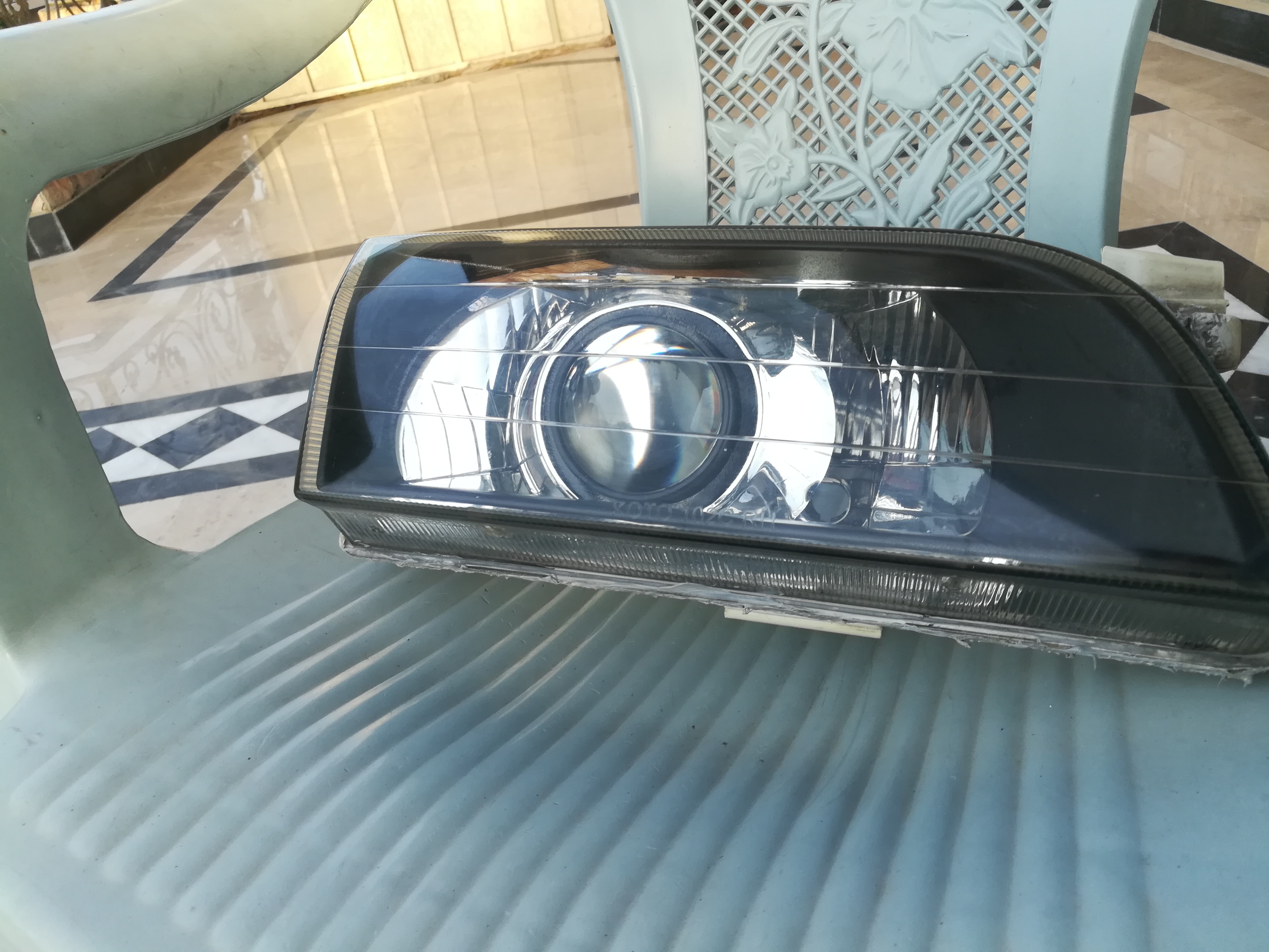

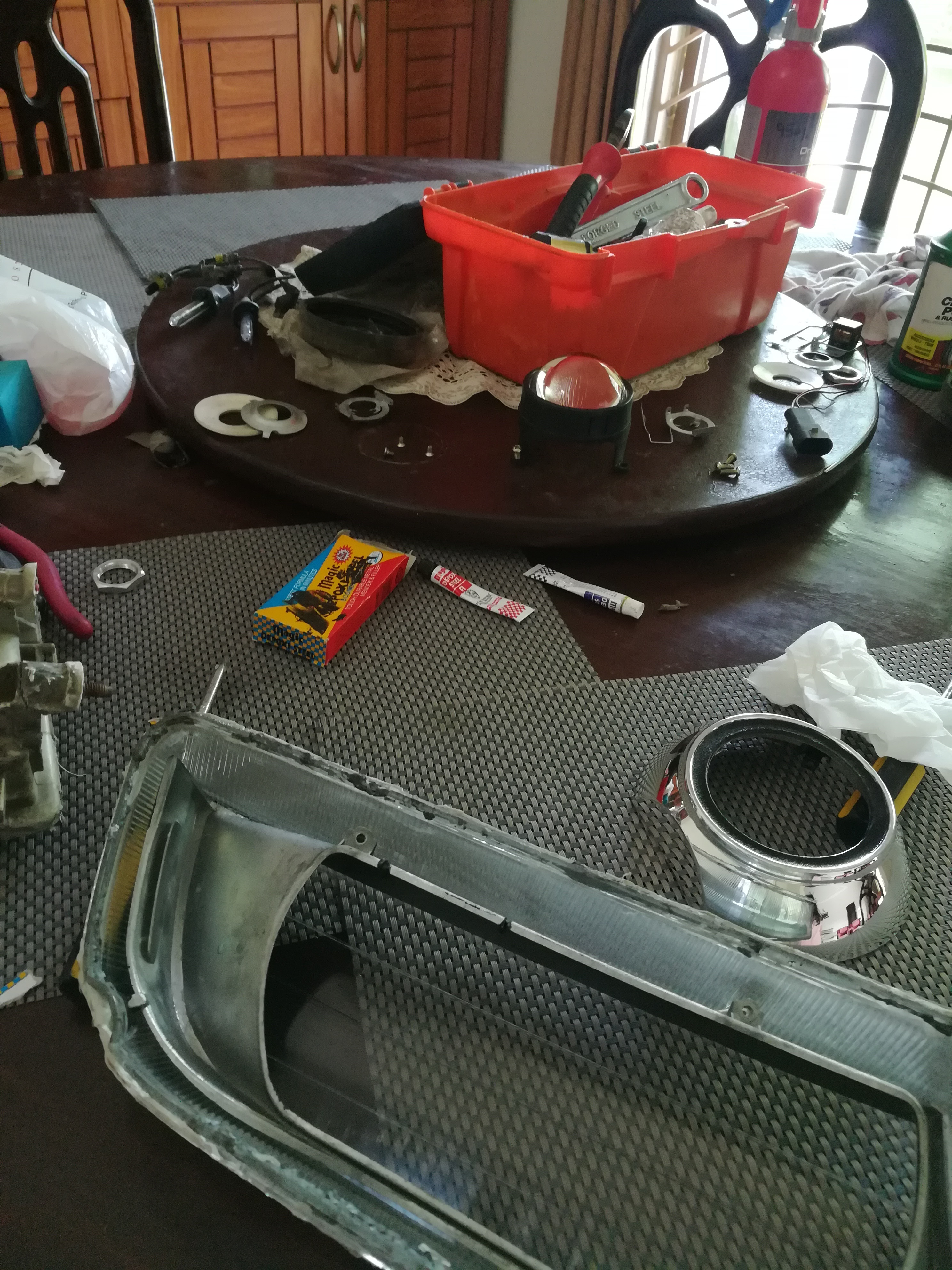

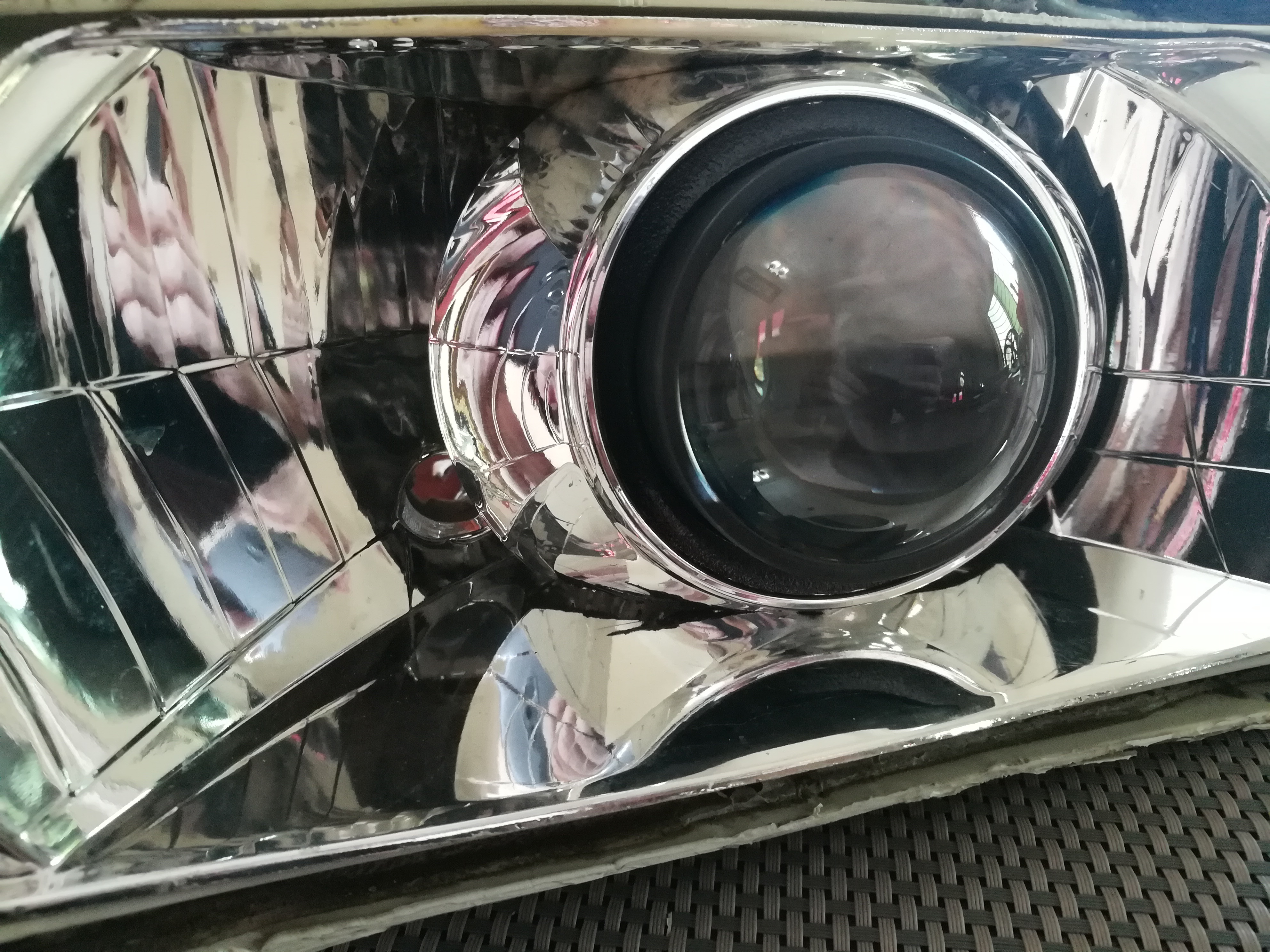

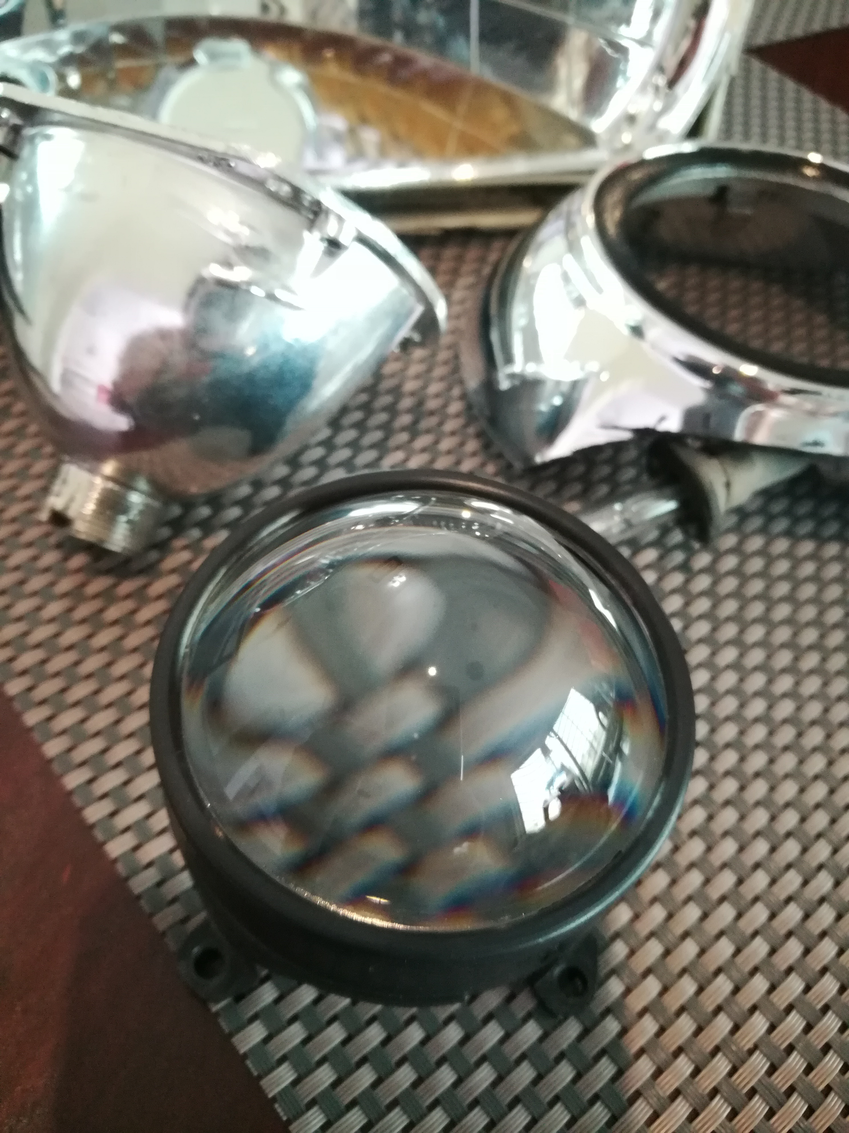

My retrofitted MoriMoto USA HID projectors got a bit dirty it was time to clean them.
Hectic work in Roza and heat.

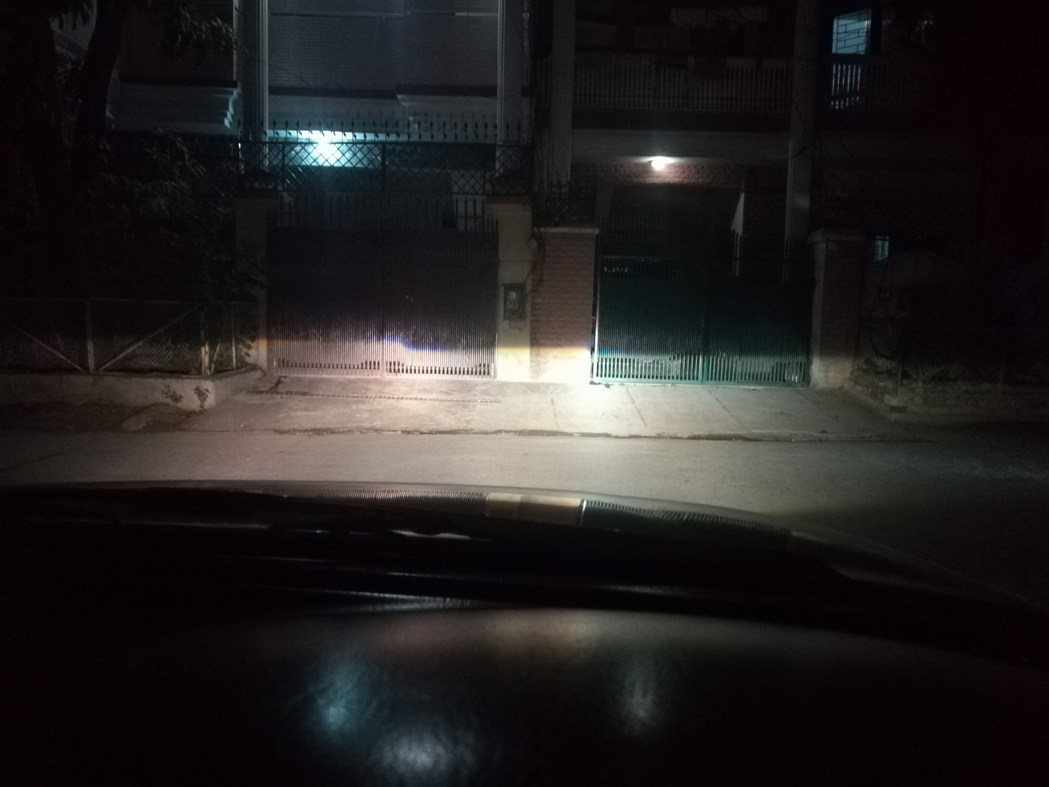

Superb
Thanks. Result light got much better.. Sharper than pic.

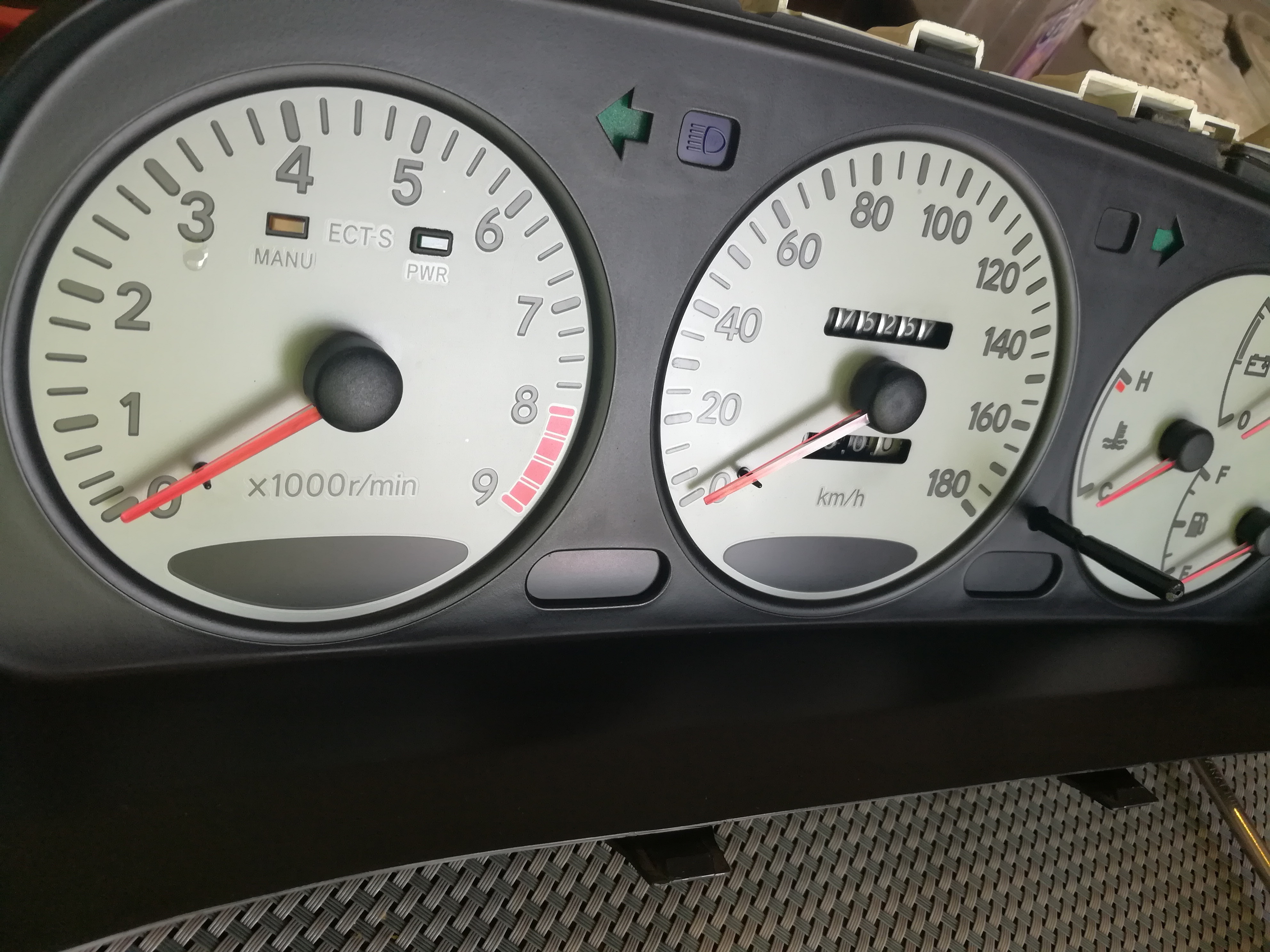

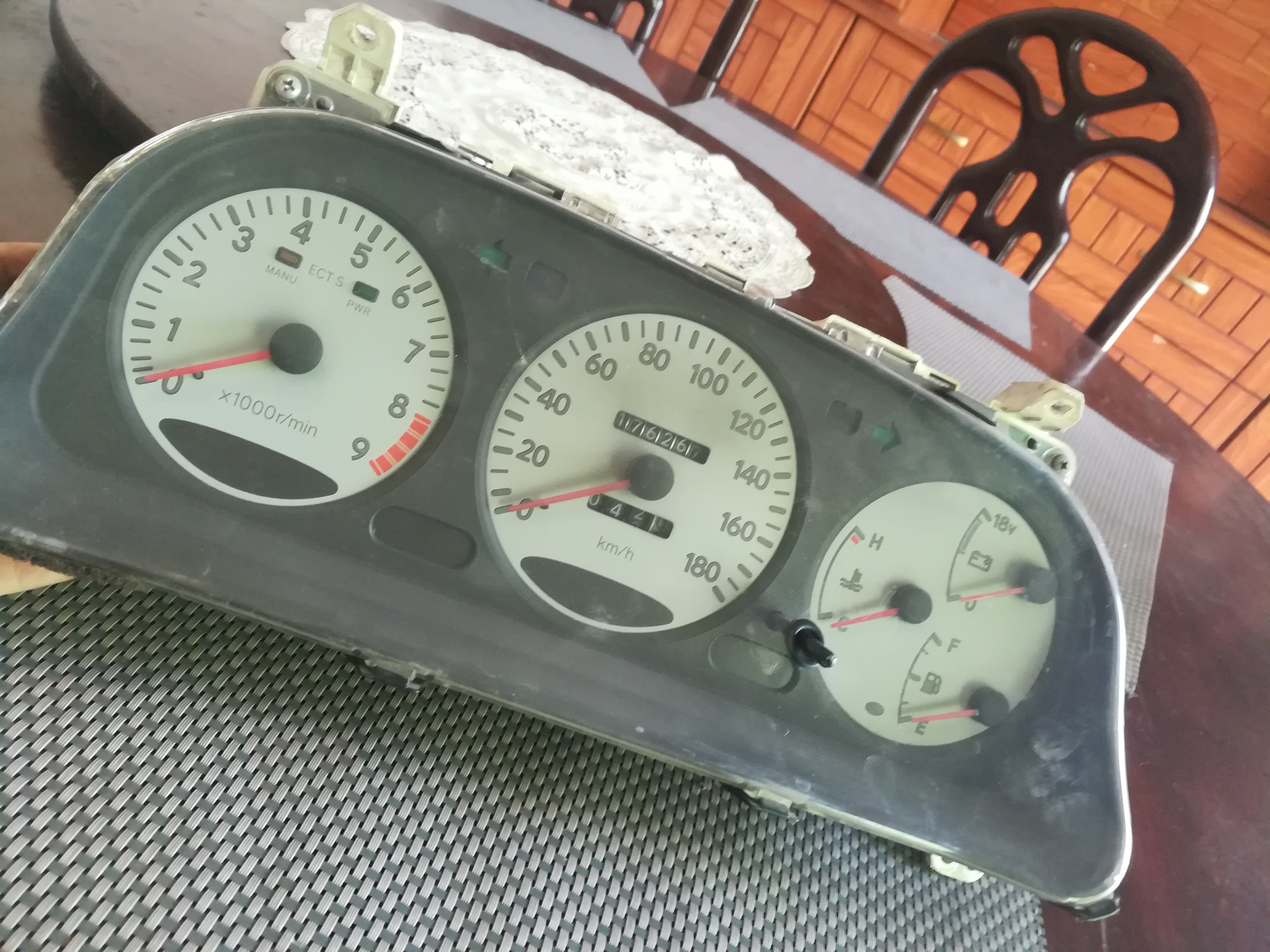

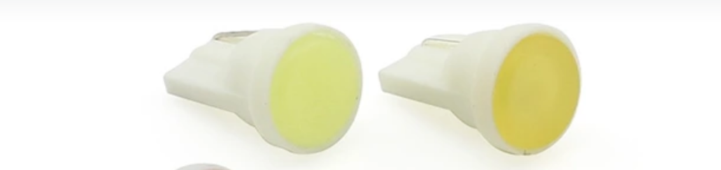

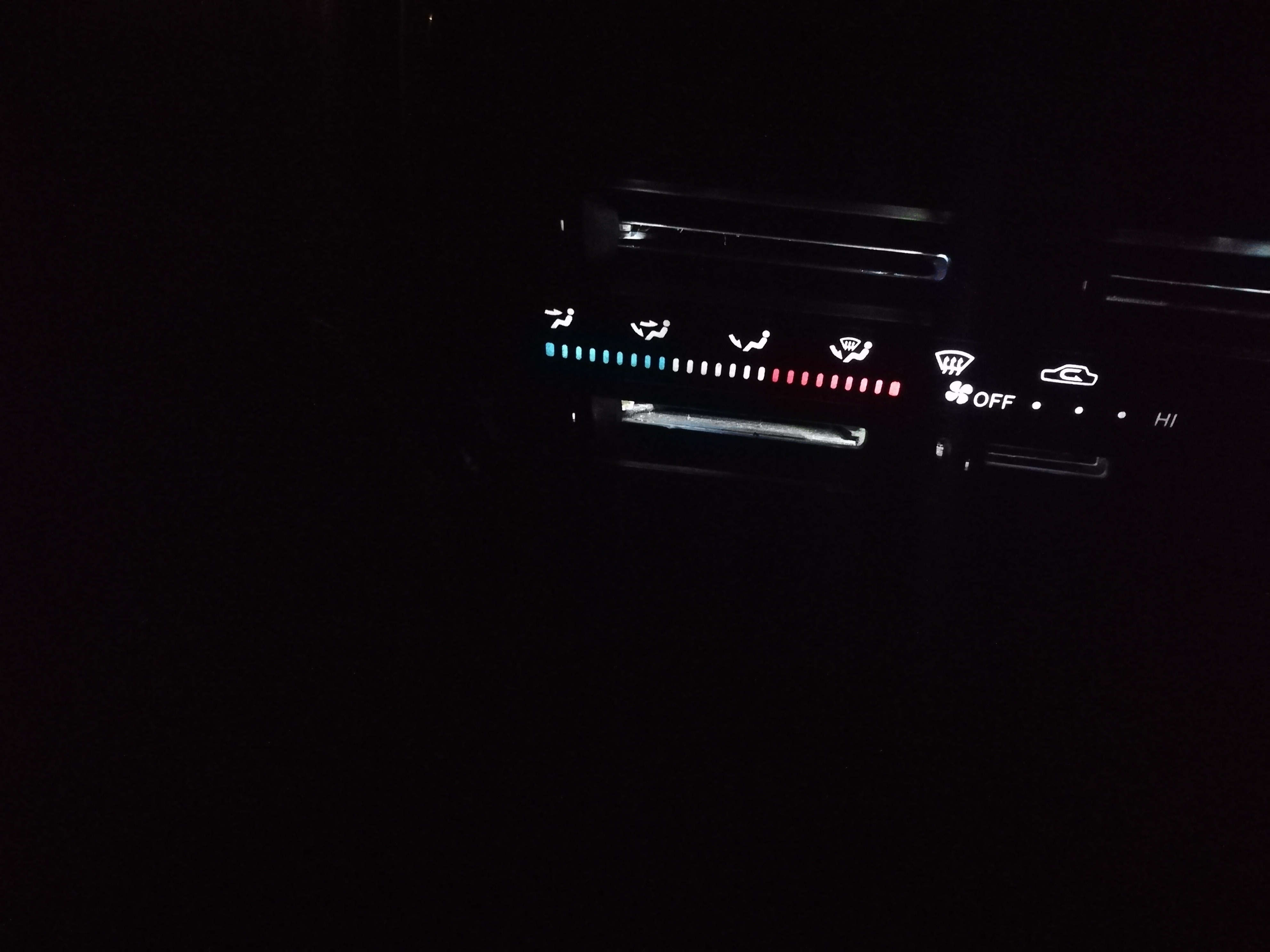

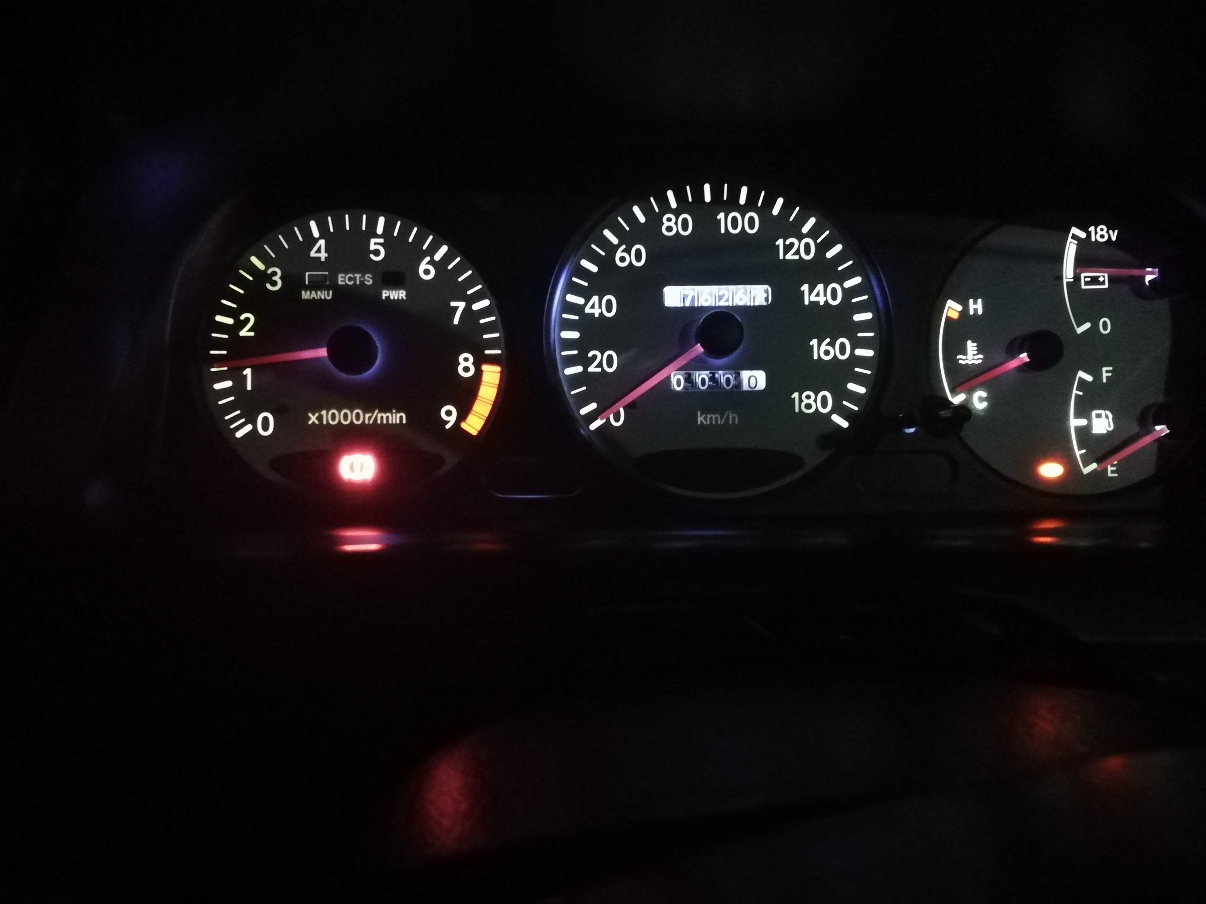

Installed these LEDs and cleaned the meter, these ordered from Ali exp.
superb....
