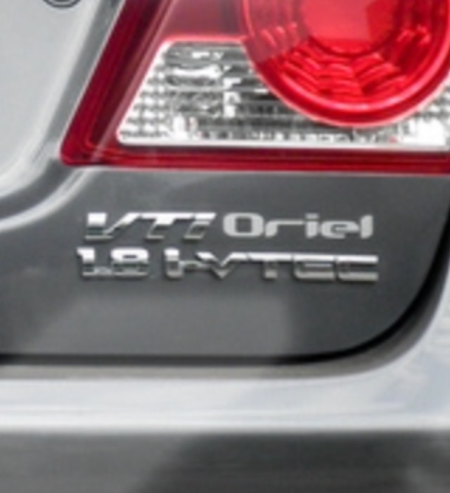

Guys anyone knows from where to find the Oriel sticker?

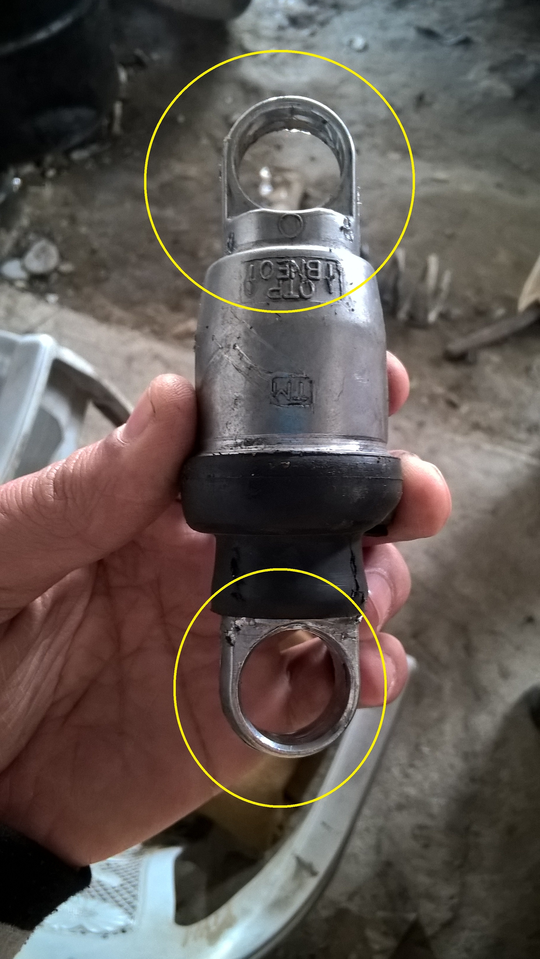

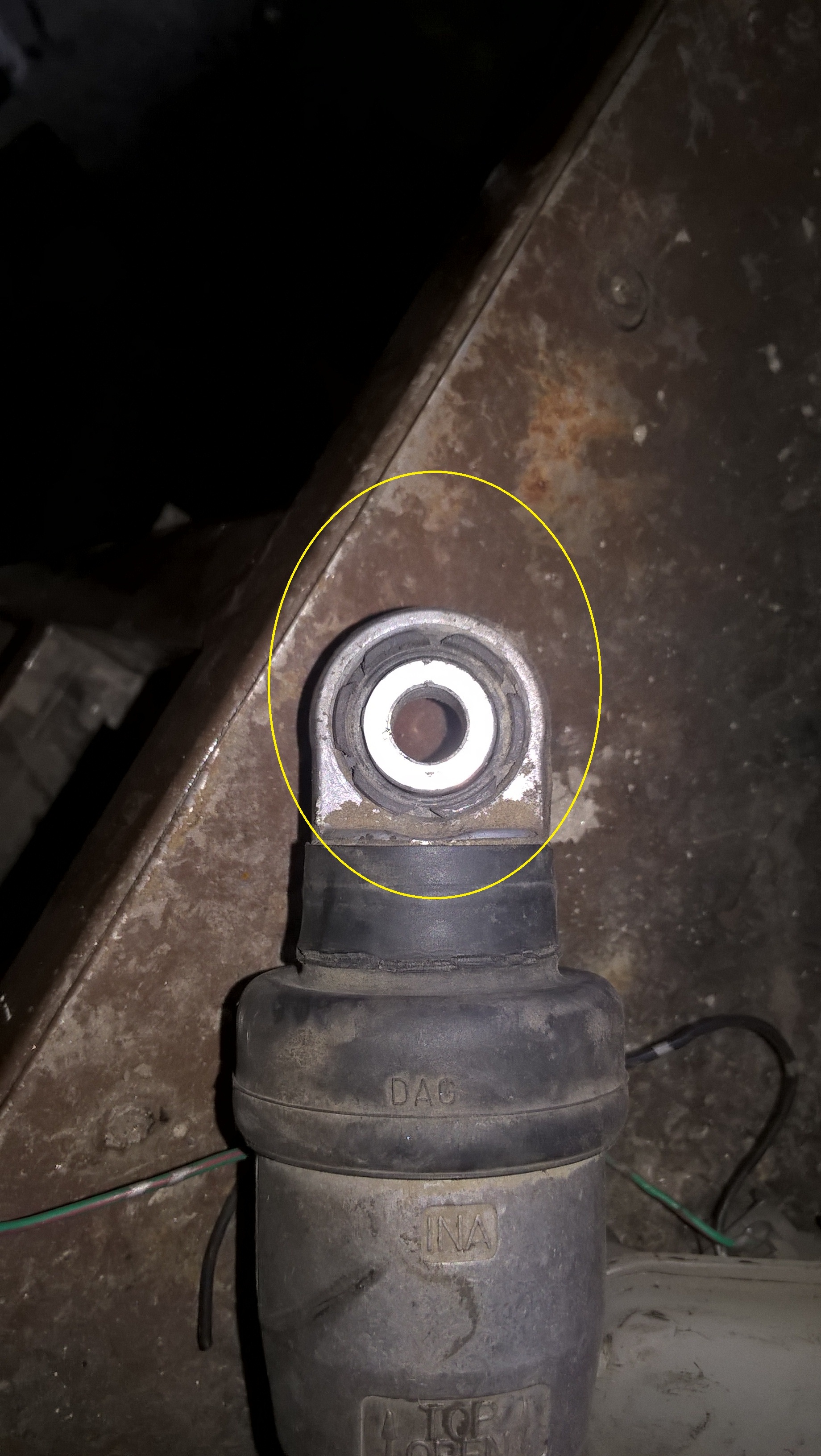

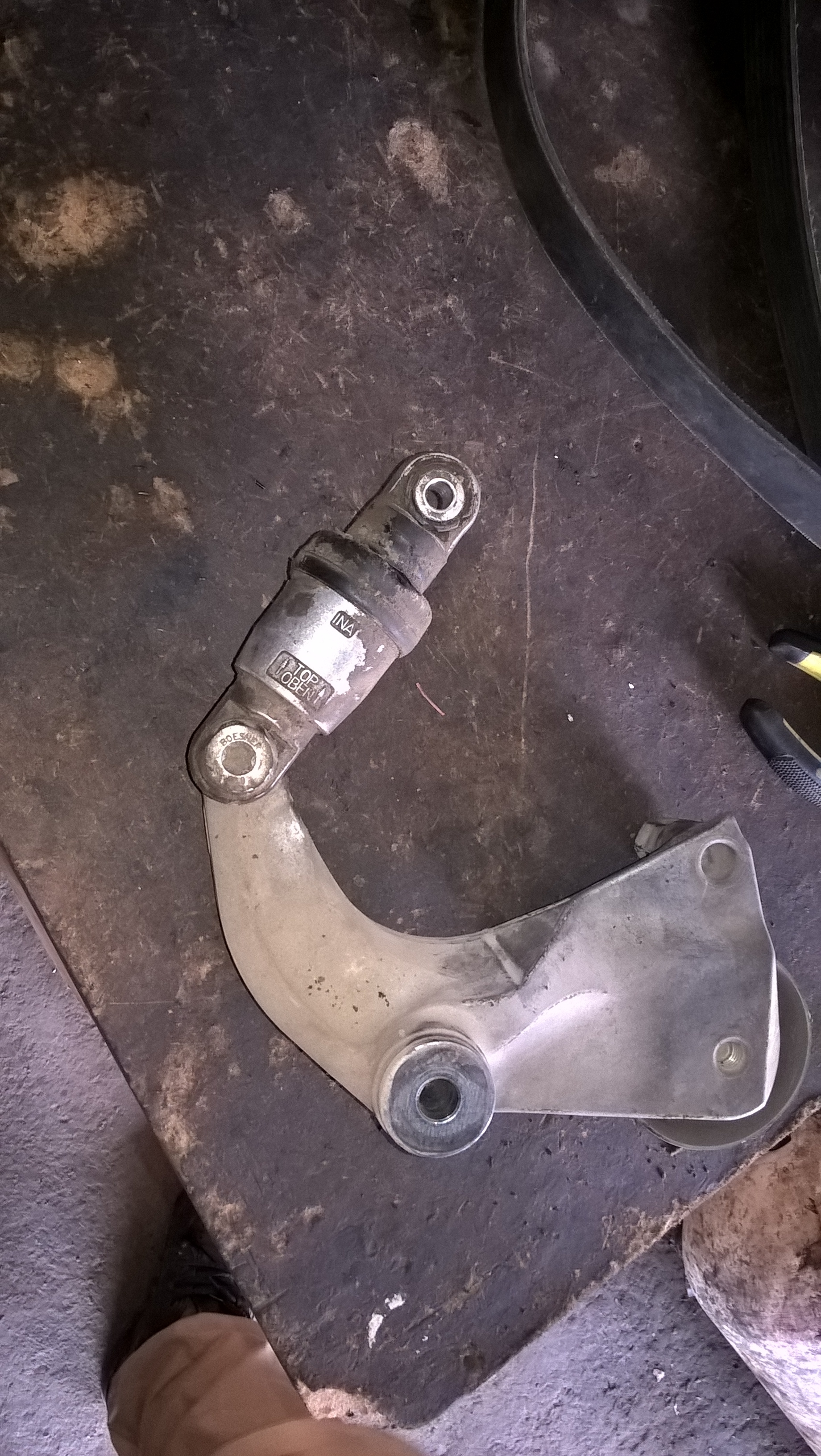

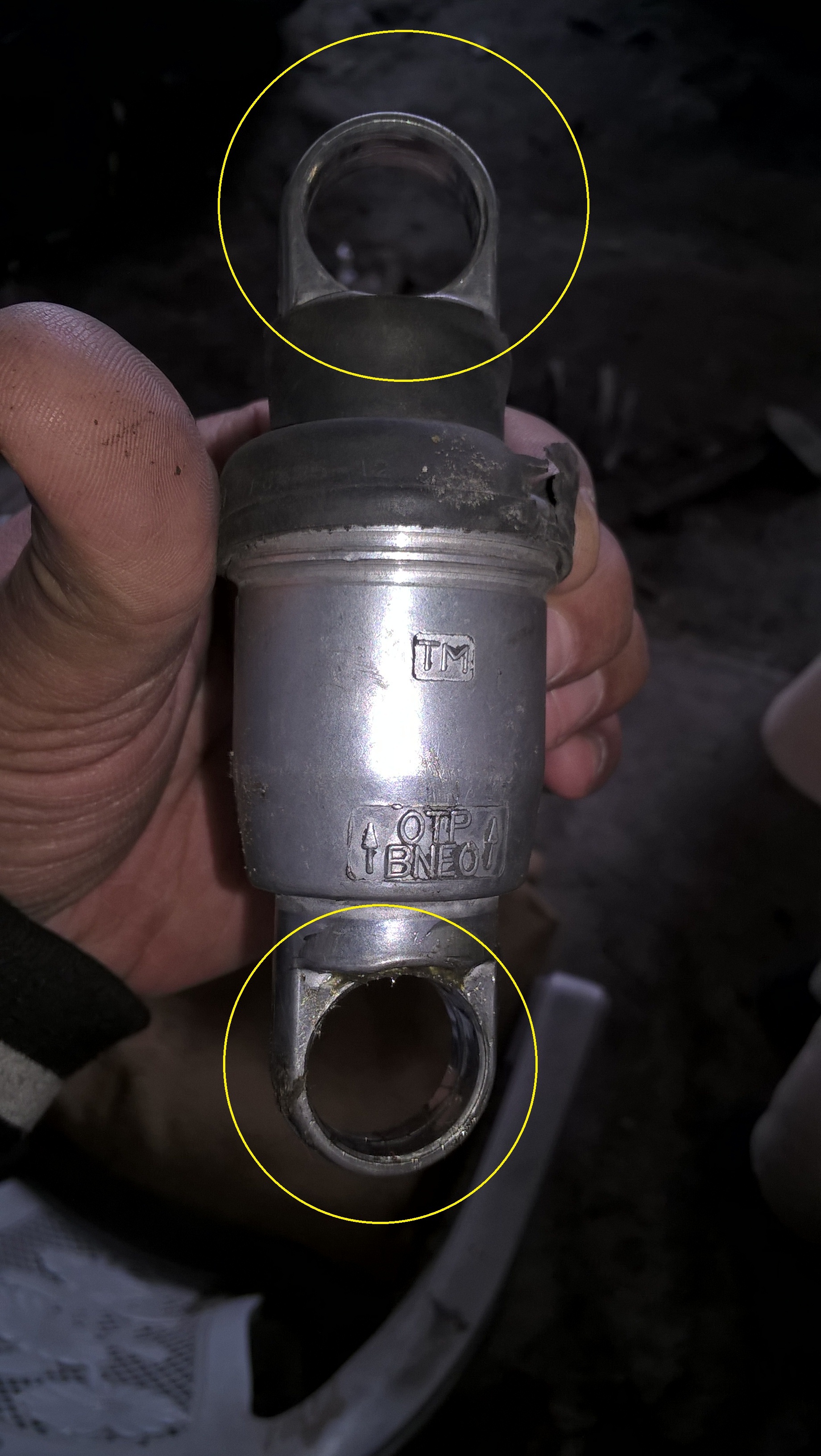

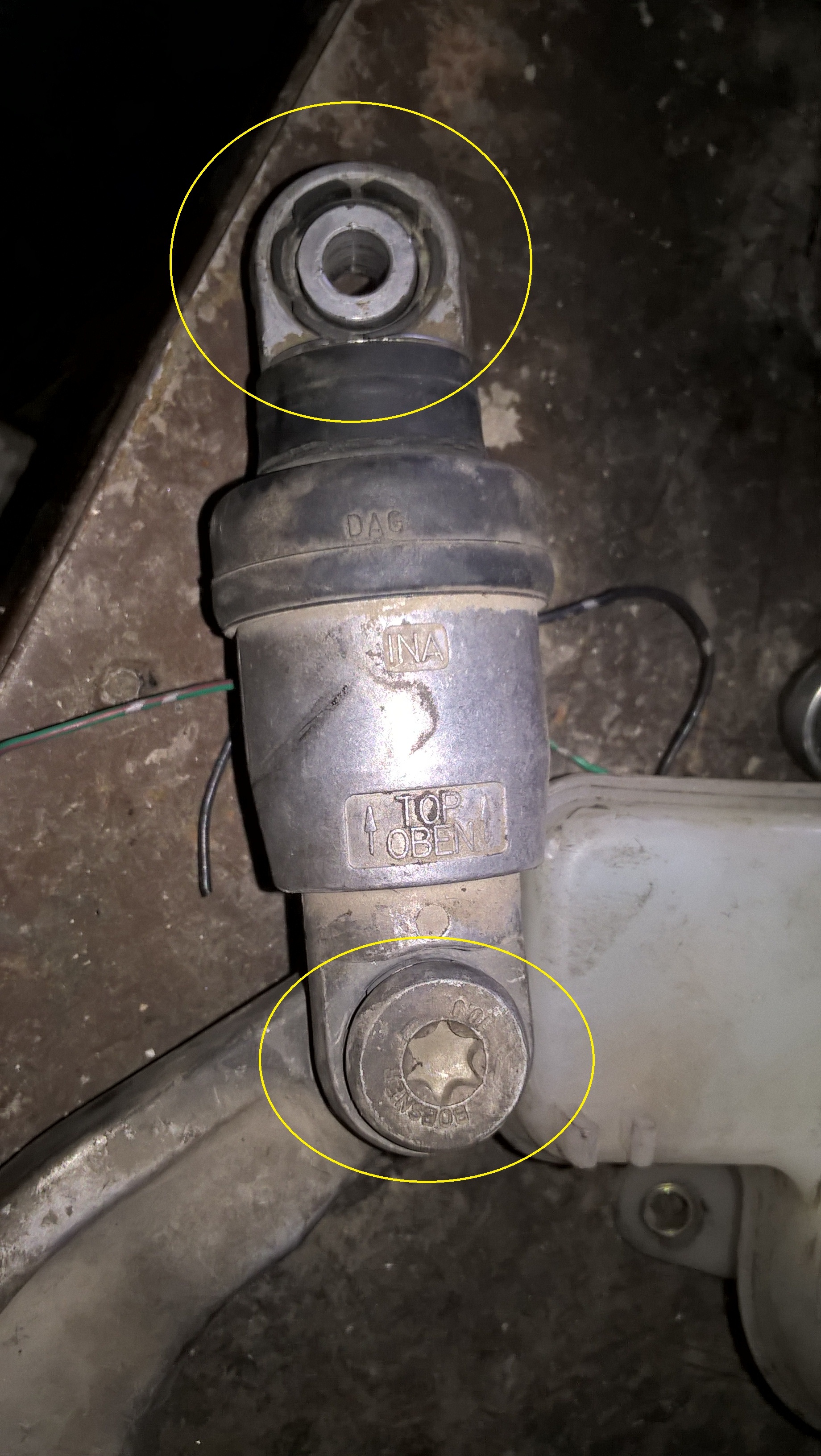

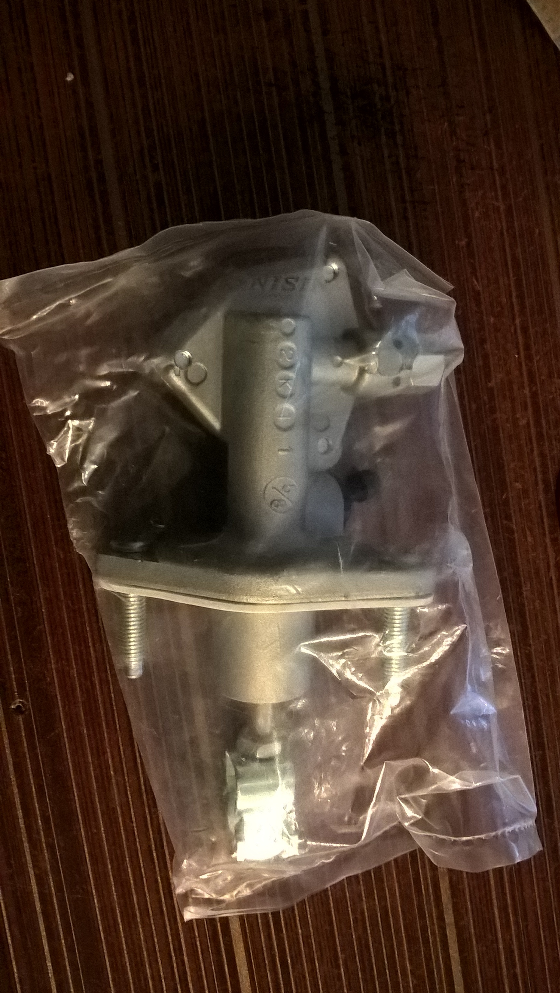

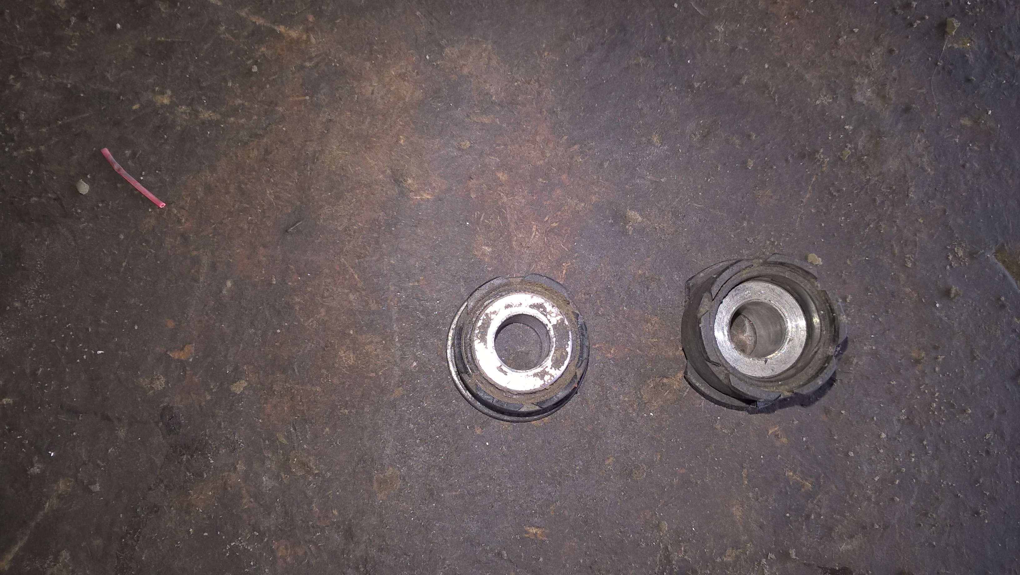

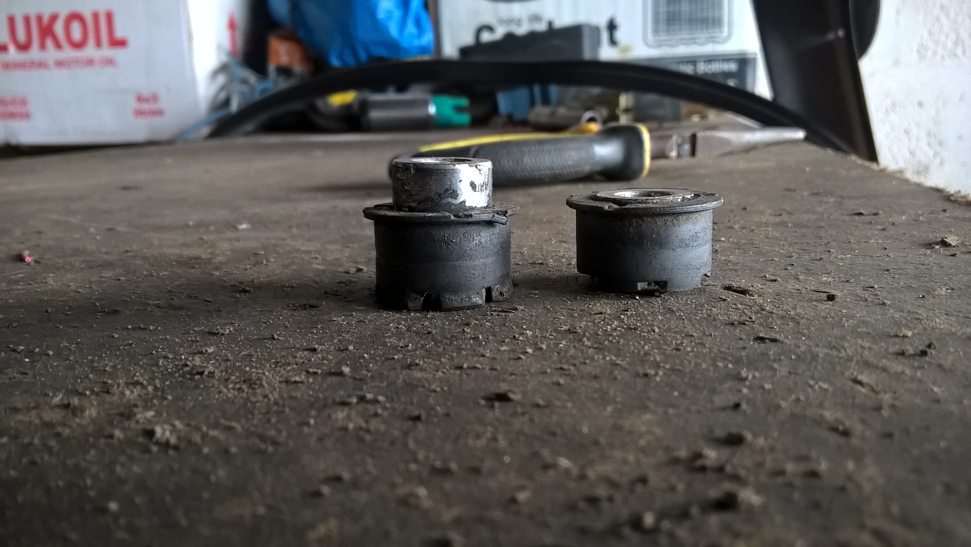

hello.finally I've done it.fist of all to mention is that the rings i bought were not the apropriate one.these are of power pump as well.was misguided .after that the problem of tensioner is solved as the mechanic removed the tensioner and after examining the issue i got that there is no need to change the tension-er only 2 bushes were worn out and needs to be replaced.and the mechanic was agree with me.he was having an old one might be having different issue but the bushes were ok.so we decided to change them and see what happens.and now its all fine no kar kar kir kir sound.secondly i was facing an issue since long that the car jerks a bit when you are moving in 1st gear .one said that its because of clutch disc even honda authorized mechanic also said this.i have replaced clutch disc although clutch was having issue but the problem was not solved.meanwhile another mechanic said that this is because of clutch master cylinder.so i was having no option than to replace .i bought taiwan made costed me 2500.and now the problem is solved.images attaching for reference.

[/quote]Glad to hear that you solved the problem.Are these rings available in the market?Since i am experiencing "gooon" like sound no "kirr kirr karr karr" i reckon its the pulley.Did you experience the same kind of noise?
i'm not sure .coz these were also taken from an old one having some other problem.but these rings were ok.try some where in old parts if this shock is not working yo can get rings from....
