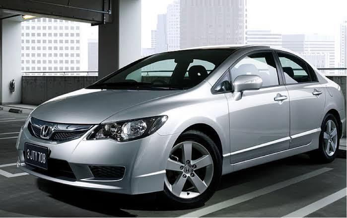

What is the oem tire size of 16' wheel (picture above)?If not availabe the required oem size, then how much increase should be there for best oem result ?
I guess u will have to go with 185/55 as stock is 195/65R15
Bhai 16" ka puch ra hun, 15" ka nahi ...
Me bhi 16 ki profile bata raha hoon 185/55R16
It's 205/55/r16. This oem size with the same rim design came in many international markets, including UAE, US, Japan. This tyre size is easily available in market. Its the same size as new Corolla Grande.
