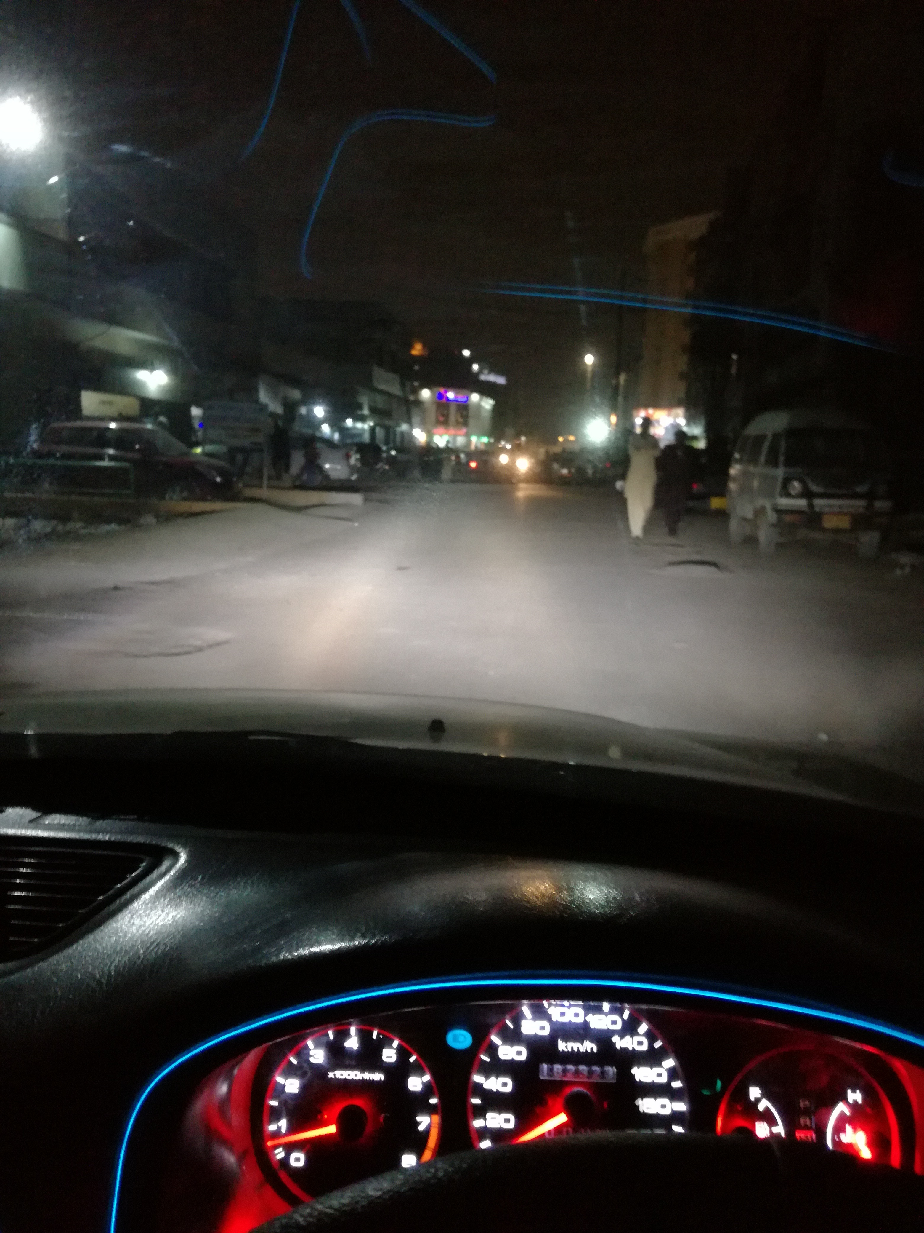

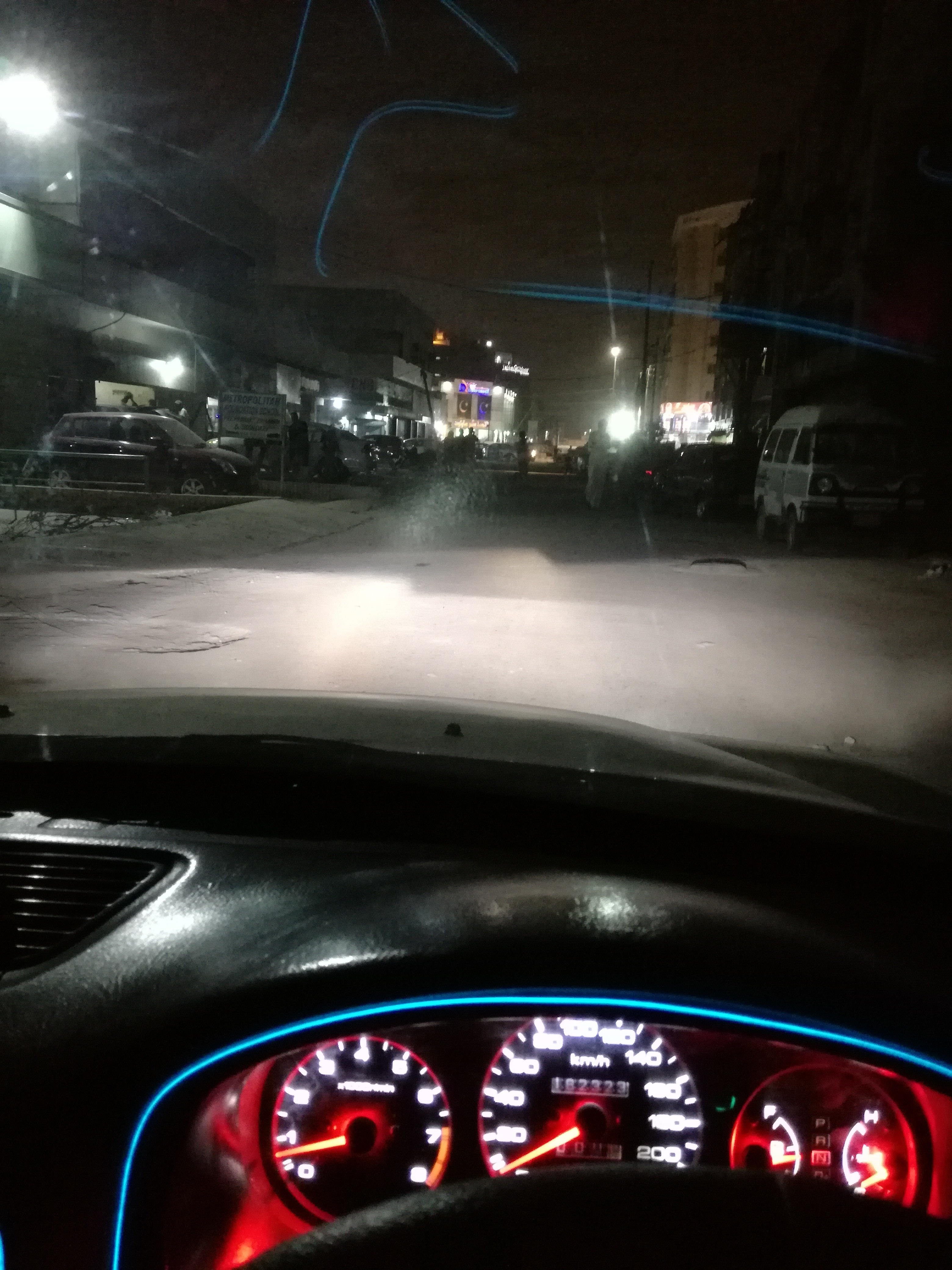

Postman took 50rupees custom fee. 200w HID bought from local shop which cost 5800PKR in Karachi. Use 200W HID otherwise you won't get good result. I'll post pics soon.
Here's some HID and DRL result
misaligned lights..
i would avoid 200 watts..
the normal wiring is designed for 55 watt.
excessive heat may melt plastics in the light housing.
the problem i actually had was that the projector reflector are not really of good quality. the reflectivity should be like a mirror but its not.
"misaligned lights.."
I know lights are not properly aligned, I will set it later by myself.
I haven't got any report of housing melting issues but i will do some RnD about it. Thanks for sharing
