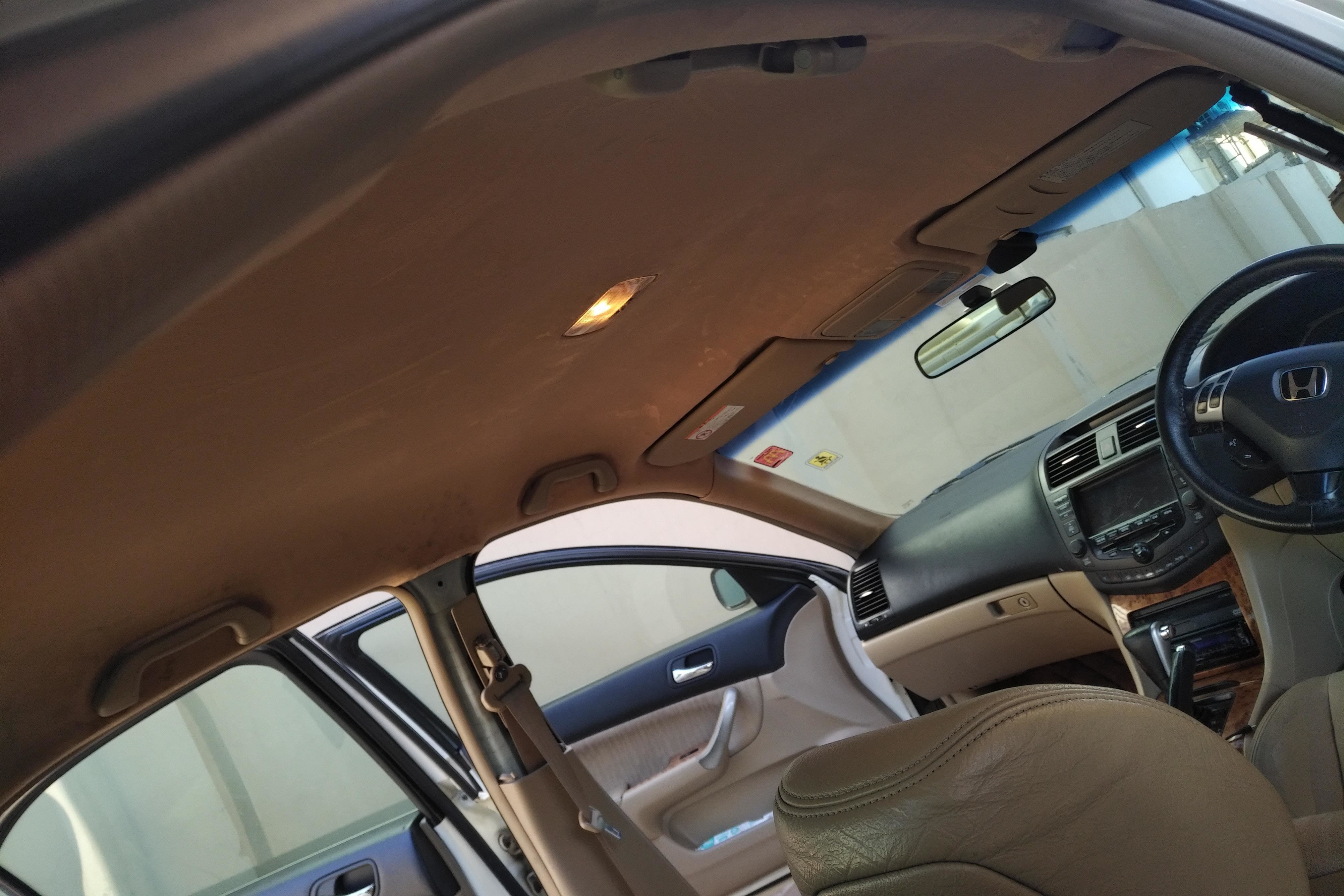

As I shared previously my cars headliner was hanging.

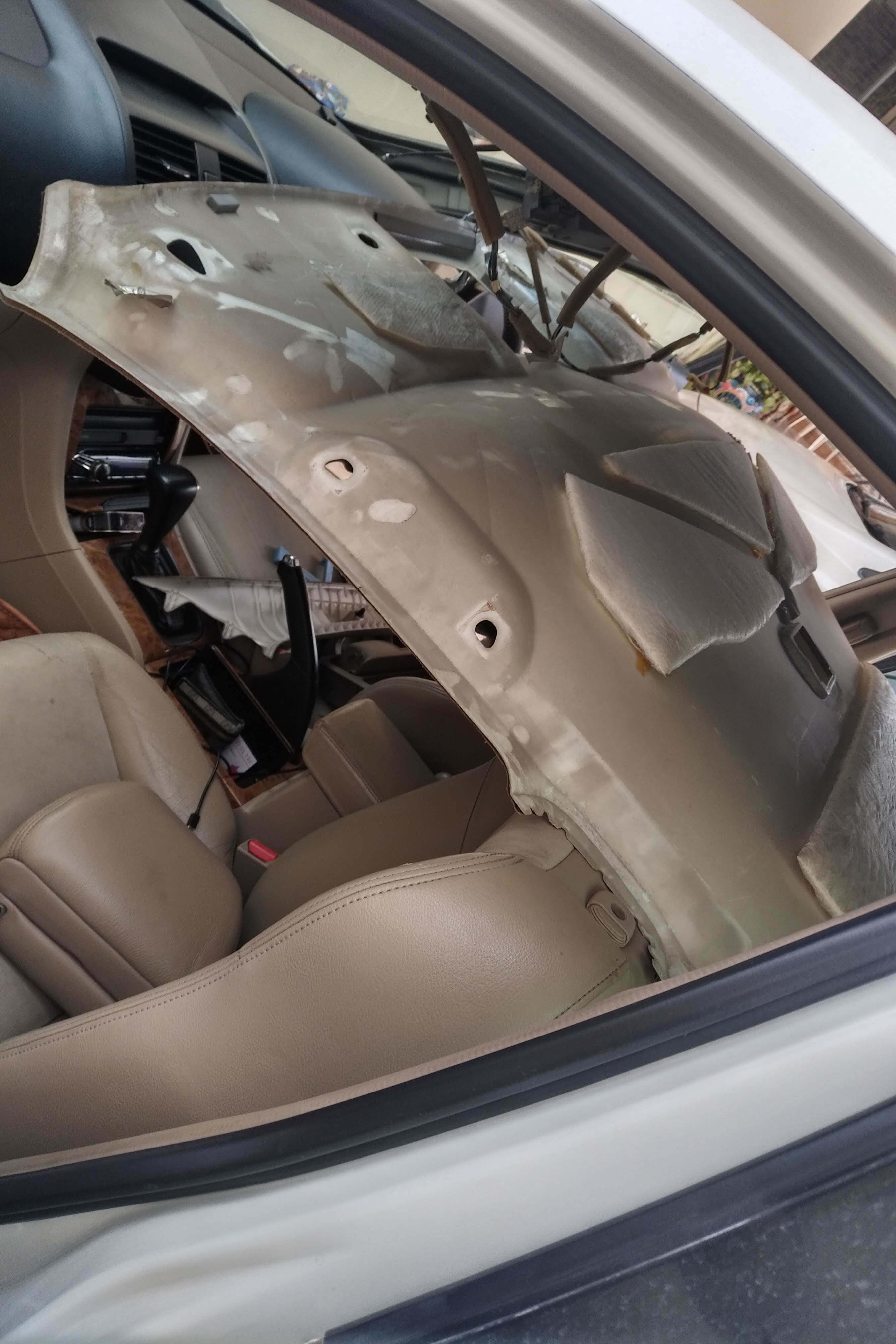

So we removed the cars headliner to fix it.
@effaf27 removing the sunvisor.

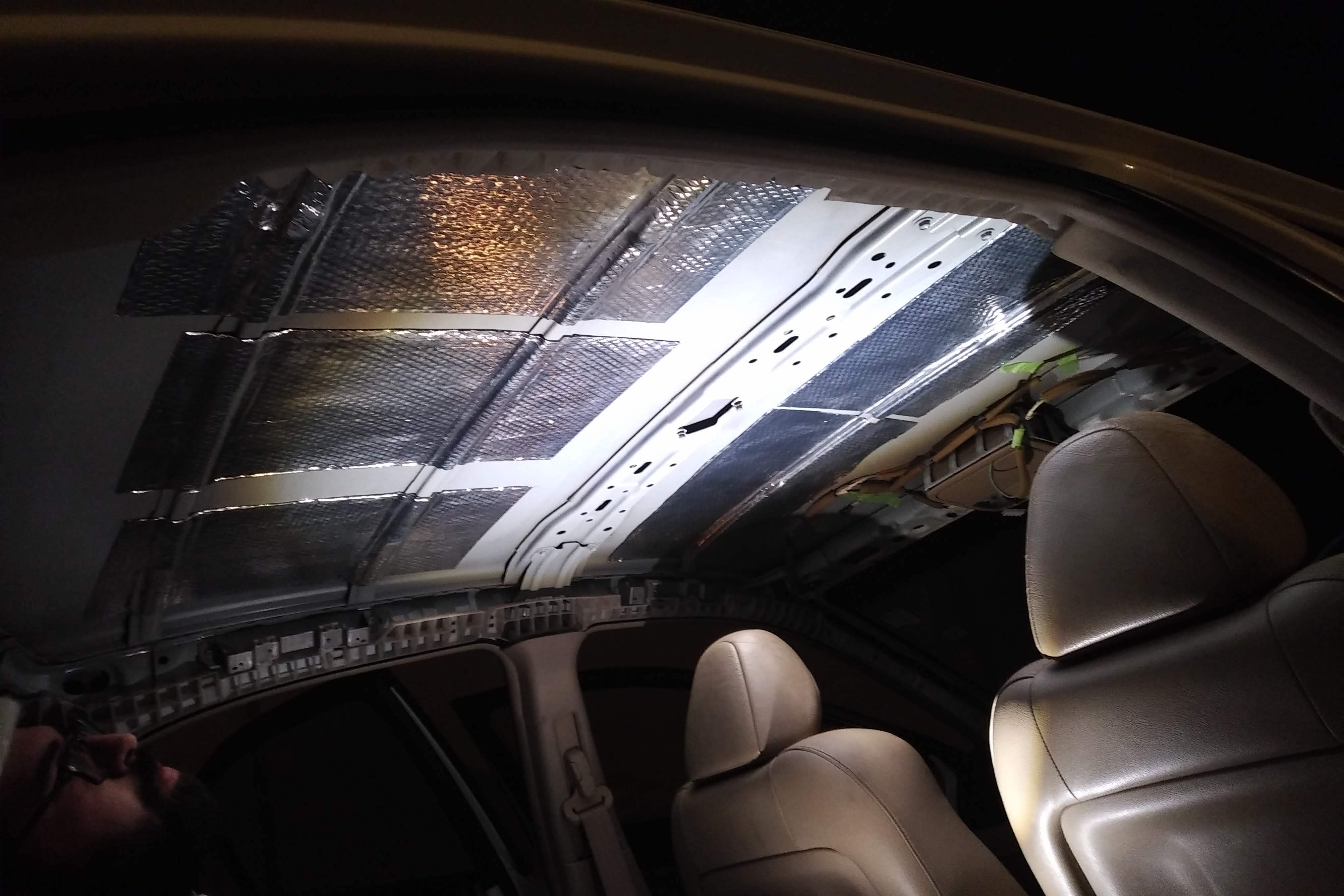

Put some sound deadening sheets on the roof

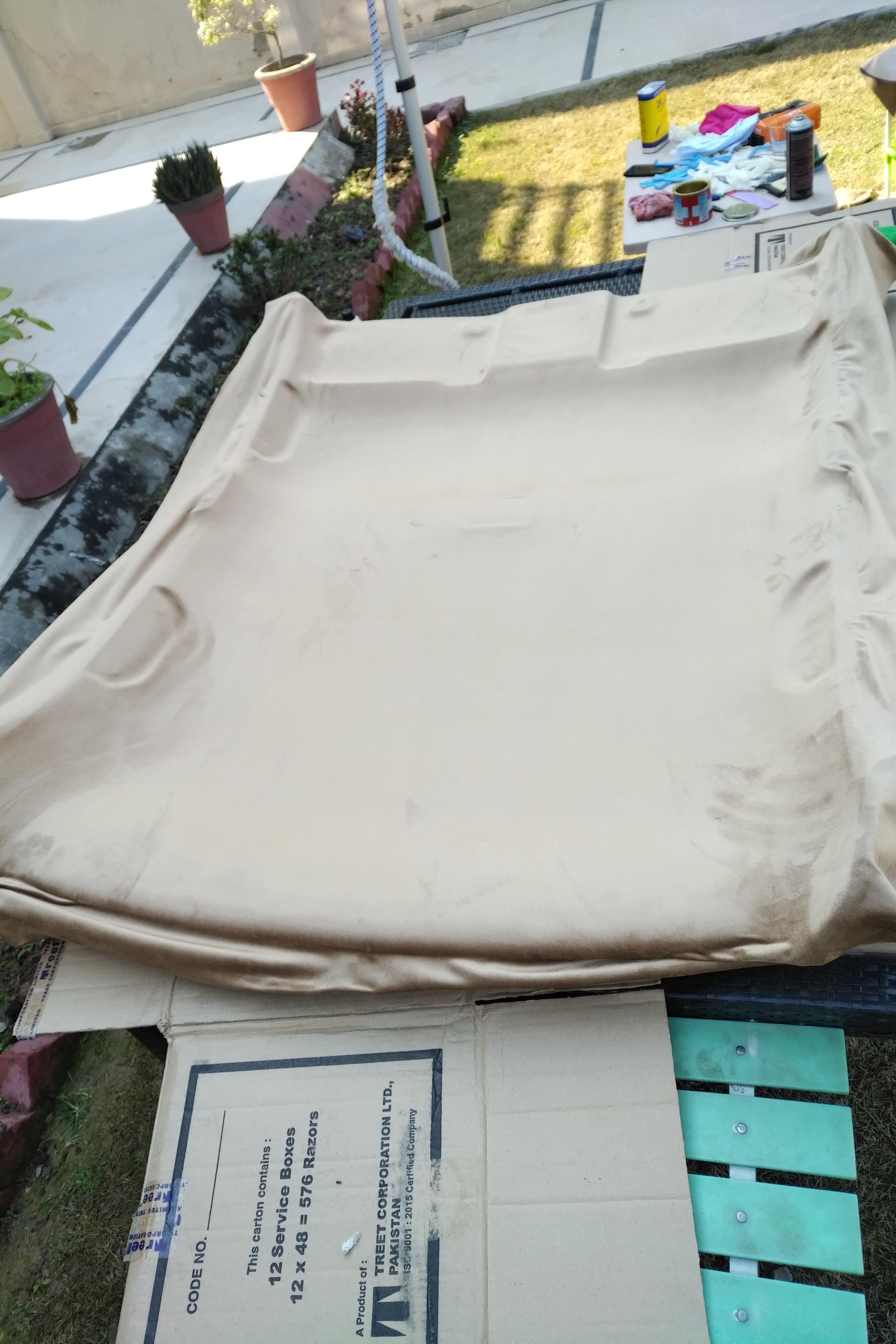

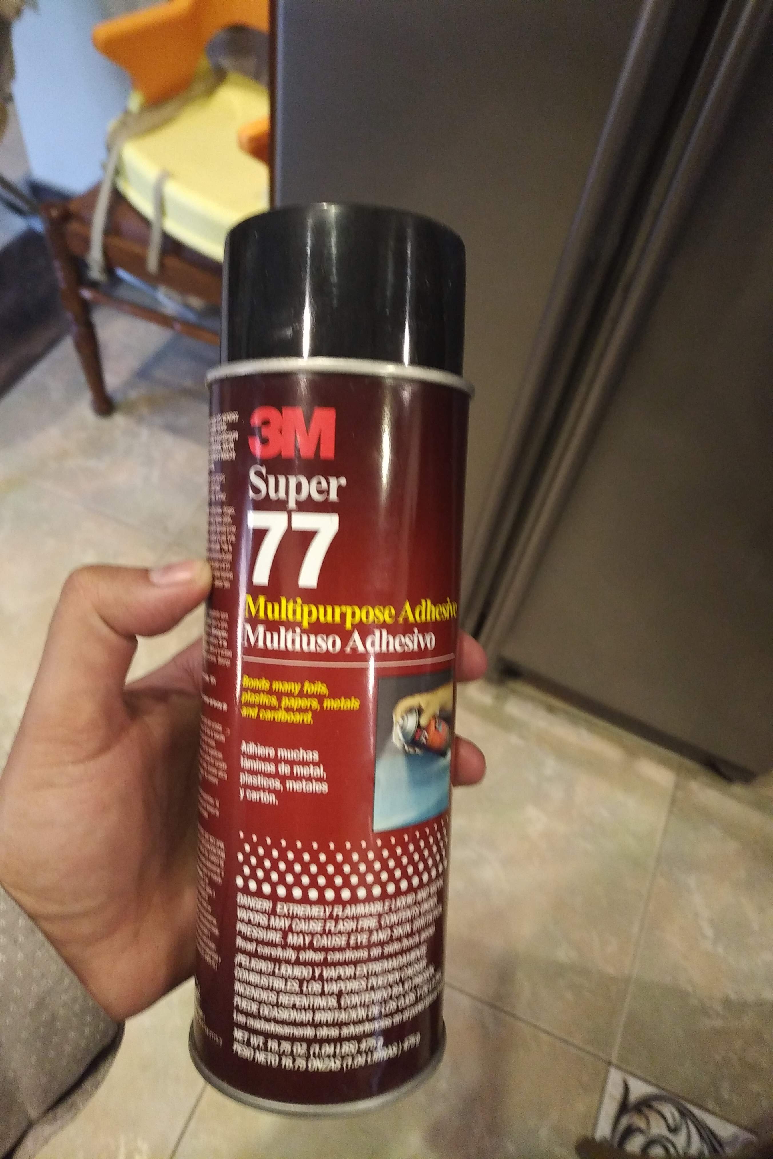

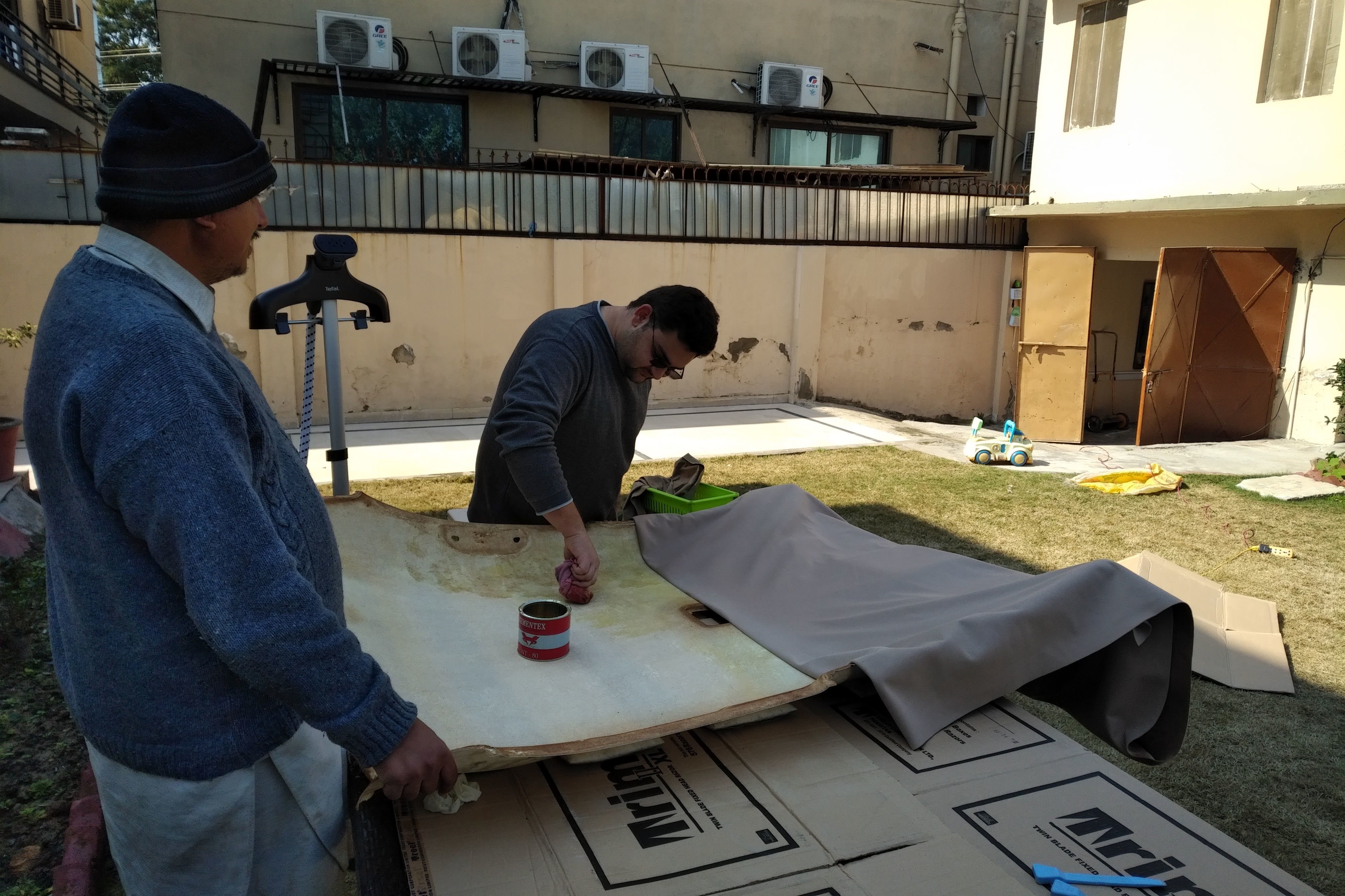

Bought the fabric and 3m 77 adhesive and NT-80
Watching multiple youtube videos, we used a steamer and a heat gun. The steamer didnt work well. it damaged the fabric so we didnt use it. We utilized only the heat gun.

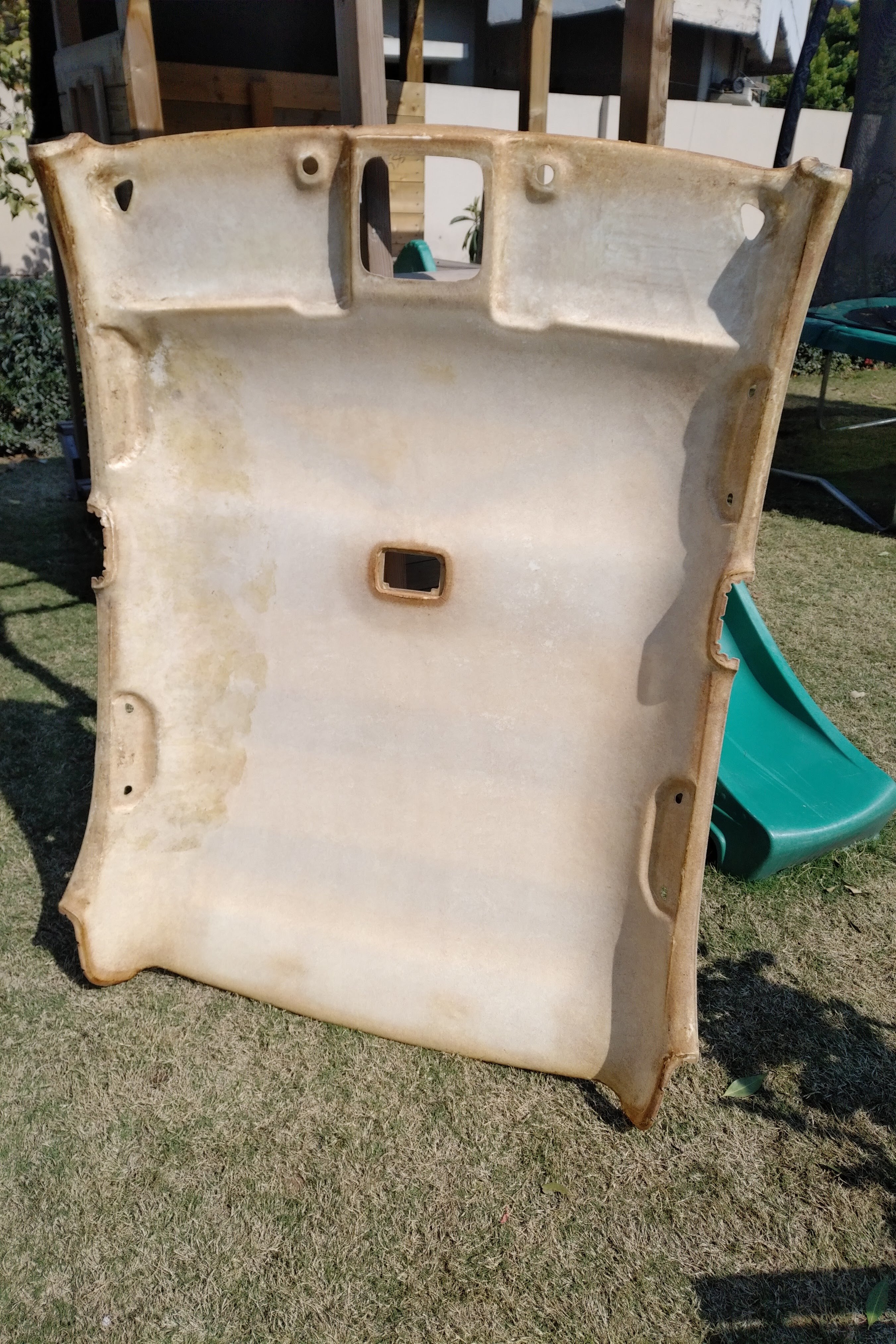

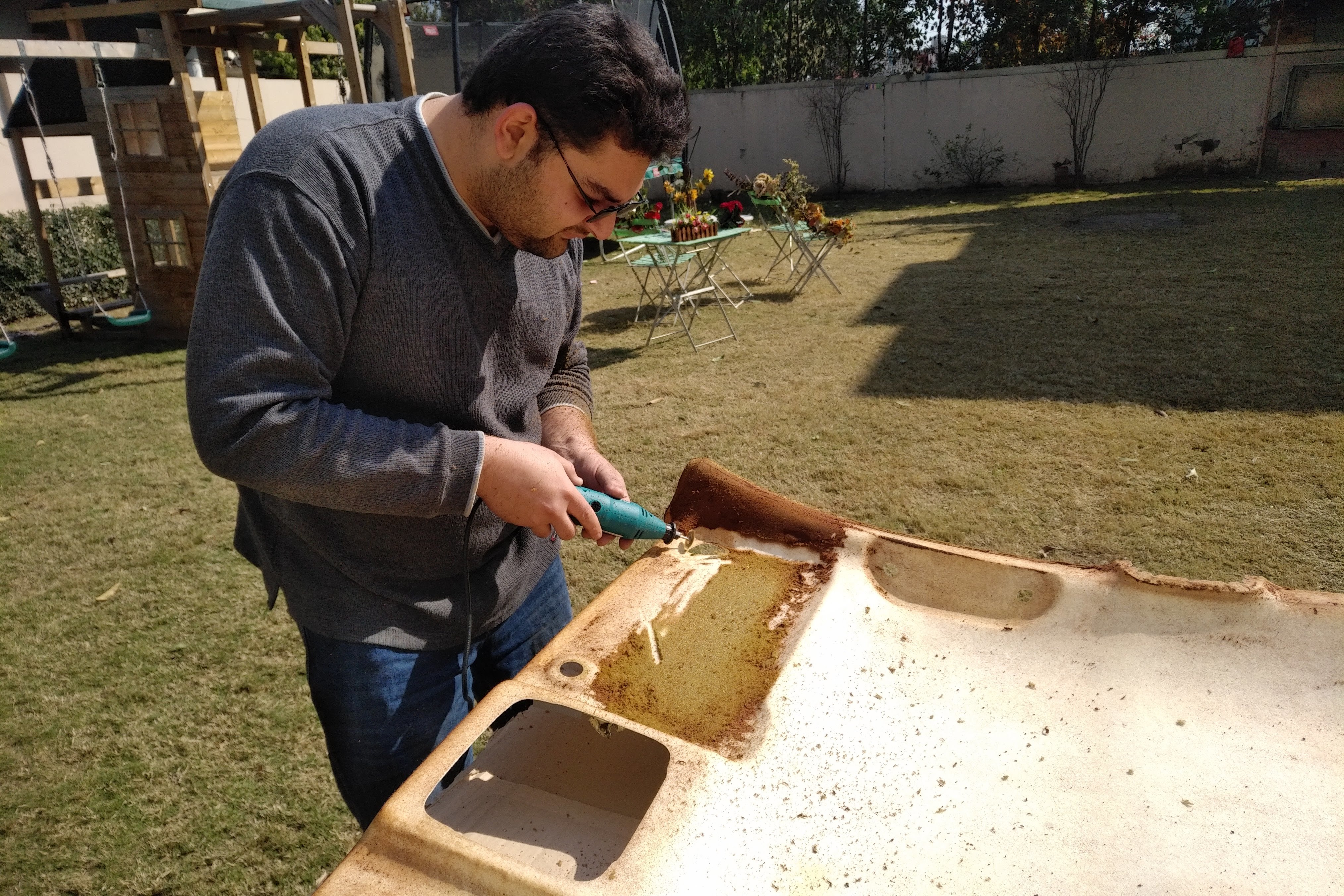

Using a dremel to remove leftover stuck foam

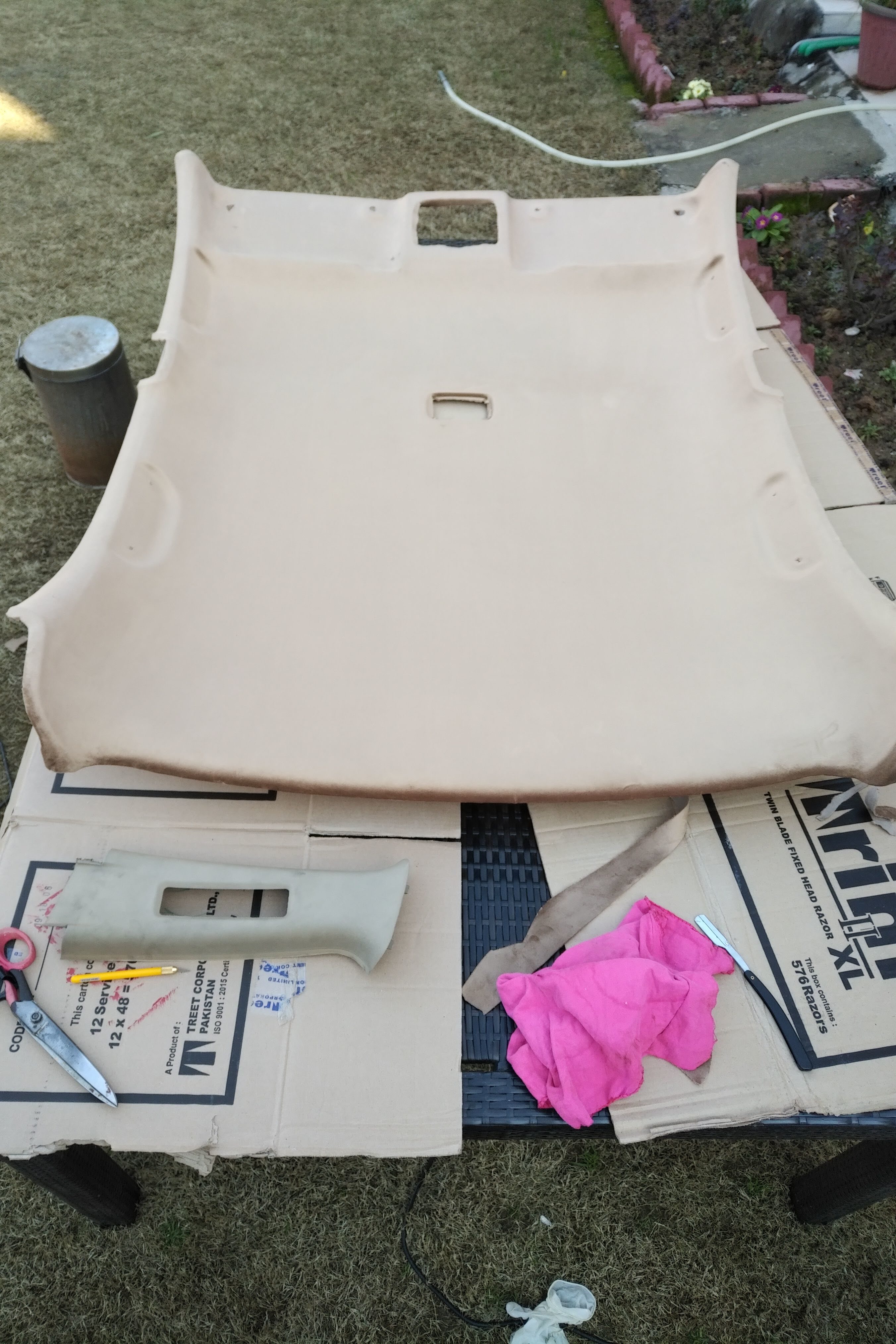

A clean headliner
Pakora break

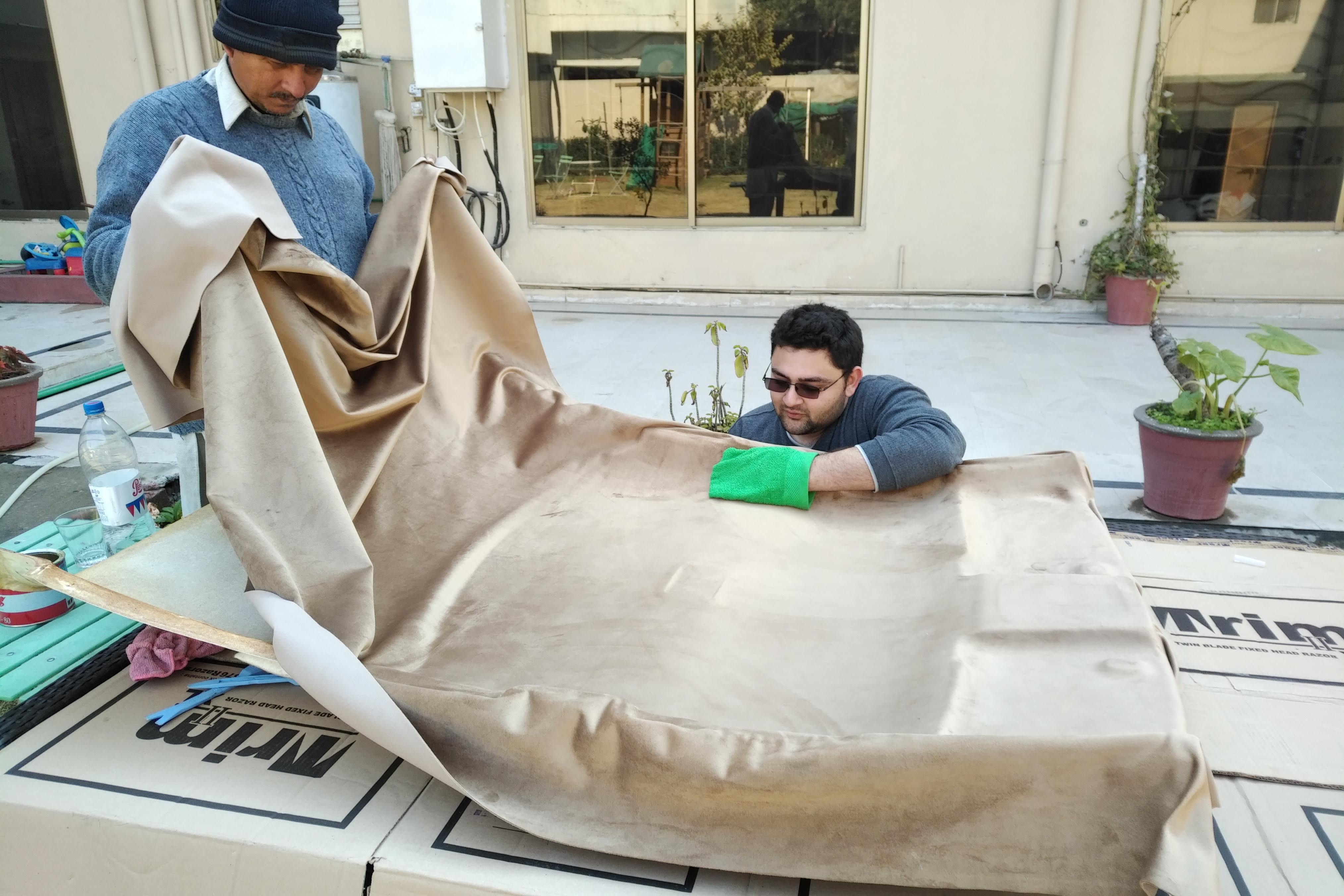

Installing the fabric
Complete

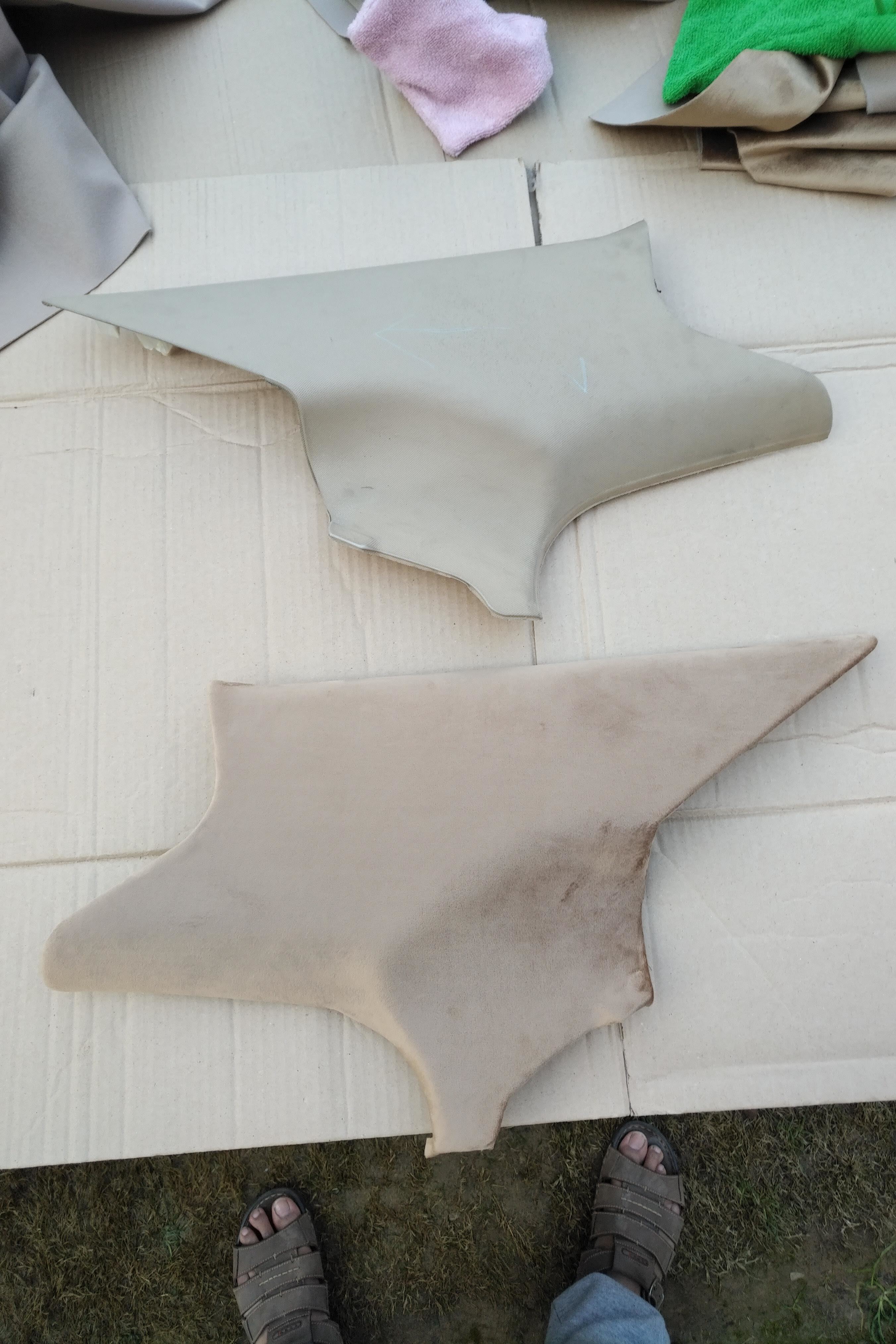

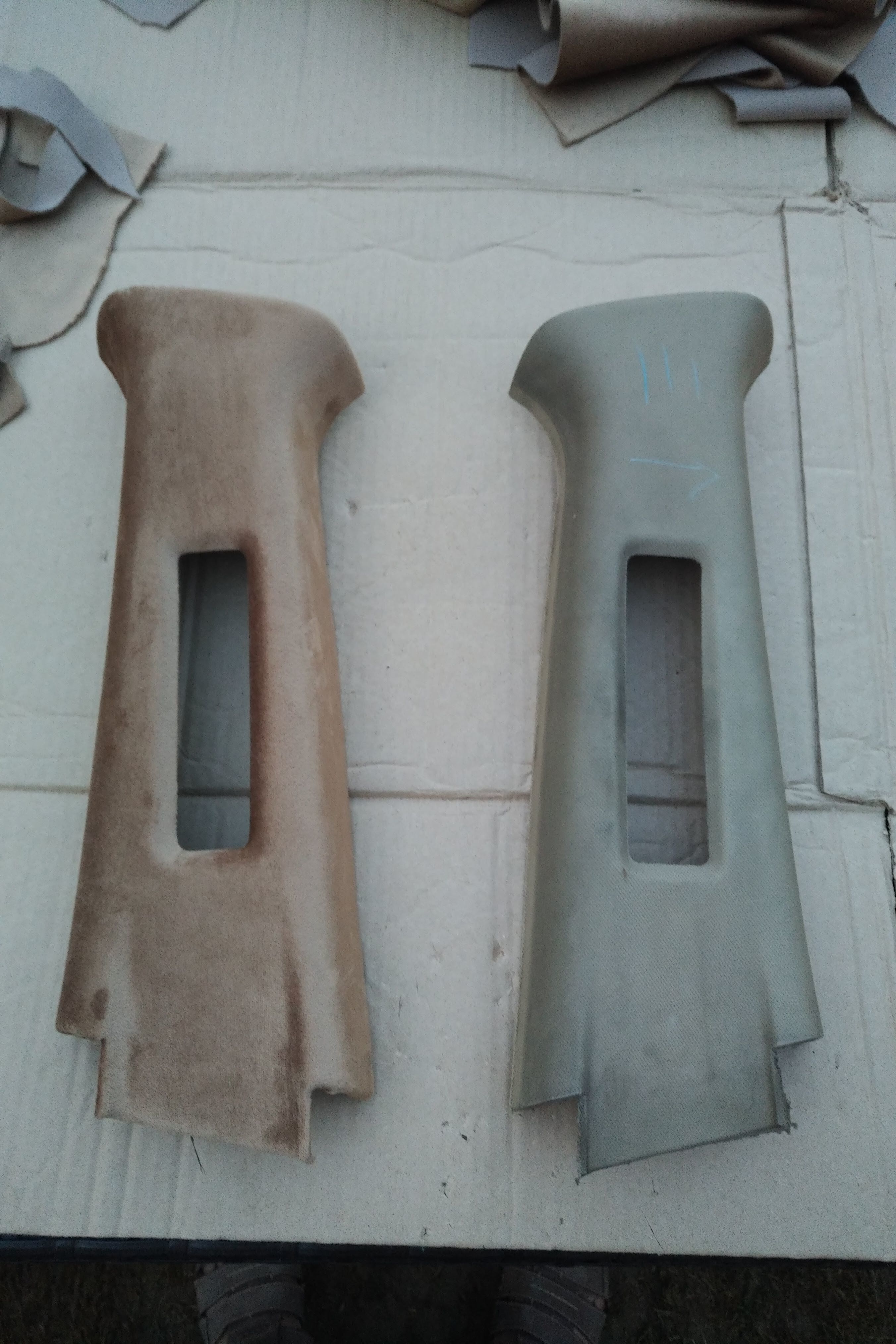

Before and After: Side Pillars

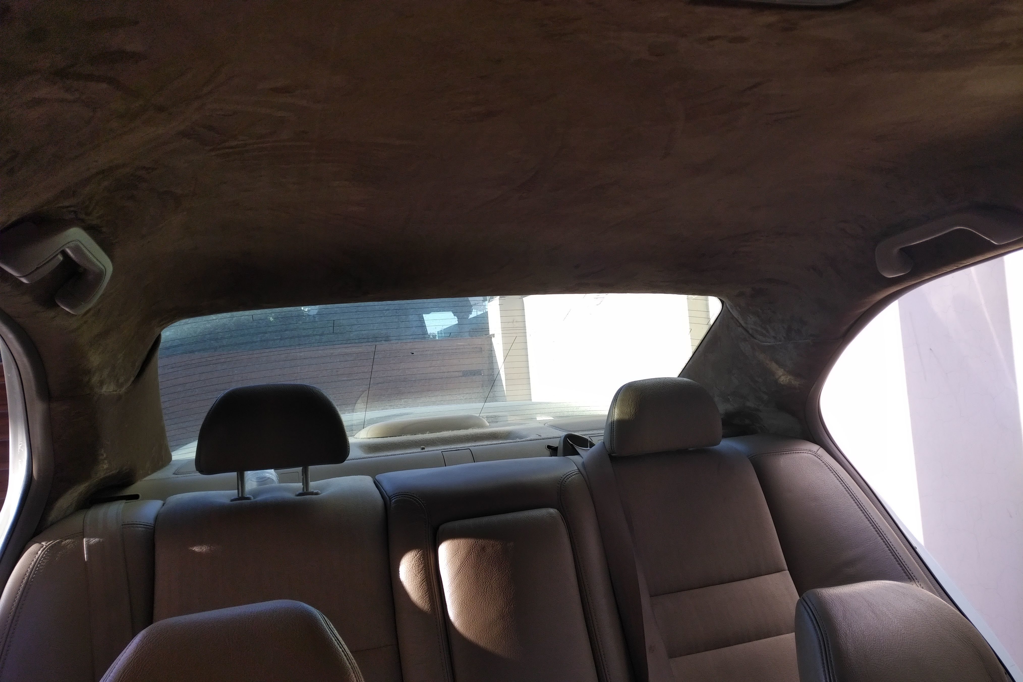

After installation in the car. Only B pillar trim is remaining to be installed.

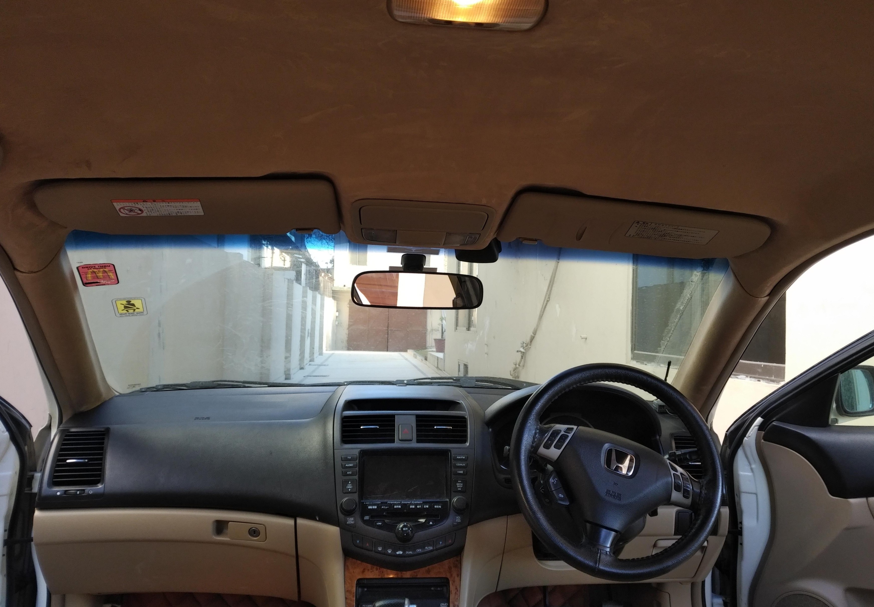

Headliner looks really good in person. Overall it was a good first experience. On a downside, on some places the headliner is not sticking. Air bubbles coming. We were extremely careful with the fabric installation and used sufficient adhesive. Still trying to figure out why on some small areas its not sticking while on others the fabric is sticking fine. We will be using a heat gun to try to re-stick the fabric where air bubbles developed or redo the headliner once it falls down again. Next time with some stronger adhesive.
