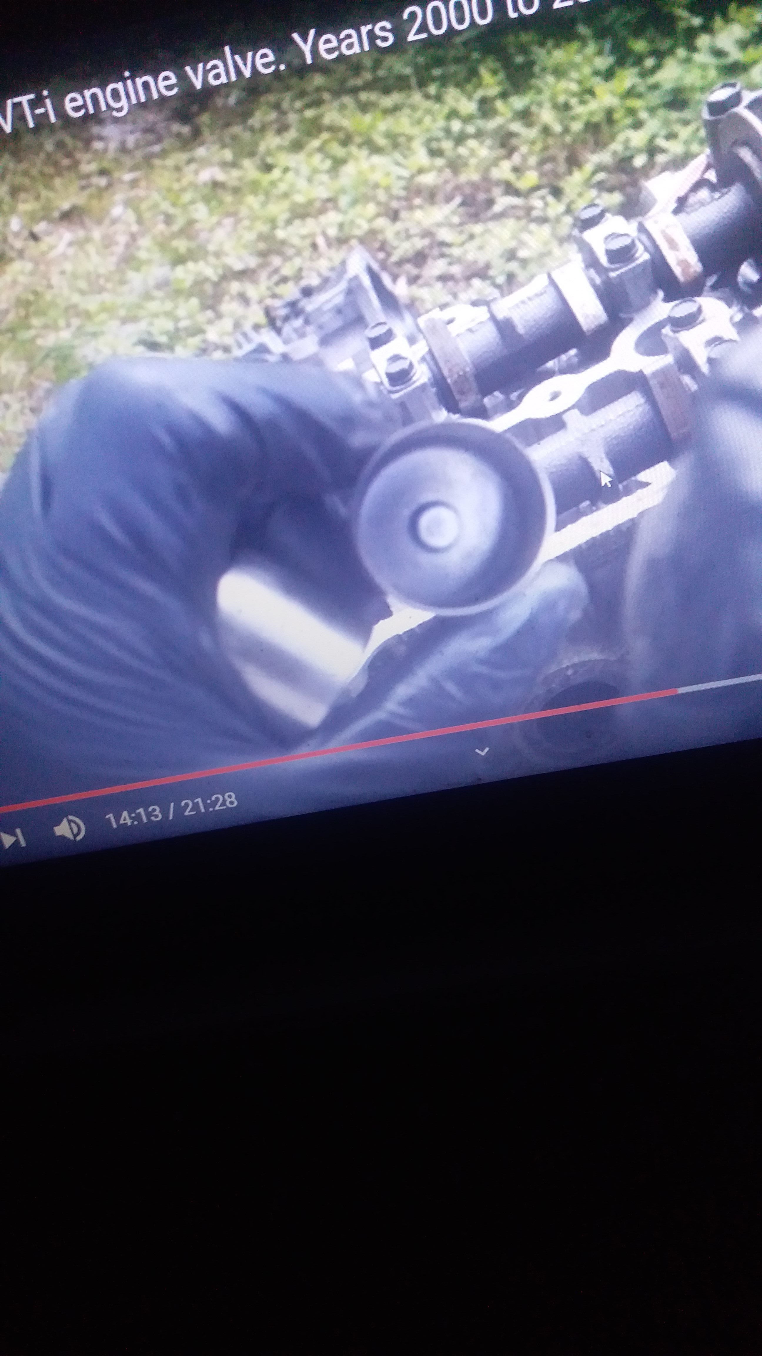

Why would they grind the valve itself and not the stem?
Also if the clearance was out of spec, isn't there any replaceable shim on the bucket or the whole bucket has to be swapped out?
yes this is bucket aka dabbo in local lingo

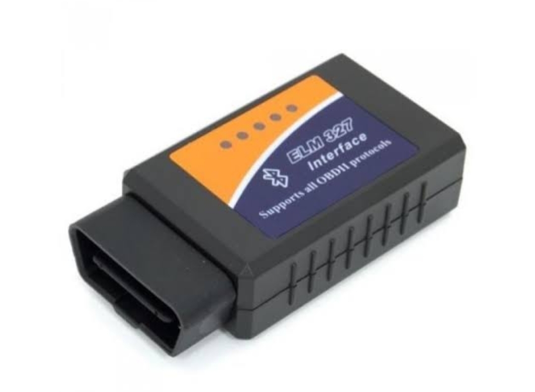

Recently bought this cheap OBD-II Bluetooth Connector.
Now as far as dtc search/live data for newer cars is concerned this little thing works perfectly just like any other scanner out there. But on my 00' HDJ101 firstly it takes to long to select the correct protocol and even after selecting one(from a list 46) it simply refuses to connect. The ELM connects quickly as soon as the the Torque Pro is opened but ECU connection fails.I've read it somewhere on ih8mud that the diesel 100 Series had a M-OBD interface rather than the standard OBD-II (though the dlc port is the usual 16 pin with connections at the following points 4 5 7 9 13 14 16) Any help?@Xulfiqar
If you have a japanese domestic market car - it will probably be toyotas own weird Multiplex OBD. and that wont work with the ELM chip.
which means I'll have to go for a professional scantool. right?
try sz viewer on PC, it usually made the ELM connect to jobd aswell in some cases
if that fails, then you can get the pro tool if yes, you should still get the pro tool
