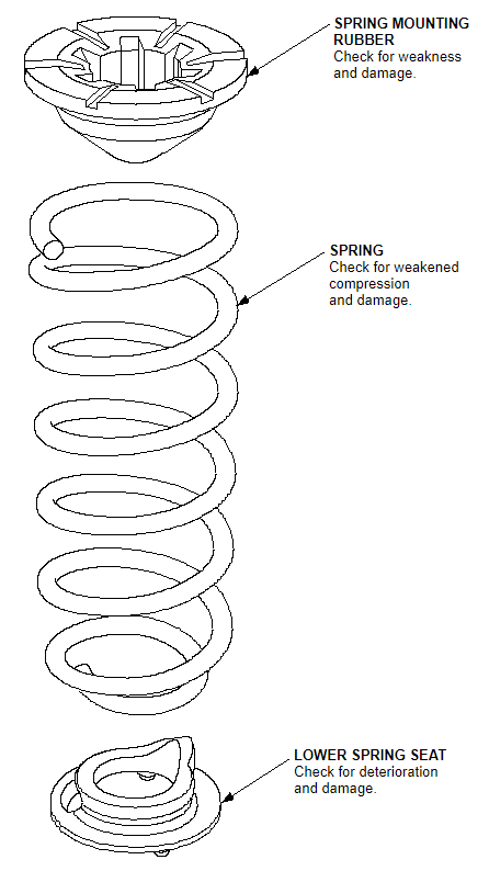

He installed it infront of me & the picutre I took from the internet for reference. First he just put it on a jack (didn't remove the wheel), unbolted the Nutt (Number 1 Blue), took out the coil spring and removed the spacer/packing (Number 2 Red), put the coil spring back while another dude stuck a rod somewhere and was pulling down the whole suspension. In the end he managed to slide the coil spring back in place like this no problem, but while the top rubber sit's perfectly (Number 4 Purple) the bottom rubber doesn't which is still only a 0.1inch difference at most (Number 3 Green).

Edit: I found this, so the top rubber on both sides is fine and mounted properly, the bottom one however slipped and aren't perfectly in line with the spring on both sides. Moreover, the guy told me that the rubber for the passanger side was a bit broken off. I'm wondering what if I remove it from both sides? Will that be acceptable?
