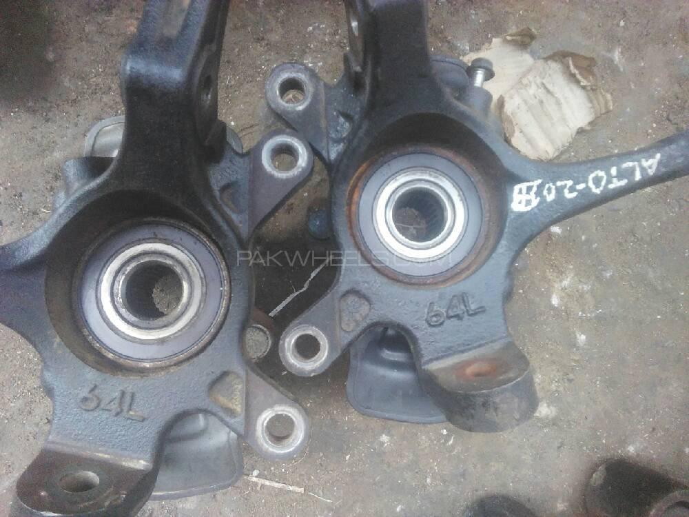

Does this vehicle have bolted on front wheel bearing units like you see in rear of corolla etc?
Or it has usual press in variety with hub pressed in center? (Most likely)
The pressing job is super easy with hydraulic press or even with power screw and receiver cups. The only catch nowadays maybe the abs tone ring embedded in bearing seal which requires operator of press to pay attention and install inwards.
I would suggest to find better mechanics, Not morons or simple part swappers.
I regularly change wheel bearings with powerscrew press, tell those google warriors that “amrika mein bhi bearing badli hota hai, poora spindle nahi”
