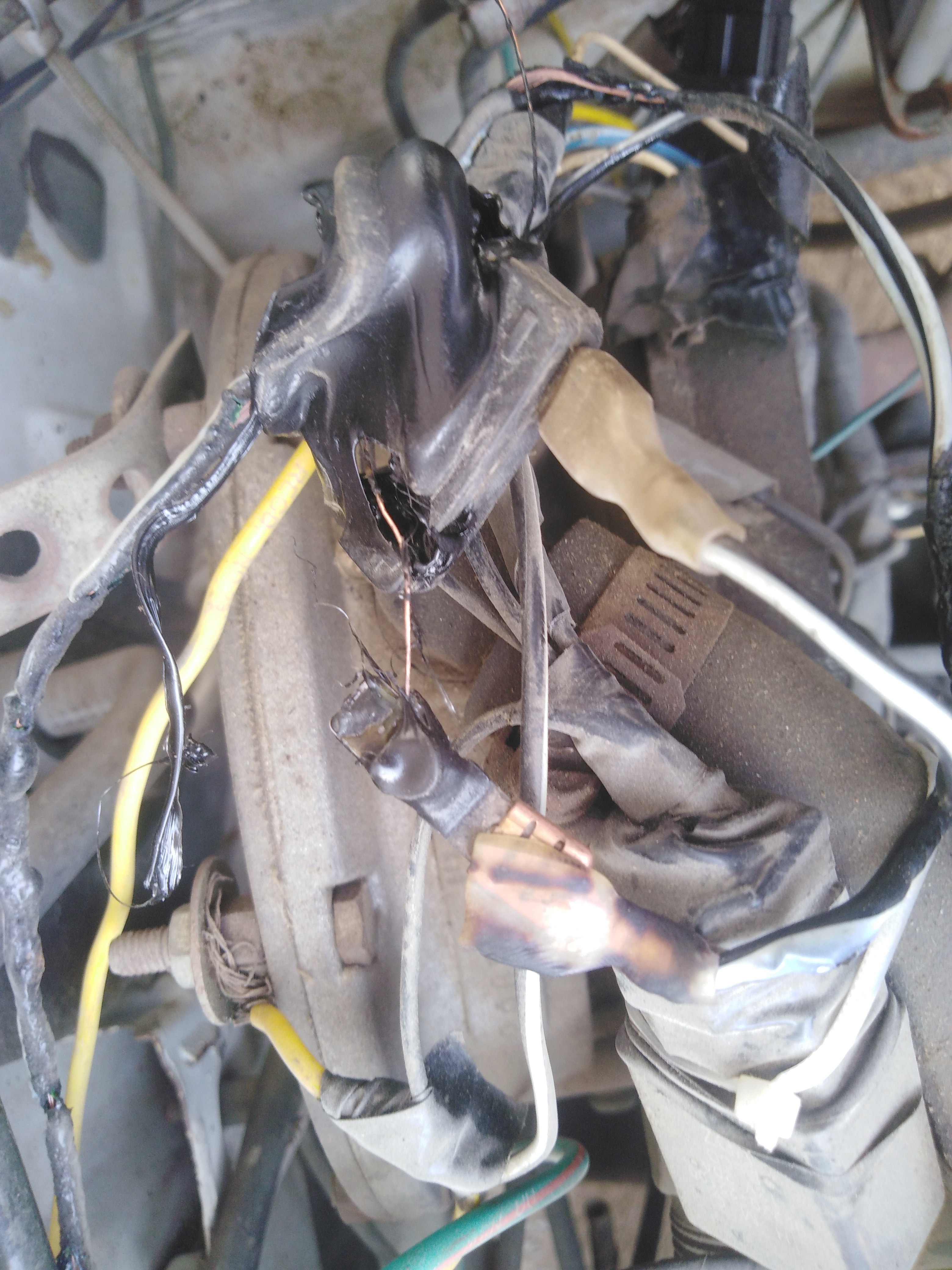

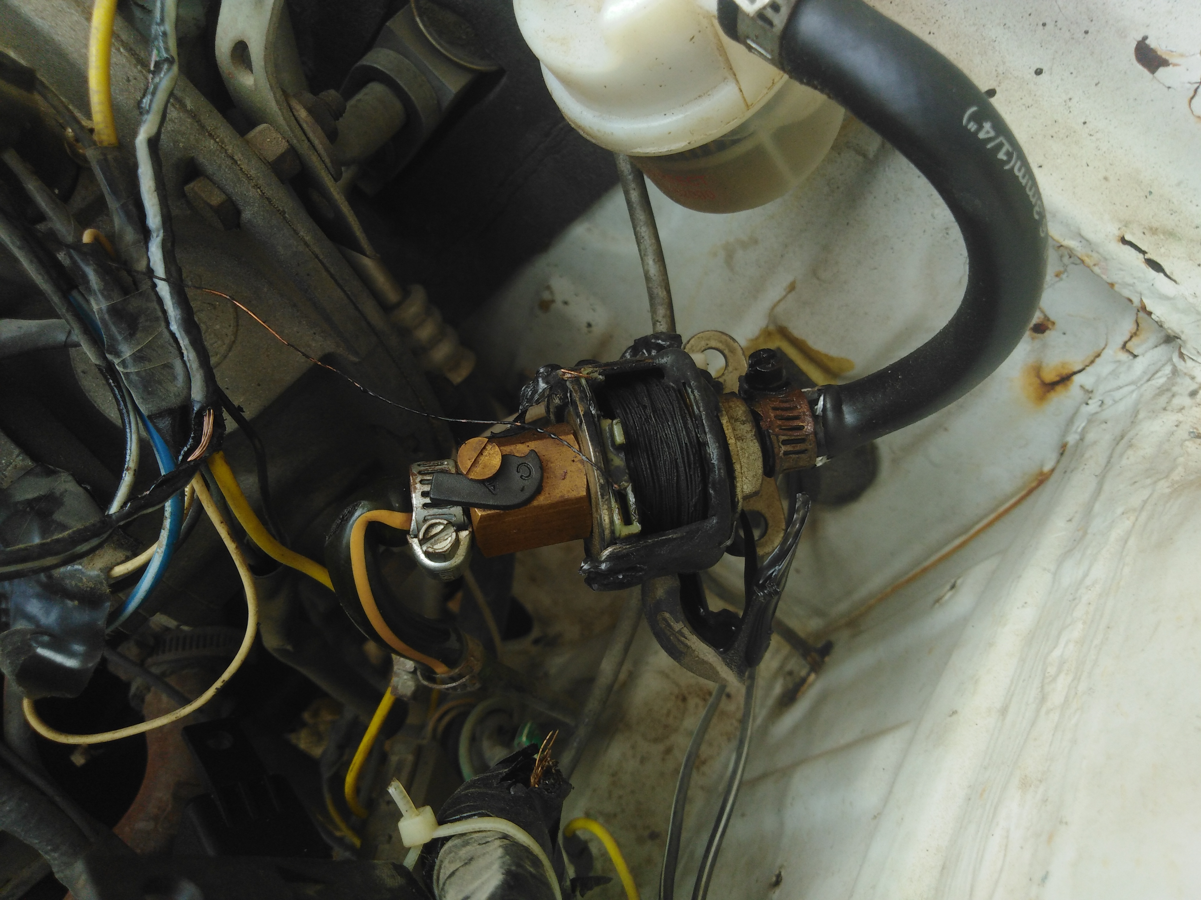

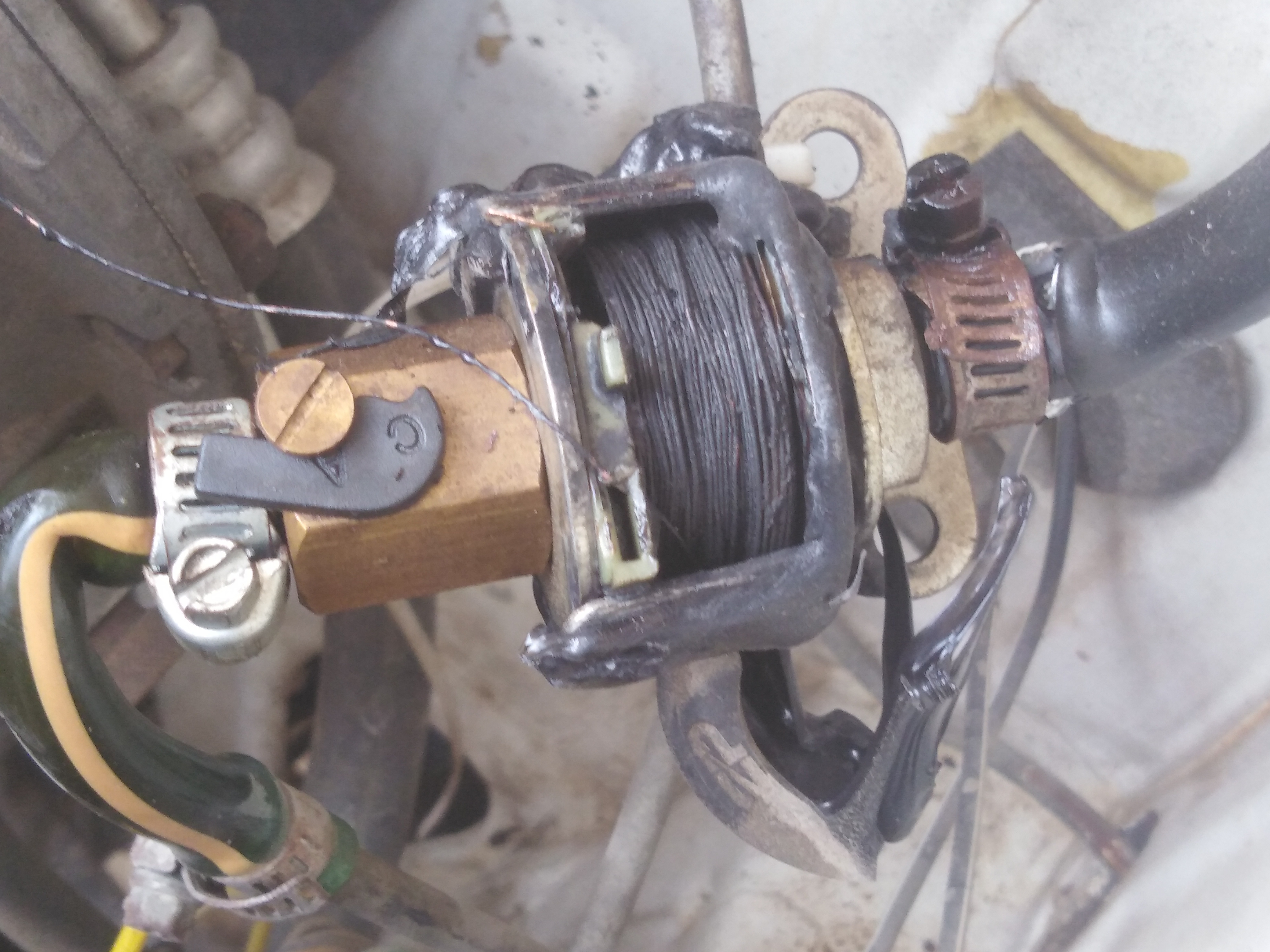

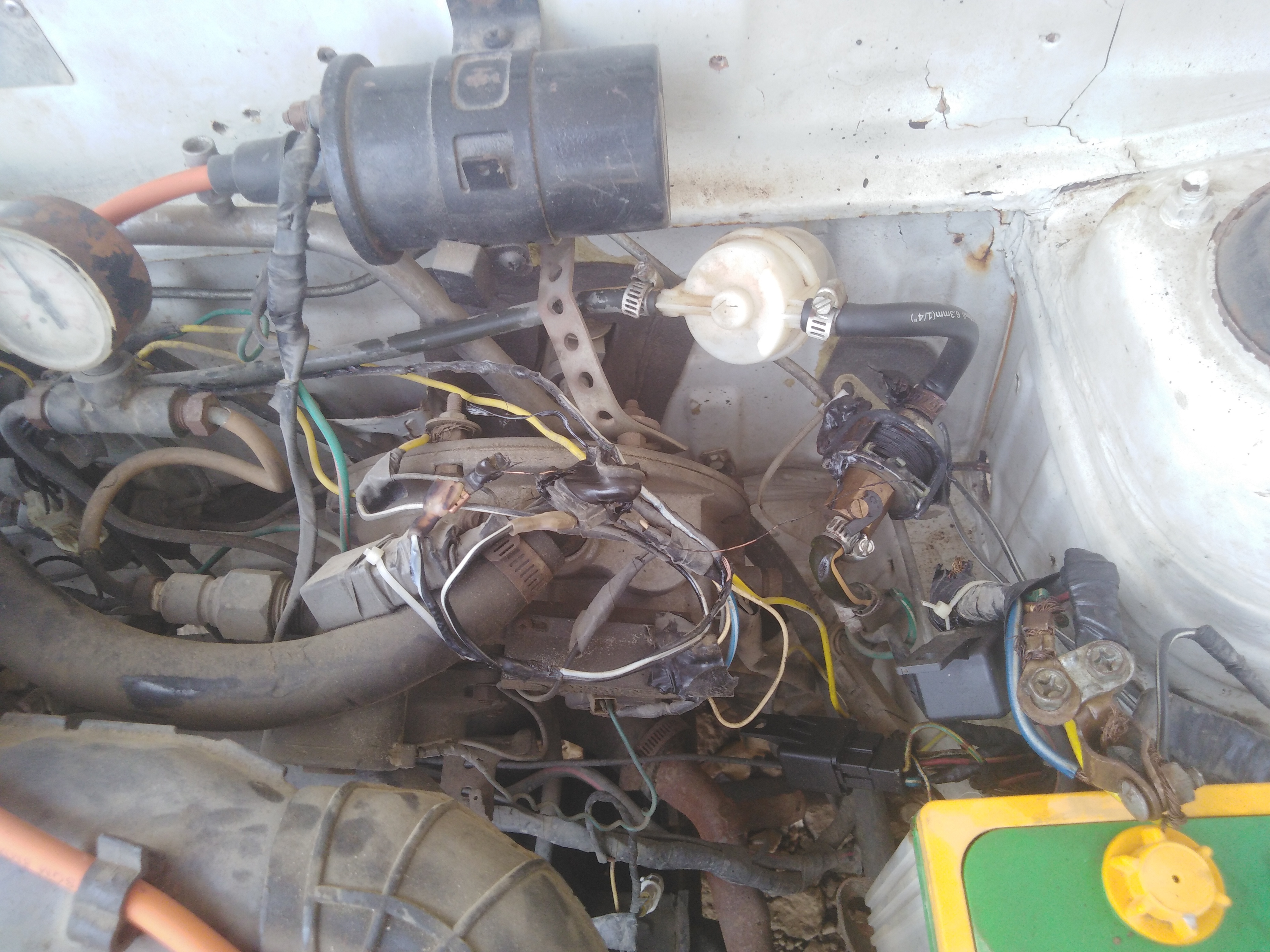

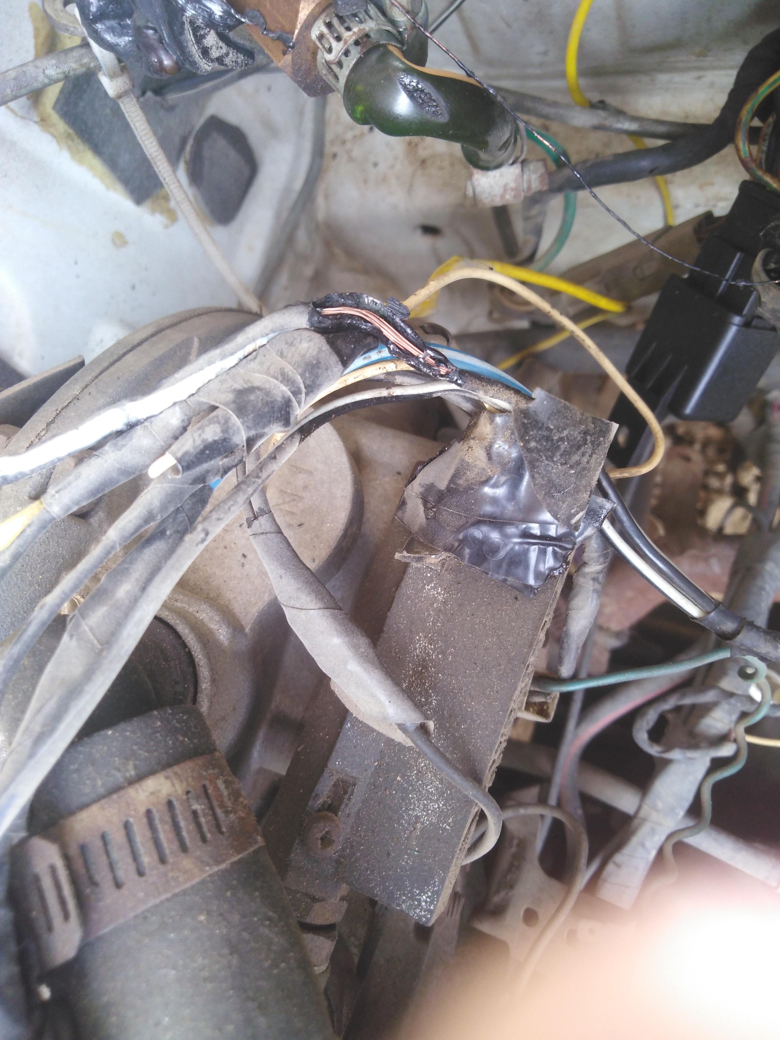

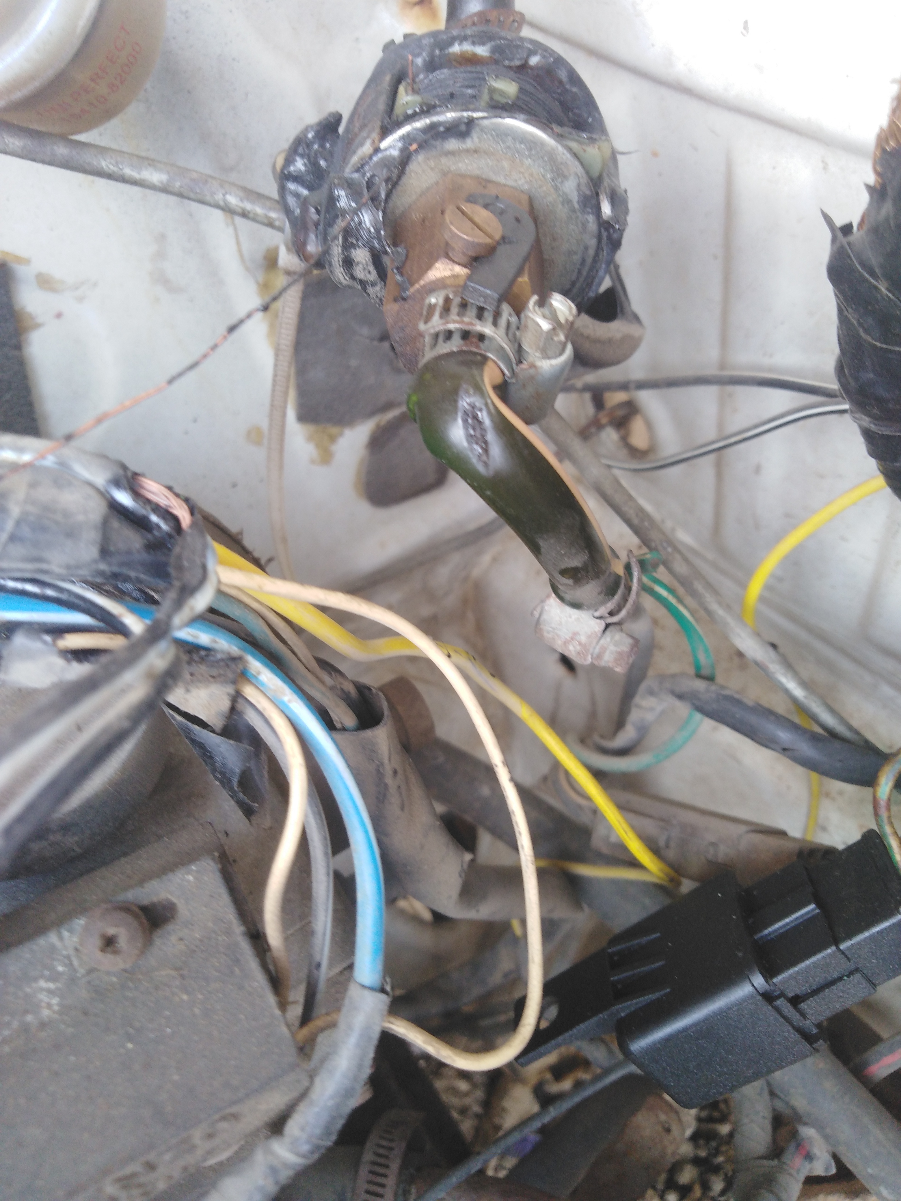

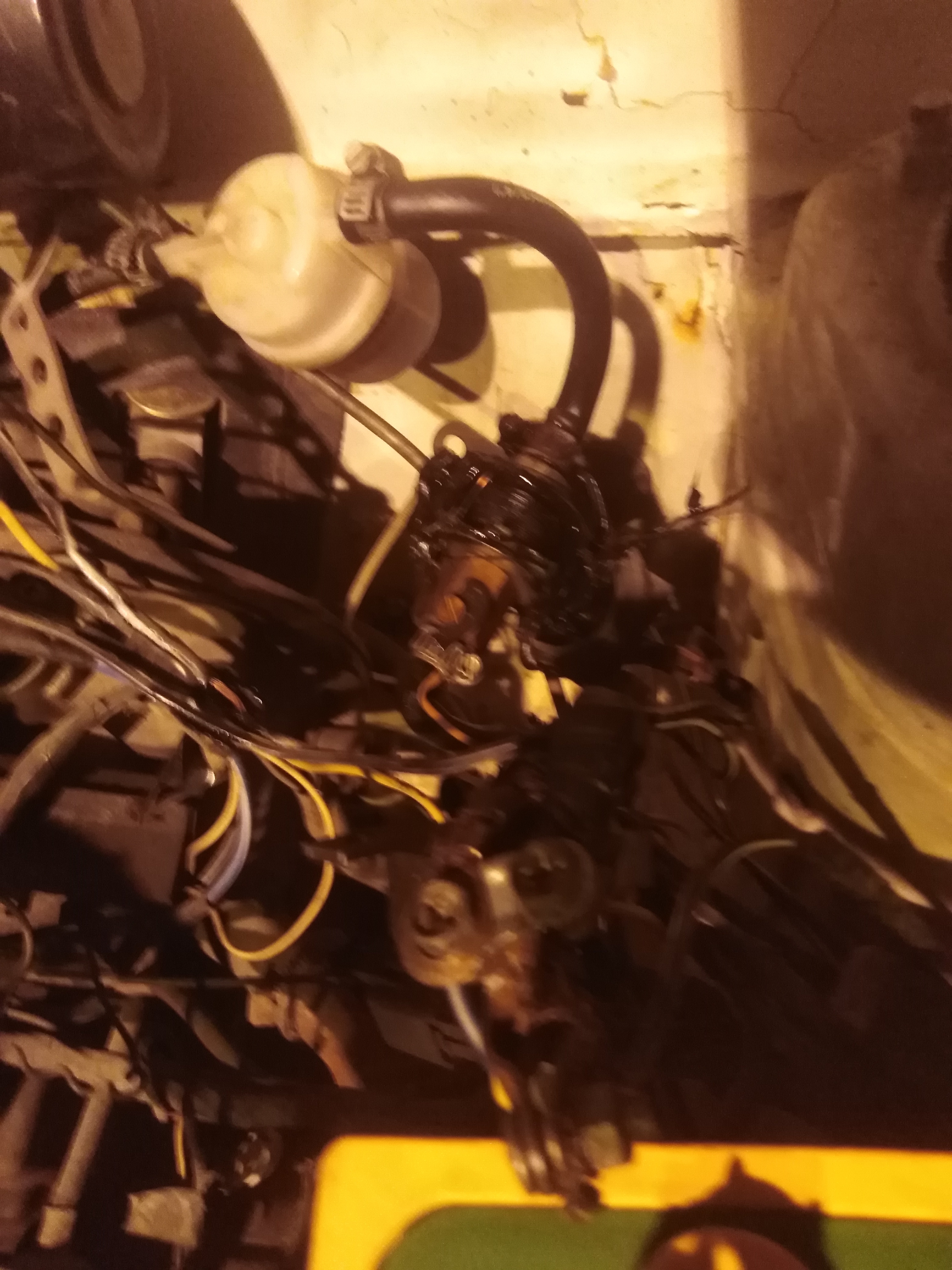

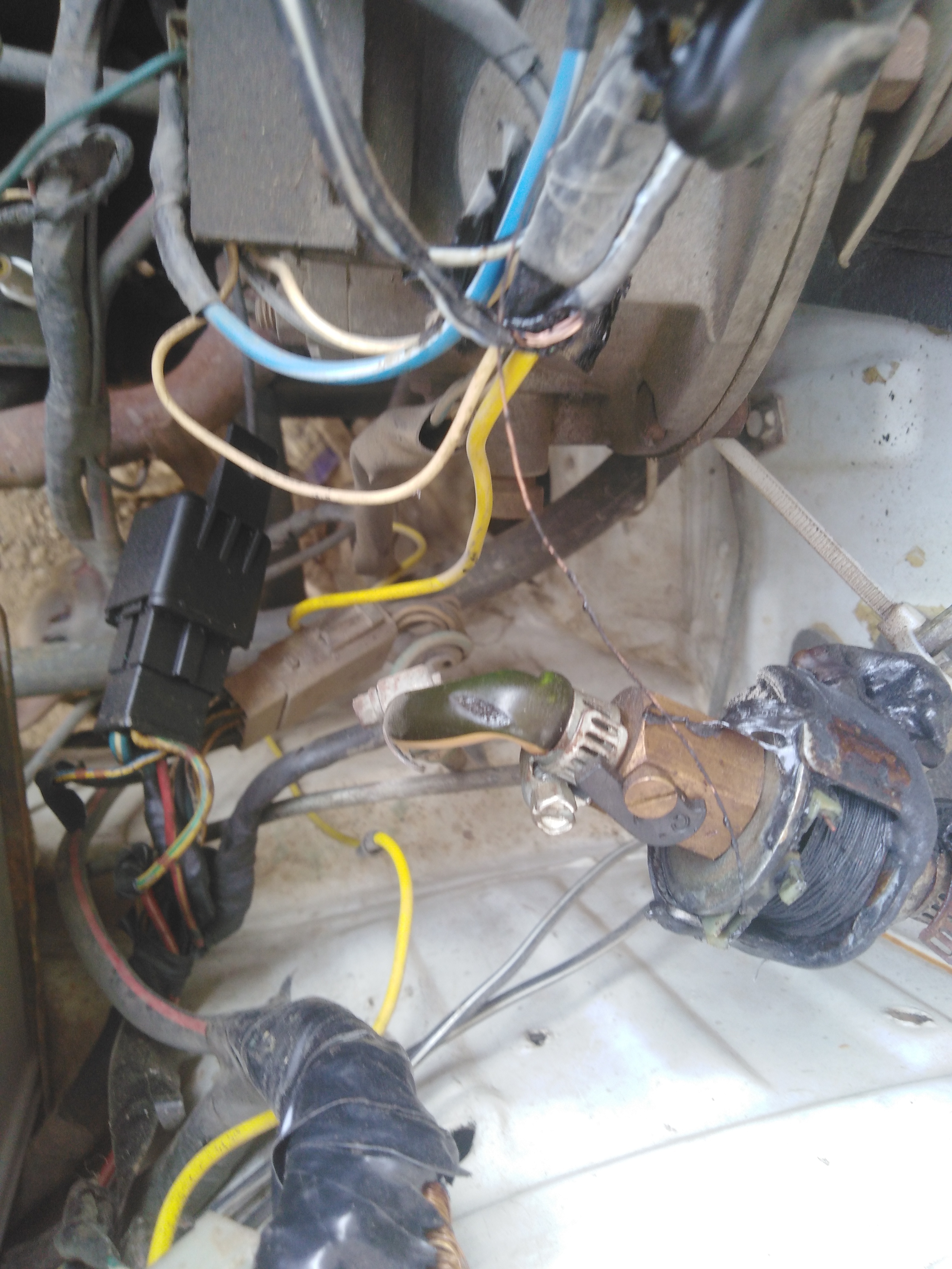

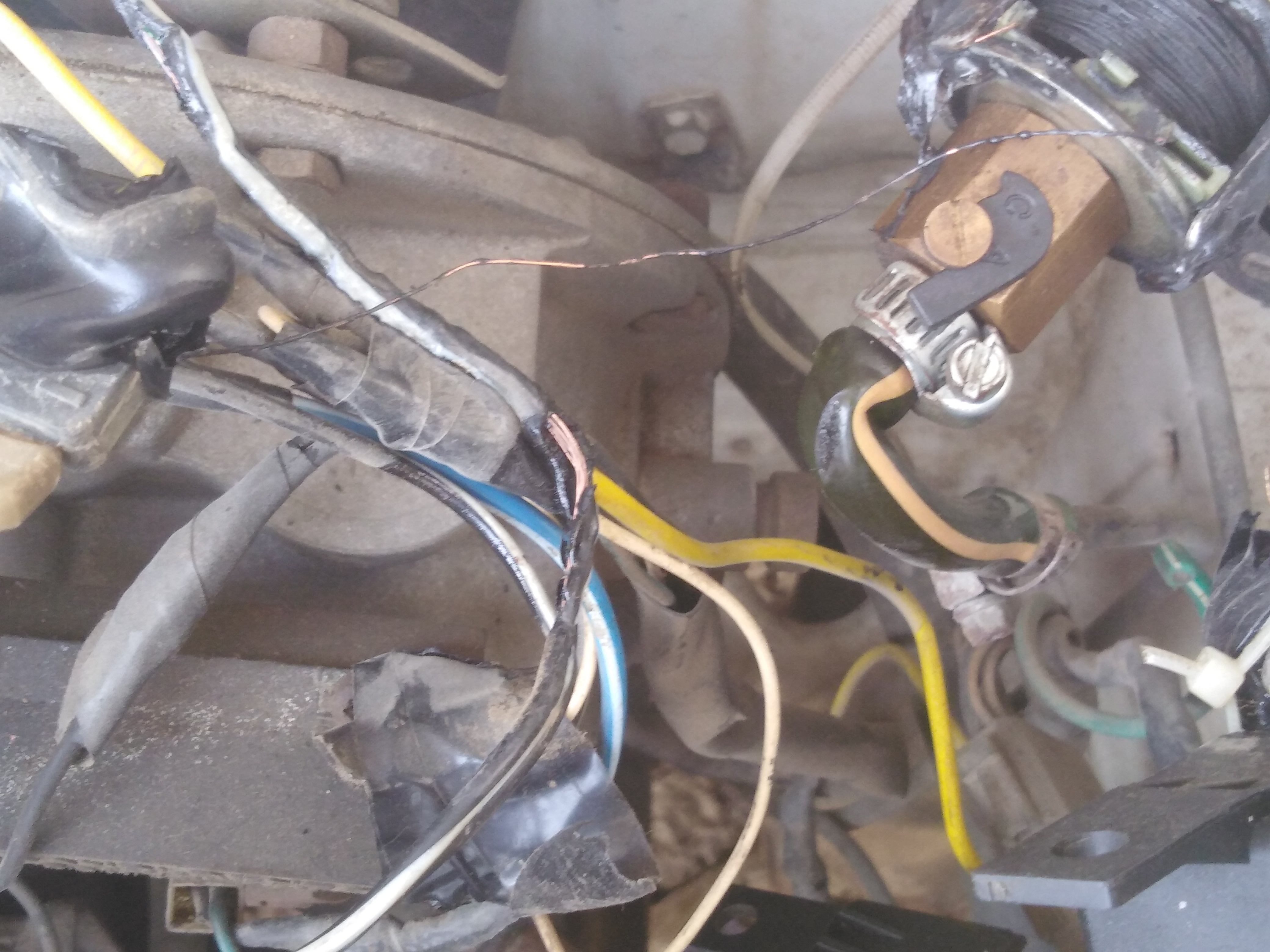

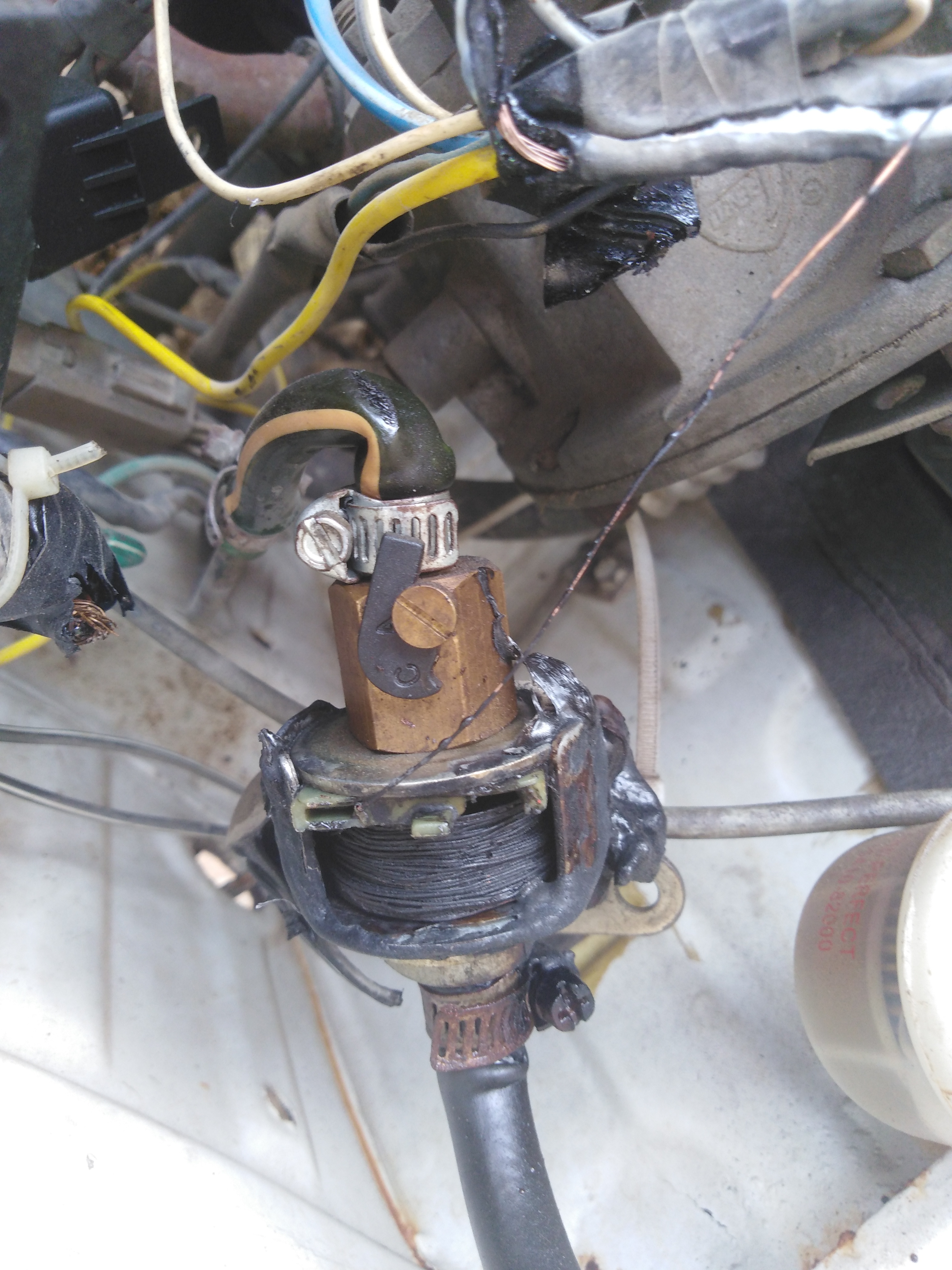

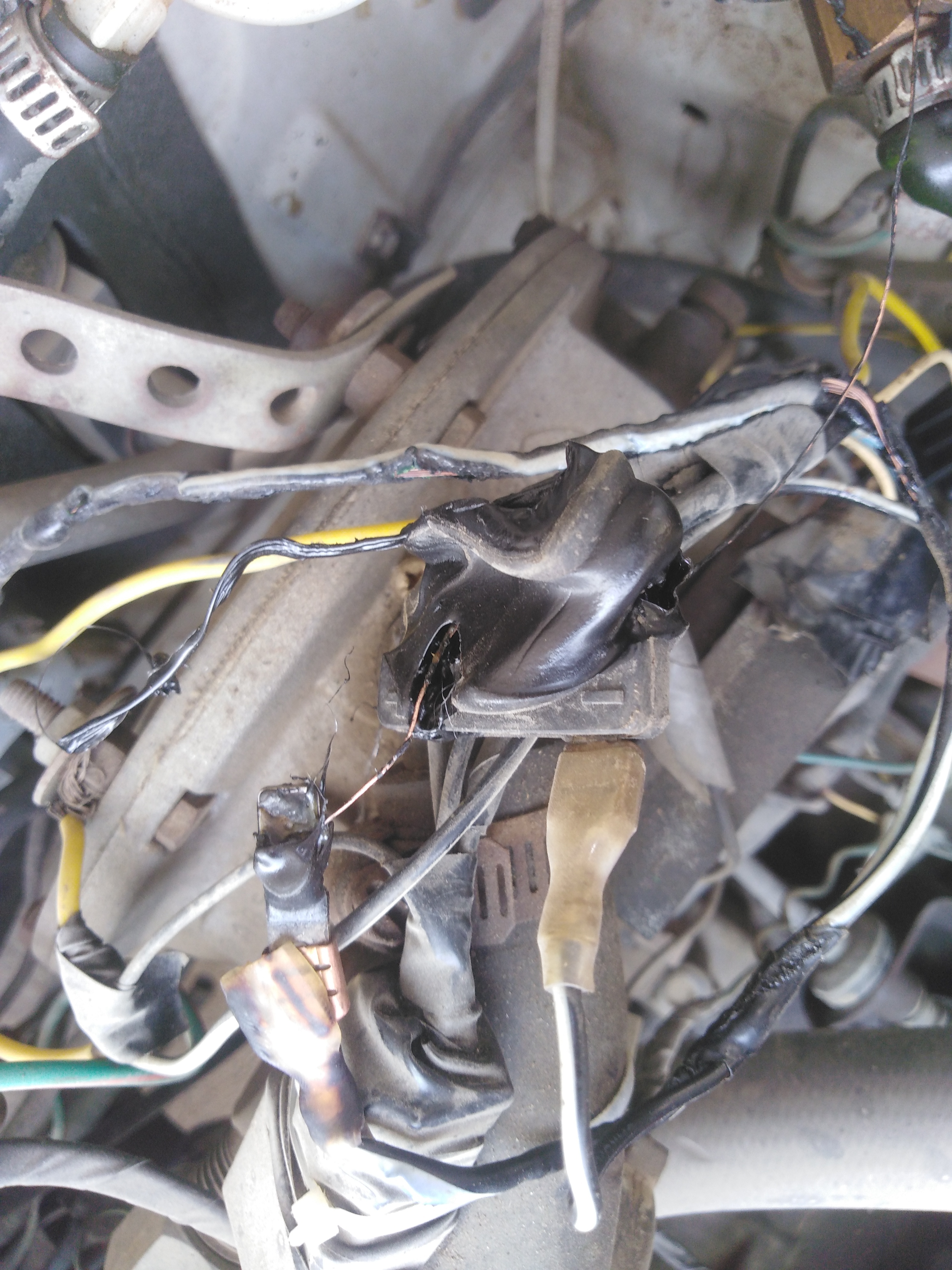

Today in night, when I was returning home, same symptoms came again & this time with severe burning smell and smoke. Suddenly car switched Off in 4th gear. When I opened bonnet, I saw cng/petrol cut-off switch/valve burning in smoke along with its wire connections & associated horn clips.Also petrol pipe attached to it was also burnt /damaged little so I disconnected battery terminals immediately to control burning/fire extent.
Now please guide me what to do now. Which parts to be checked? Note that all the time A/c was ON & I observed distributor little hotter
