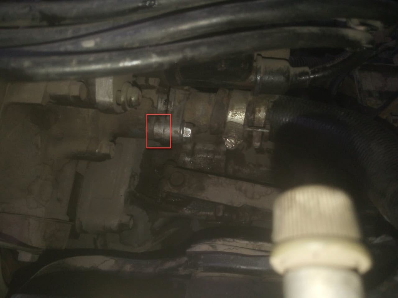

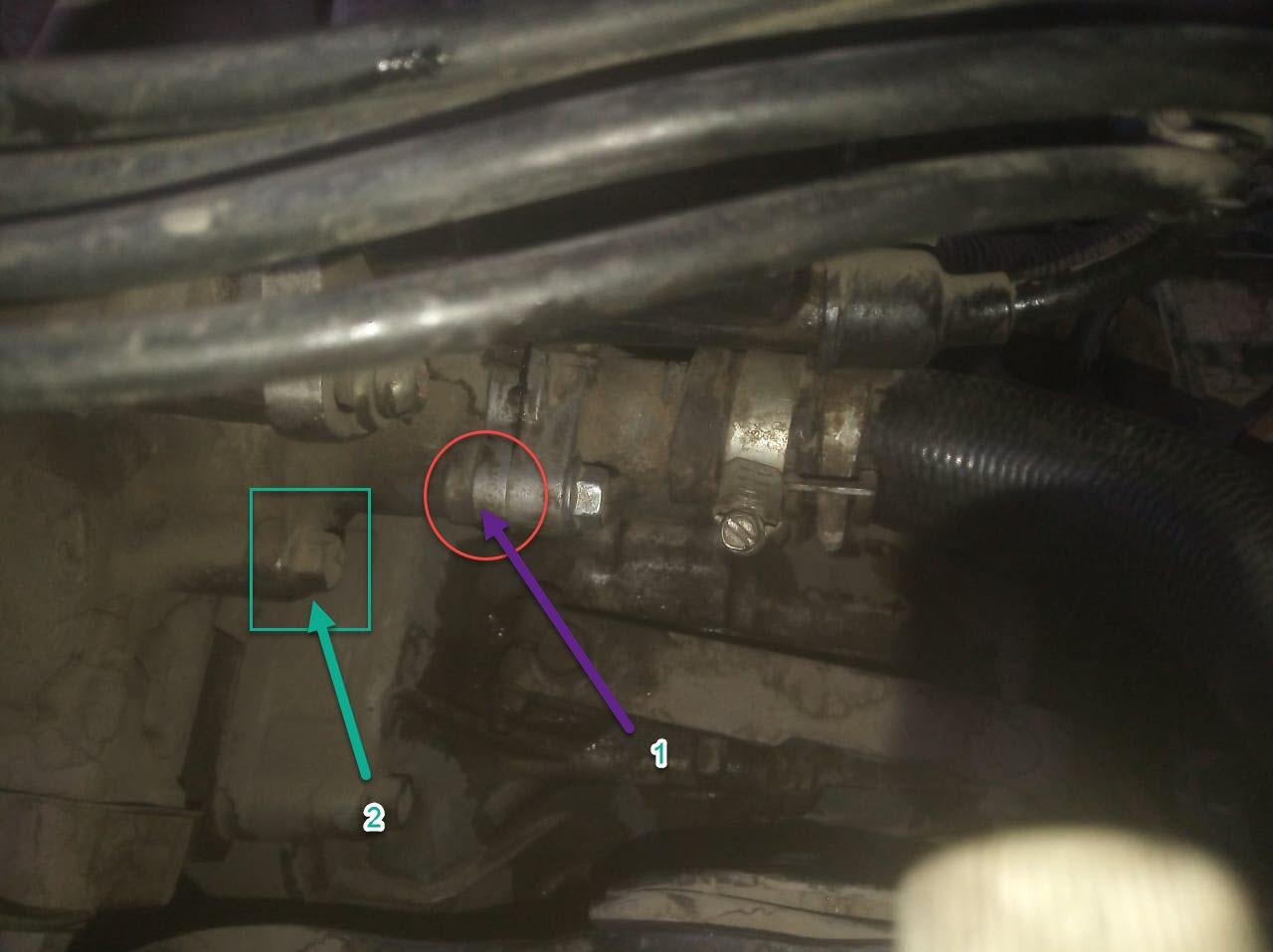

I broke the nut part where thermostat existed.
What is the workaround? Can we replace the part between 1 and 2?
Thanks
yes
Circle part is broken from otherside of nut.
any mechanic can remove the part,. after disconnecting battery and spot welding an extended nut to unbolt from the broken section

Don't you thing it's better to buy new one? What you say?
buy new one only if damaged, in any case bolt need to be removed through the process
It's the nut part that is broken. Used a epoxy and gasket glue. Tomorrow morning will put distilled water to check the leakage.
