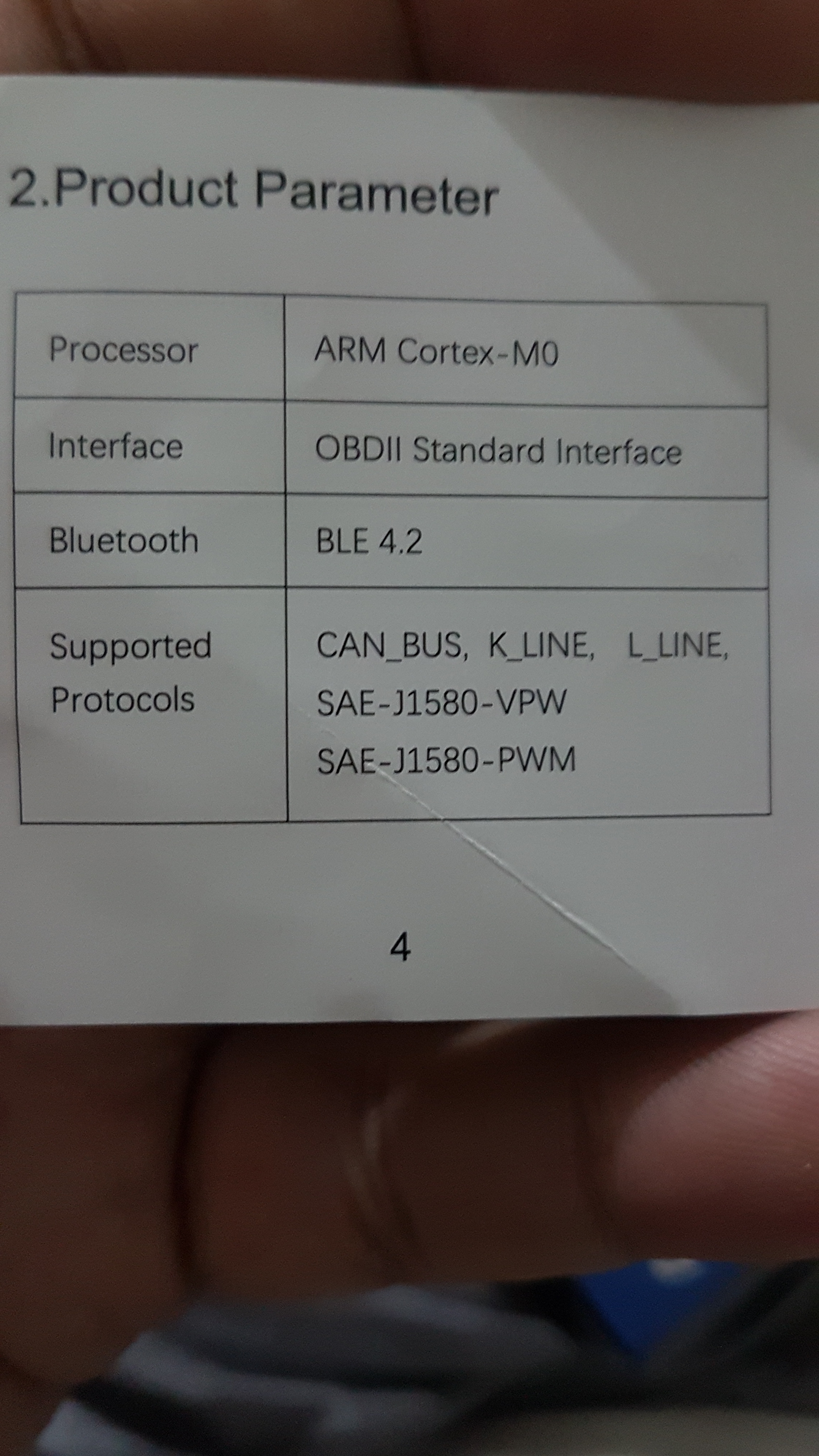

Aoa. I want to know that which obd protocol pak suzuki uses. I want to buy OBD scanner . Tried 2-3 scanner but did not work. Anyone knows plz tell. For cultus 2019 model. Sample of few protocols mentioned by a device.
@Xulfiqar sir if you can help..
I have share it on different threadsTry elm327 with PIC18f25k80 microcontroller.
If you get a launch scanner, you have to get the software updated for it to work on pak Suzuki cars. It's easily done in the market
Any protocol info? Kun k normally supported protocols likhy hoty han device k sath on Ali express

Keeping it short.Pic controller is good for k line suzuki initialization. But has less CAN bus initialization settings. It's 1.4v.Other Elm327 available which will be 2.1v good with Can bus protocols. But slow K-line initialization is not programmed in it.
So o should search for 1.4 version of obd device?? Mostly controller is not mentioned on packing or in specifocations
1.4 is firmware version. Don't fall for 1.5 version written on the casing there's no 1.5 version firmware ever made for elm327.Pic controller will be mention that would help differentiate.
