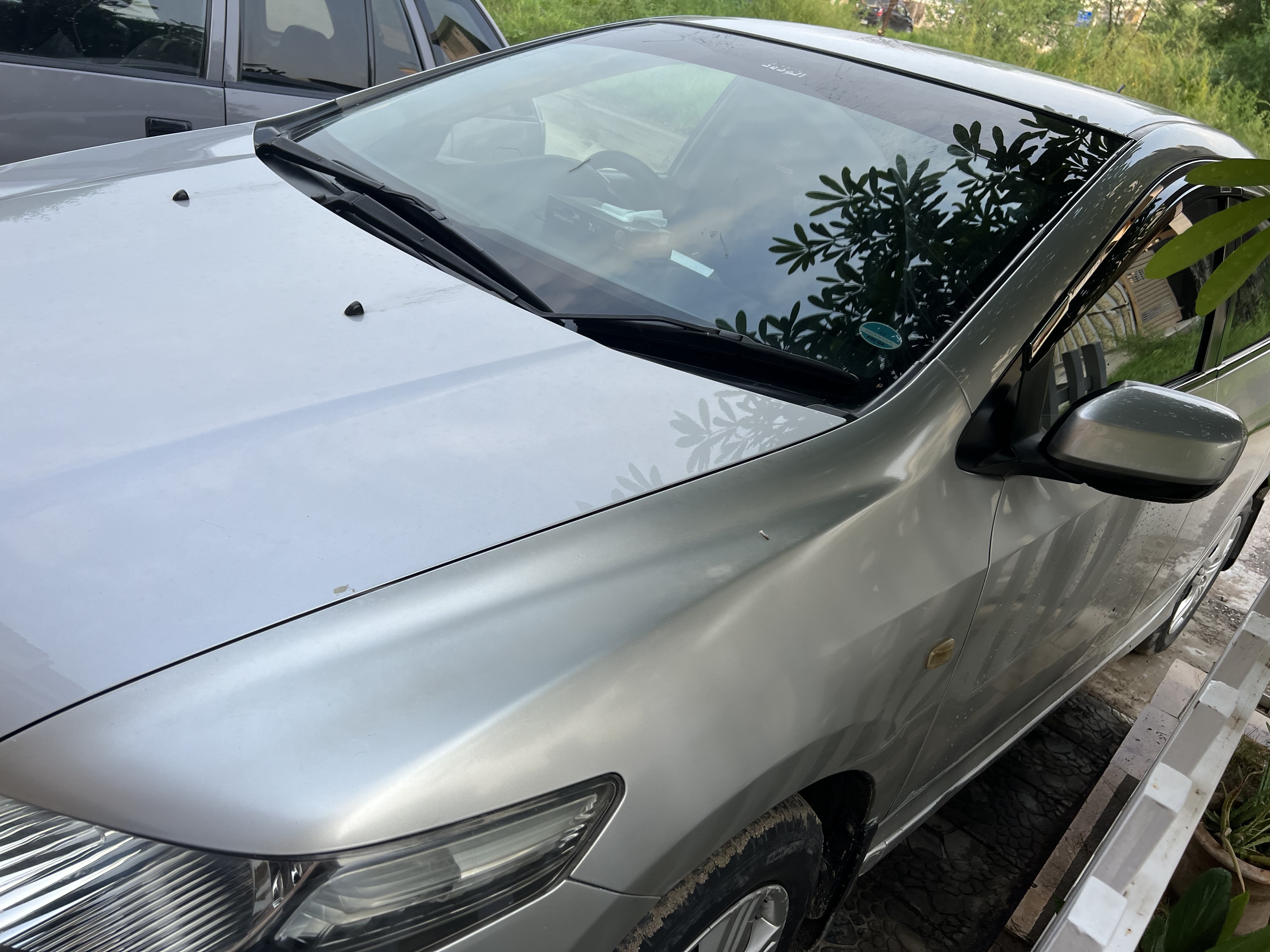

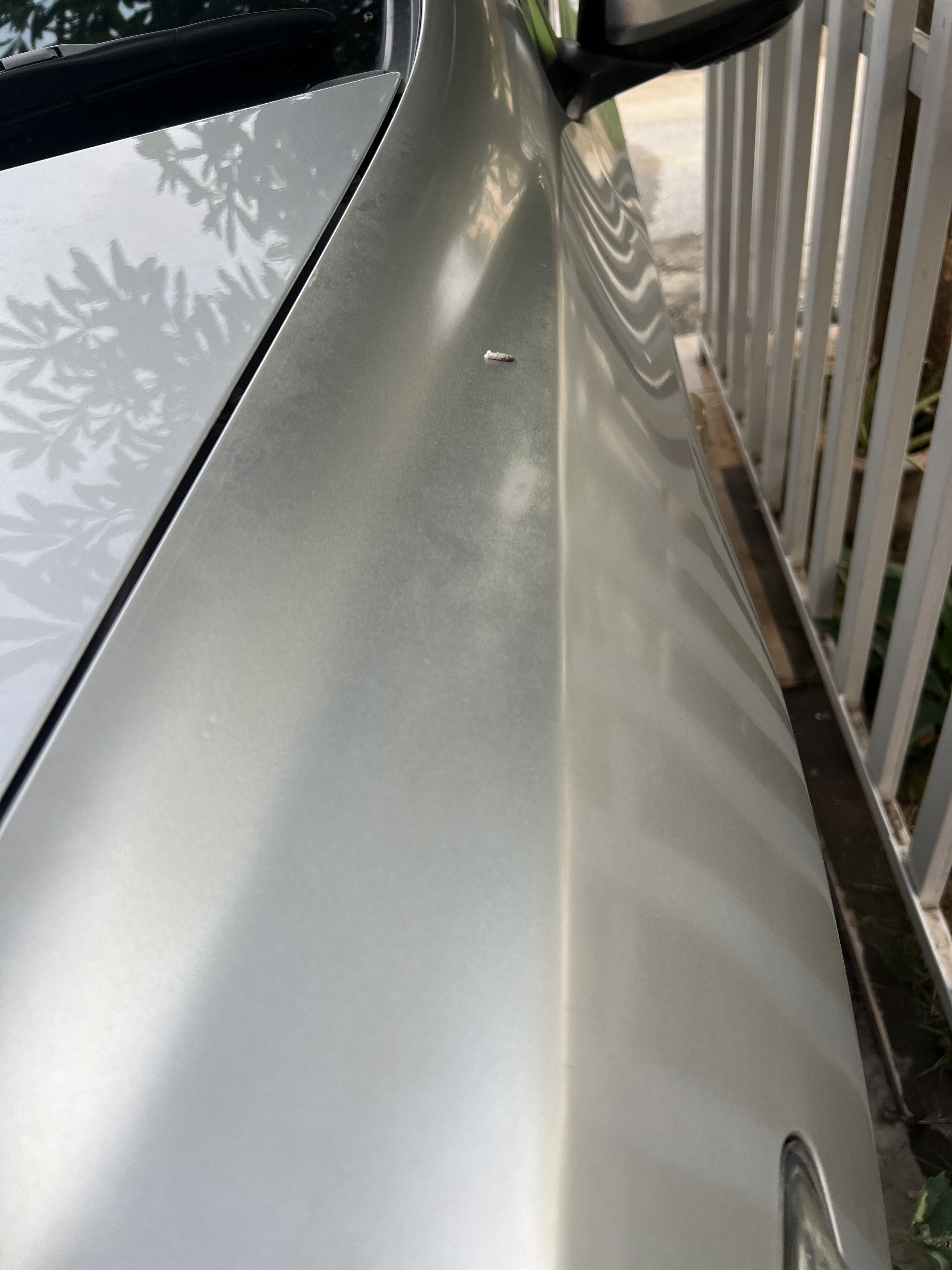

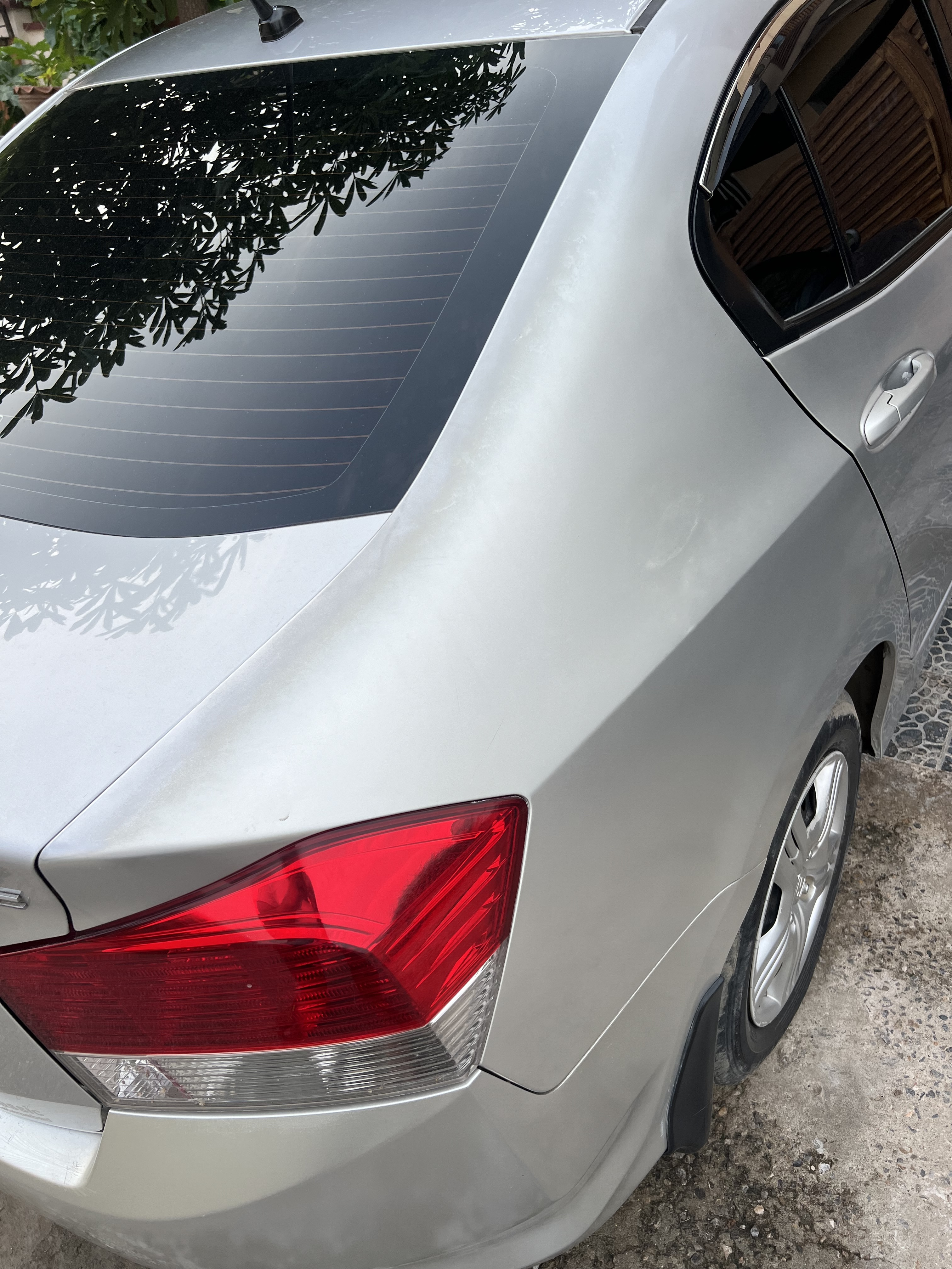

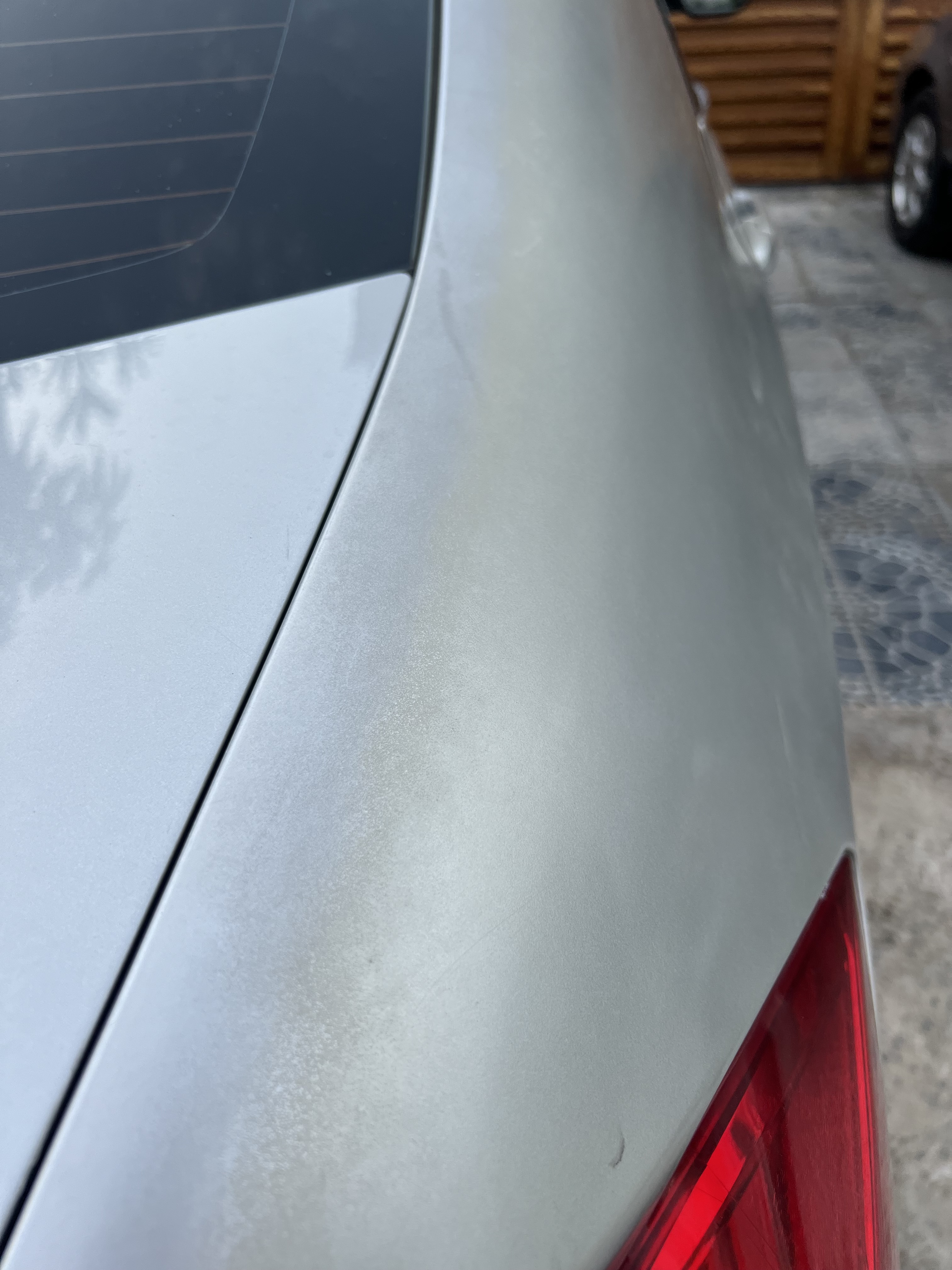

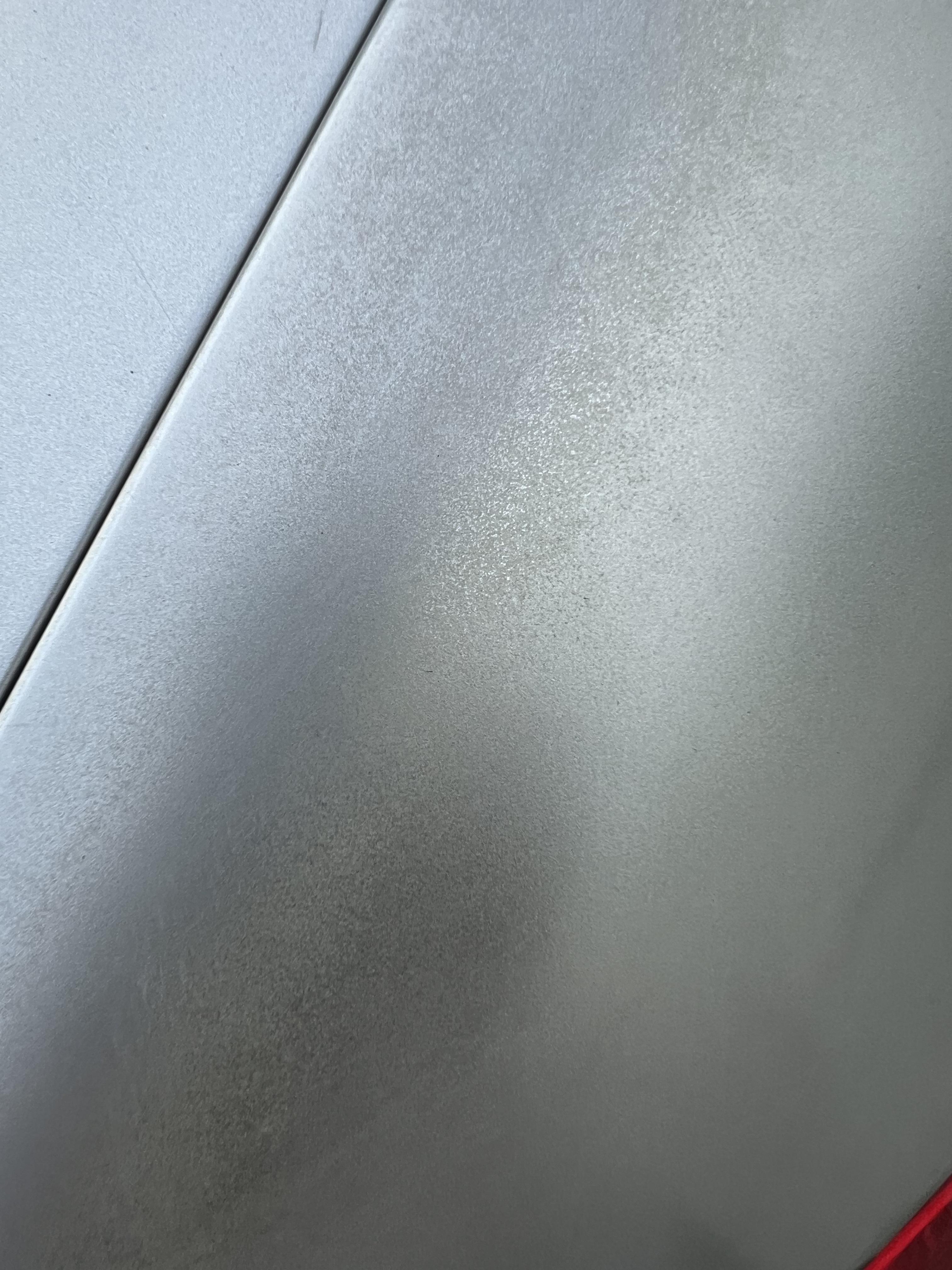

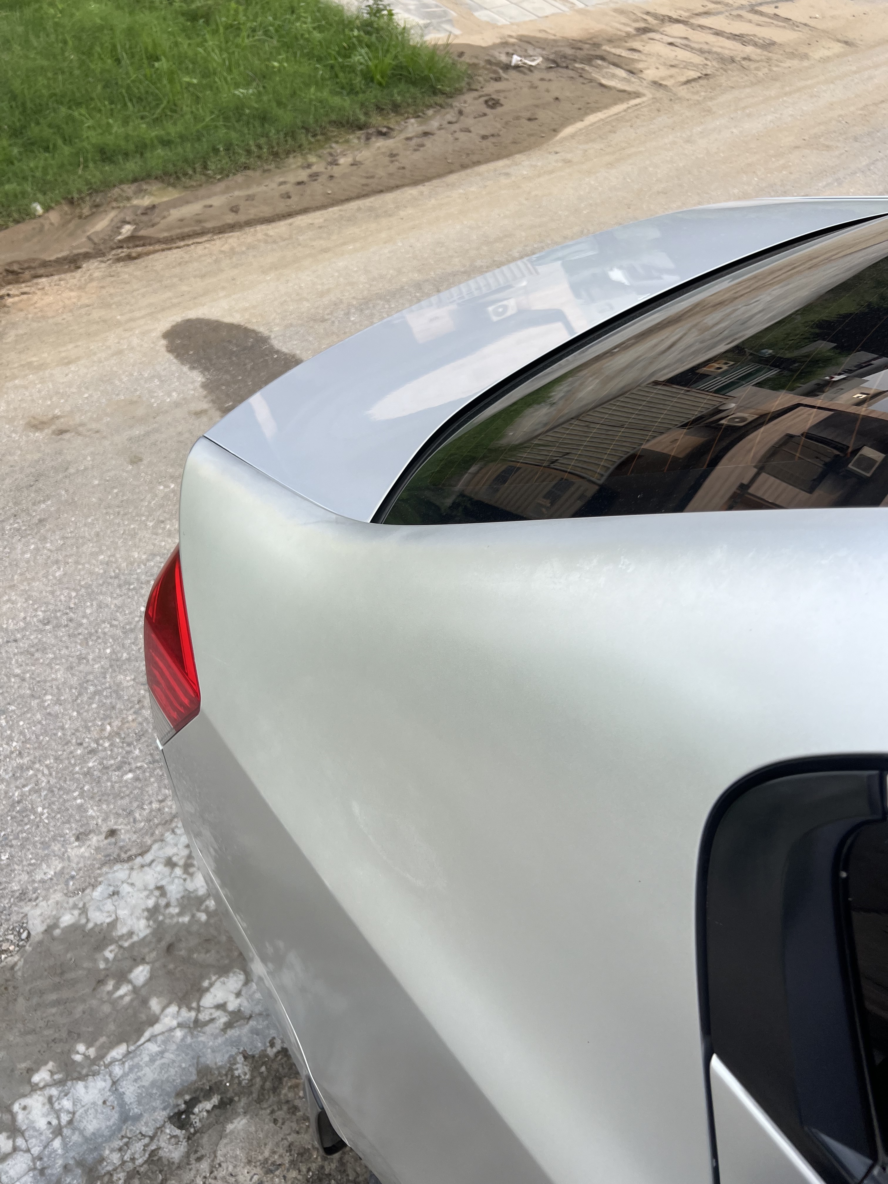

@XULFIQAR and all other experienced members, i have honda city 1.3 manual 2011 model silver color 82k driven and in mint condition. The problem i am facing is that on some panels like the rear right fender and the front left fender, the top laquer coating is fading away and it is becoming yellow and spots of laquer fading/cracking... i do not want to get my panel repainted. Silver colors are notorious for such paint fading issues. Do i need to repaint the whole panels or is there any way to just restore the top laquer clear coat layer. Need opinions for respected members šµš°
Your idea will never work, the clearcoat has delaminated from the paint, it needs the whole area repainted and refinished.

This is very first stage of clear coat failure.In my opinion there is absolutely no need to re-paint these two pieces. Just go to refresh the clear coat of these two pieces from paint guy.
He will take a fine quality sand papers like 600-800 grit and very slowly will remove the damage layer of clear coat until base coat becomes visible. Then will re-fresh it with 2-3 coats of Lacquer+Hardner.Its like one day job.

Thank you so much. I will consult some good denter painter in isb and hopefully i can avoid repaint if possible... but i think i need to sell the car after a year if i feel the laquer from other parts face similar issues before the car value drops

I have consulted my painter and as Xulfiqar sb said, the panels need to be repainted
There is no other way to restore this as the clear has delaminated from the paint. Trying to reclear this is a waste of time as it will look extremely ugly and will peel off extremely quickly too.
There is no way to restore this other than repainting it properly.
