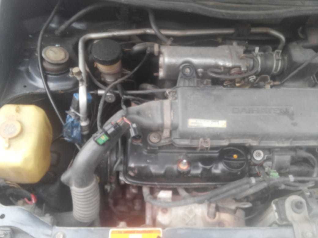

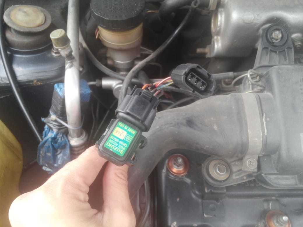

the fuel pressure regulator is a mechanical part, it would be a bit difficult to get for your car as your car is a japanese orphan import.
You also had the injectors cleaned which damages them.
I would suggest to find a replacement fuel pressure regulator from somewhere and test fuel pressure, But as everything is shut - you will have to wait.
You also will have to change the upstream oxygen sensor with a brand new part if its damaged or tired, dont install scrapyard part.
