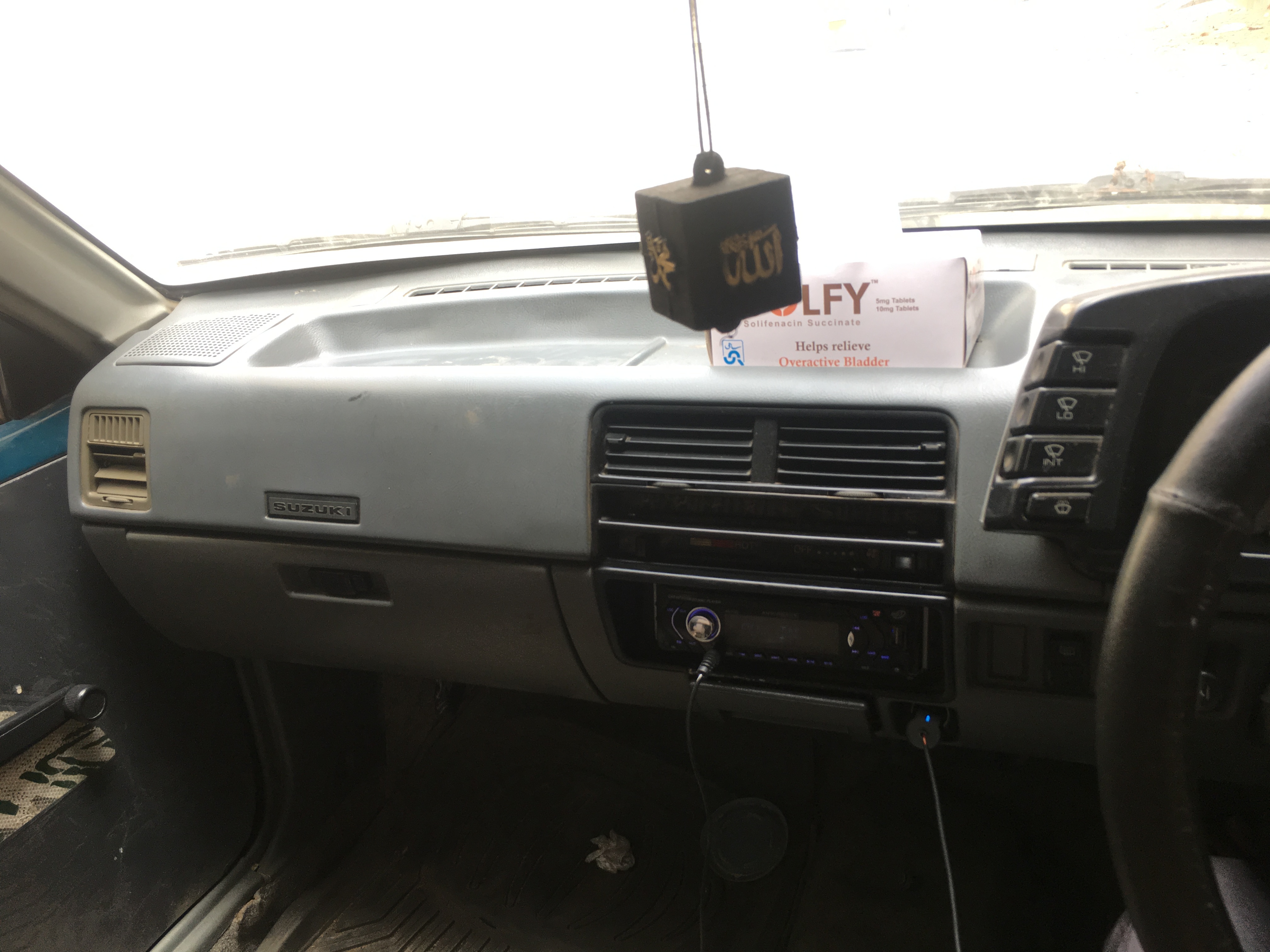

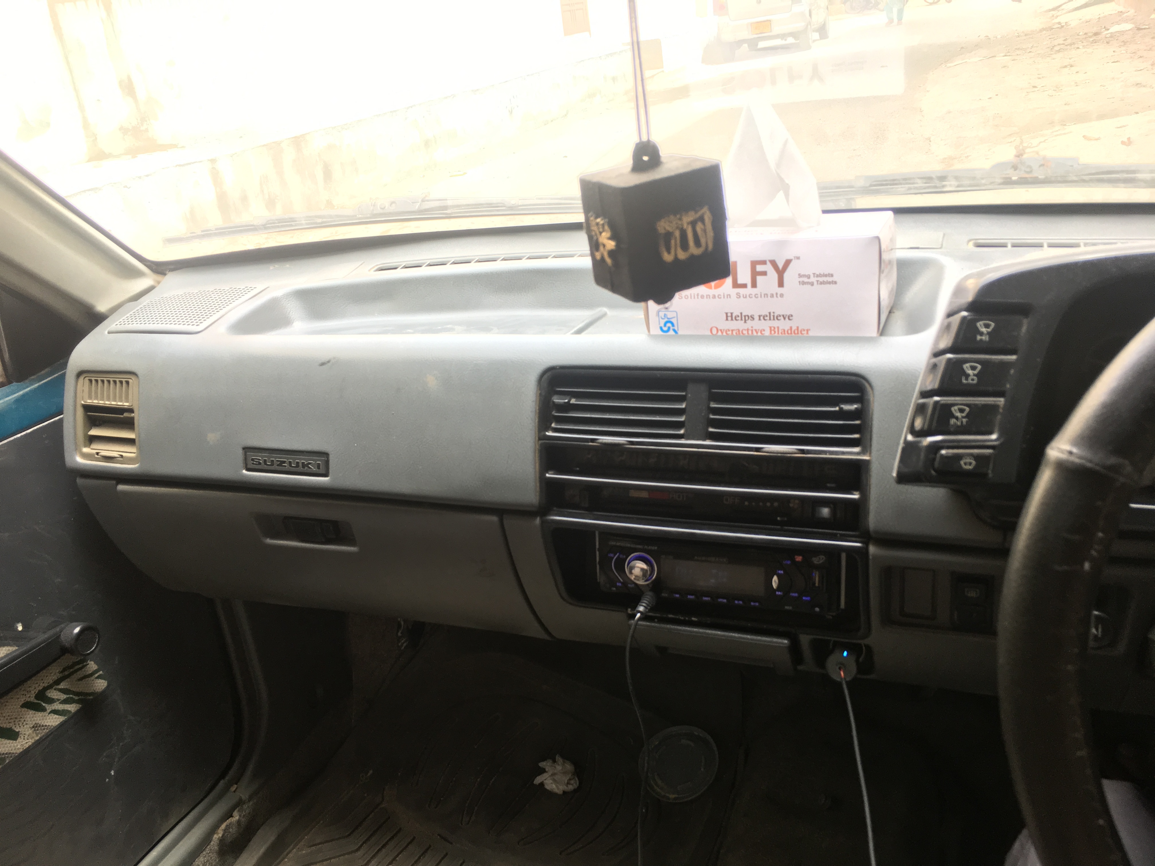

Sir ful orignal h no repaint at all..even k rear view mirror b orignal h.andaza lga skte ap..or neece s ground b blkl ok h no rust..nd dashboard ka ik ik fucntion working m h..pics i show u

Also send interior pictures and rear pics
And about cng many people are forbiding me And Thanks dear for ur such useful information..I have changed oil liqui molyAnd guard oil filter.Smoke was black i went to mechanic he adjusted some settings in carburator nd smoke is not now nd there was vibration it has also has gone..He said speed kam kari hui ti..I live in karachi..Nd how can i exactly calculate my petrol avg..in my idea it is giving 11,12 with ac..
@umarpk_2 Mashallah nice. Few suggestions are:1. Get your dashboard polish via Lustre or dashboard polish

If u r using A/C, then cover your dashboard with Dashboard carpet or some mat to save it from sunlight
