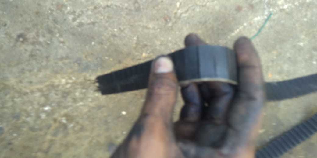

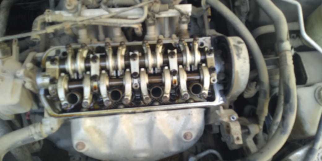

D13 is interference engine, belt snapping is bad news.
Anyway, check first whats going on, it maybe a duff distributor, pop off the cap and crank engine, if its spinning then your belt is intact.
