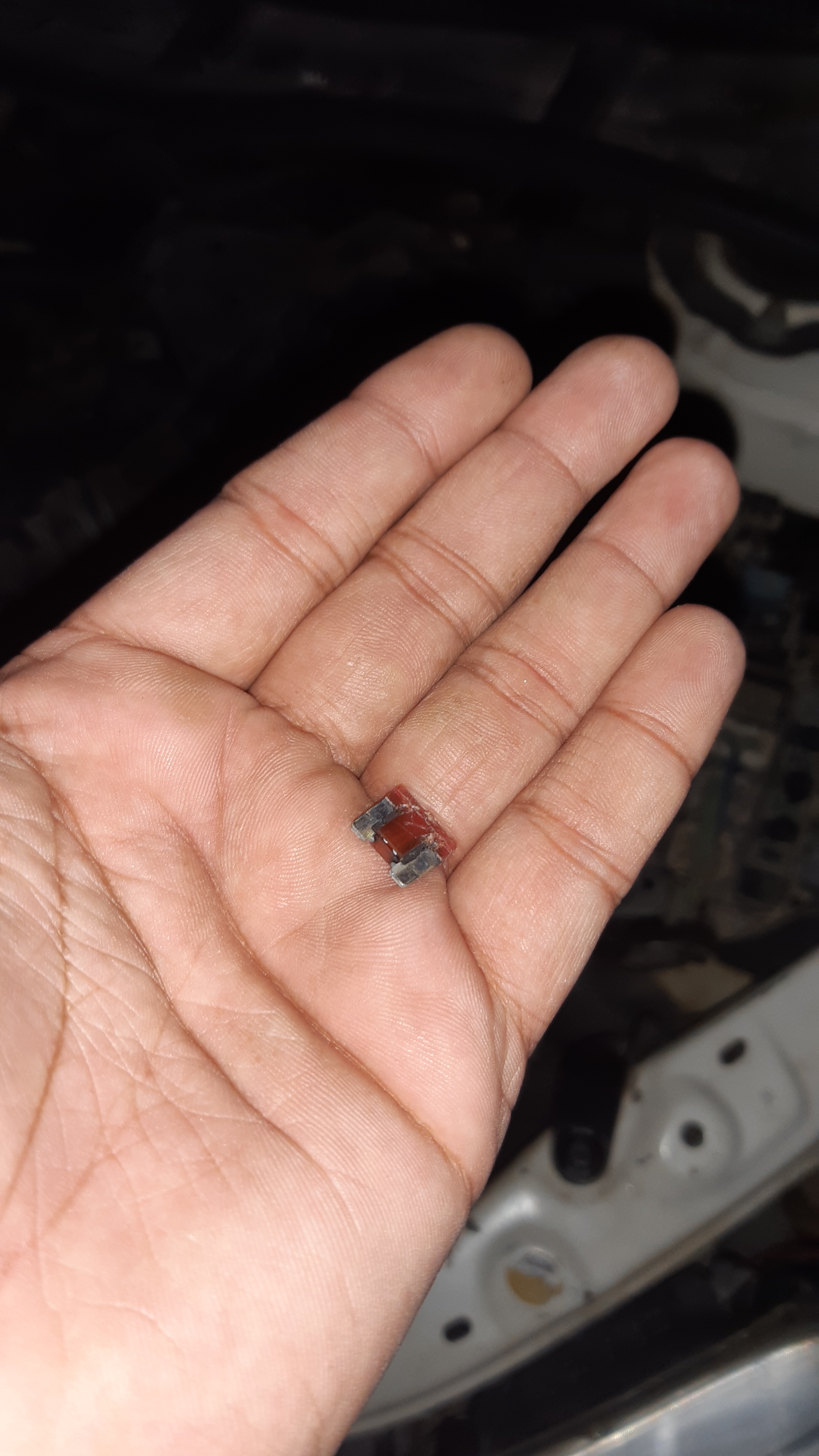

Starter RELAY
Starter FUSE
Inginition Assembly
EFI FUSE
I have face one more issue, when selfing the car, i got some Smoke from the Horn Side, so i guess the iginition is also bad or having some issues, i talked with one Electrician will be visiting him and tell your suggestions too.
note i replaced both CRANK and CAM Sensor QABLI last month and i am sure the last sensors were also fine. they occur due to Long CRANKING issues
