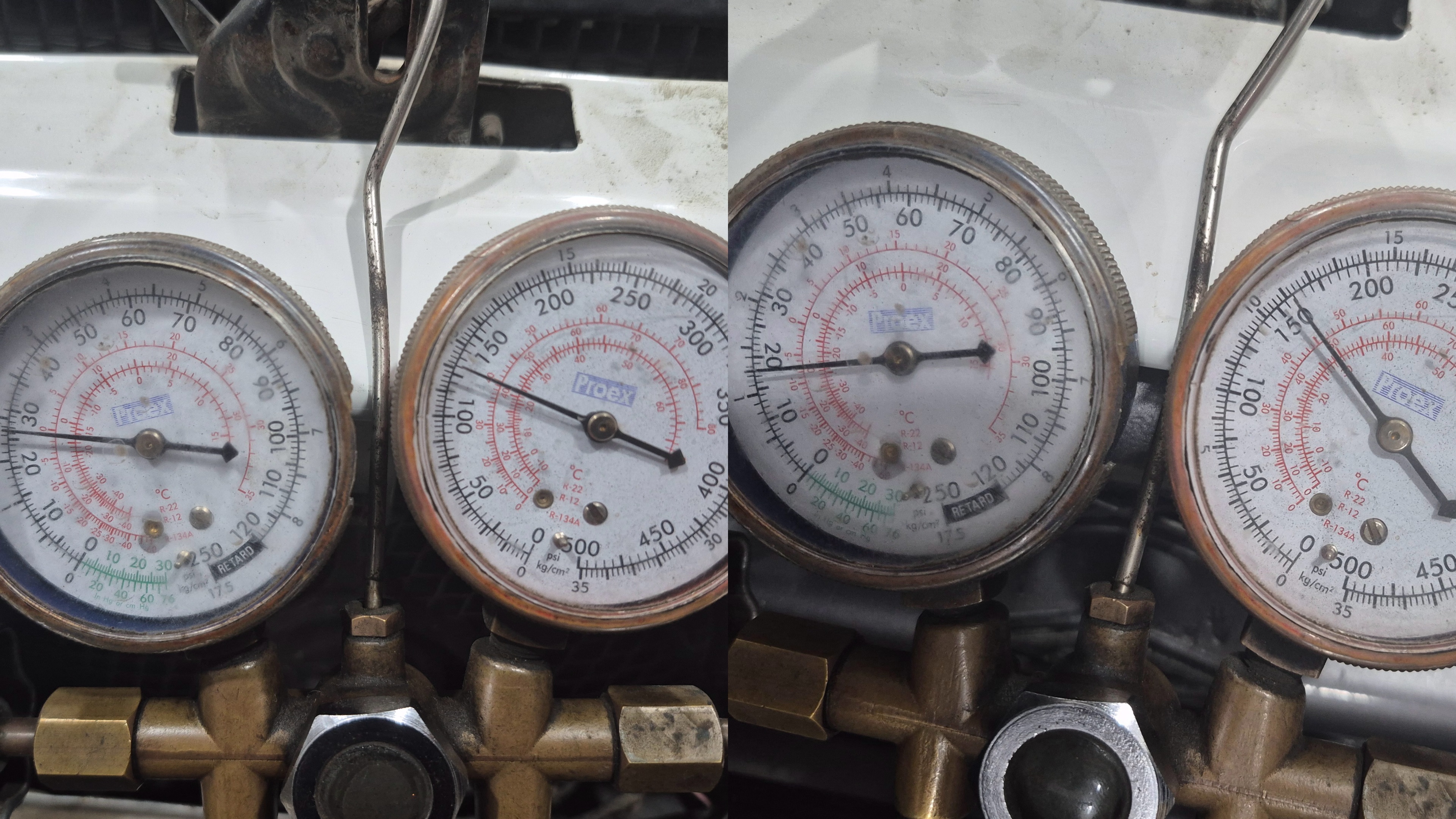

You are severely undercharged here,
18 psi on the suction side means you are close to 20f which means your evaporator core is at -6 to about -10
Which also means it will be a literal block of ice, but as we can see your liquid side is a piss poor 130 psi, you are not even getting remotely close to capacity.

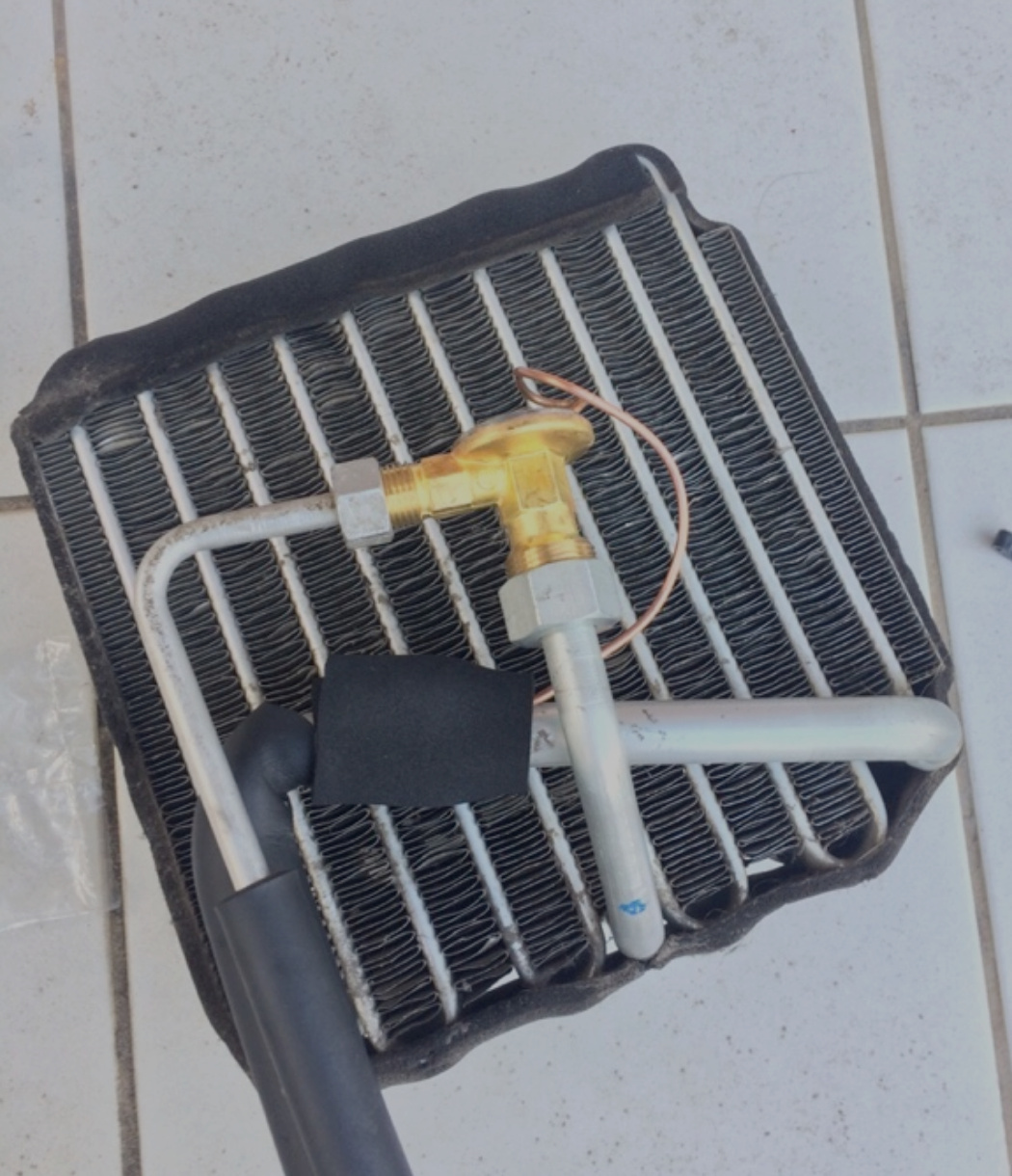

What you probably have is a wide open txv due to starvation or wrong install, if everything is okayish the “thandaa” you experience is just air blowing over a partially frosted evaporator (if should not be frosted but actually sweating - meaning it should be above 0c/32f meaning 30-35 psi, closed off fresh air should force the system to cool off and the thermostatic bellows should cycle it off.
First things first, diy a fresh gas charge with using a kitchen scales to gauge the amount of refrigerant in the small can you buy, that will be a starting point here.
Do mention how cold is the suction line when at fast idle? Painfully cold and sweating?
