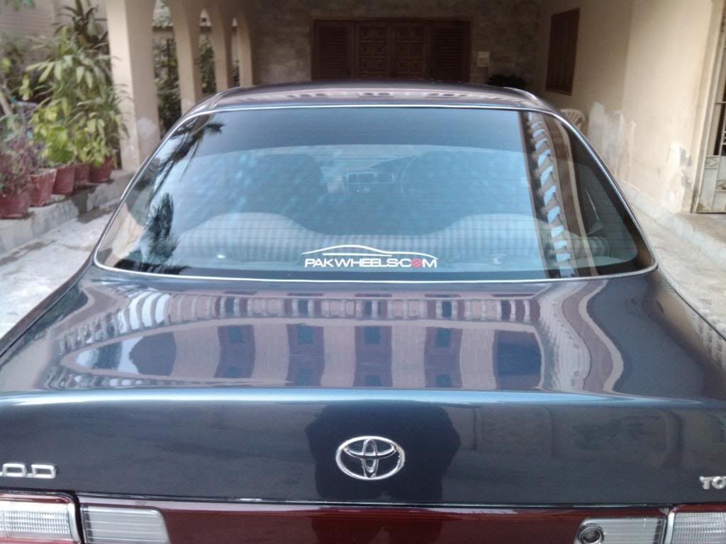

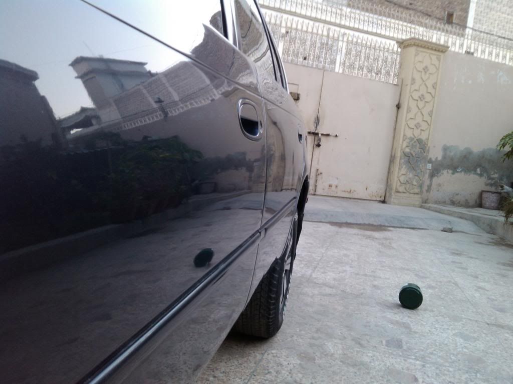

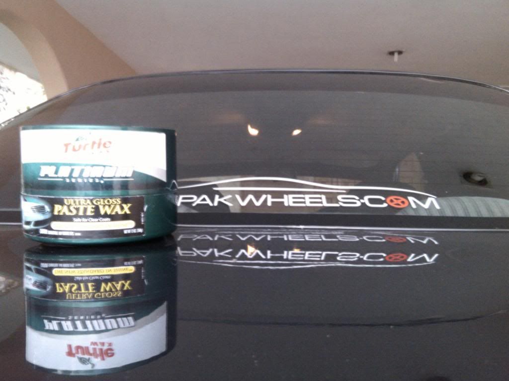

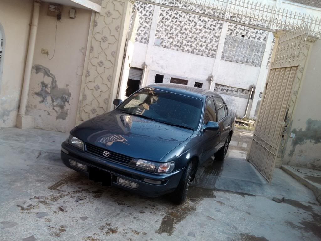

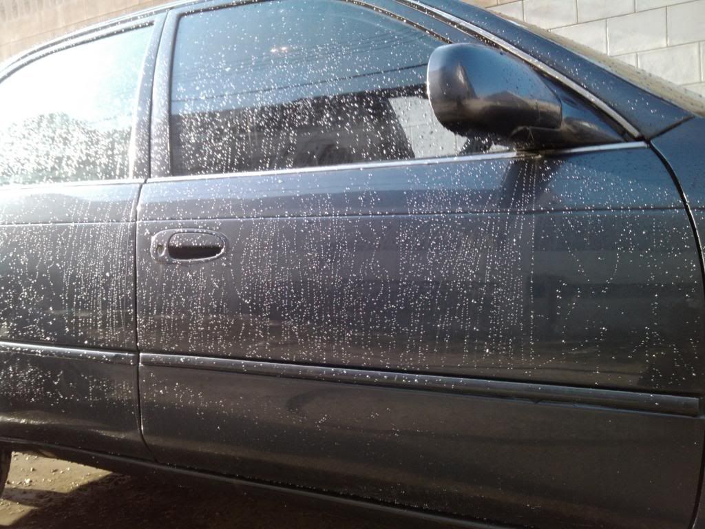

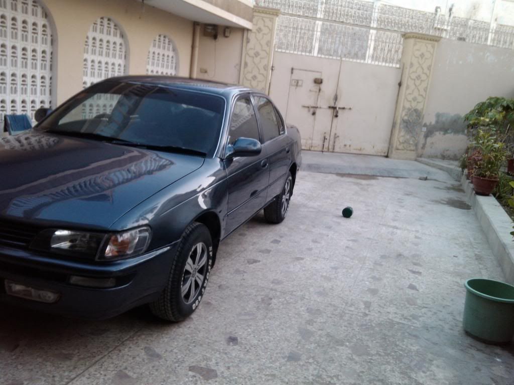

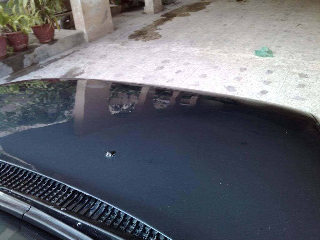

outcomes not bad in view of just one coat of wax, natural wax fills minor swirls and inshallha after regular use of wax these swirls will further minimize than will guide you to next step as glazing, which will further deep black colour and hide/mask imperfections
mild shampoos like mother wash and wax or meguairs ultimate wash and wax soft shampoos and dont strip off wax coat specially if use with double bucket method , so no harm mid week washes , just after shampoo wash give detailer wipe and seems u spraying alot spray of detailer. detailer spray reduce dust attraction and enhance the wax coat life , try to spend couple of sundays for waxing to enrich paint as wet paint cut less compare to dry paint

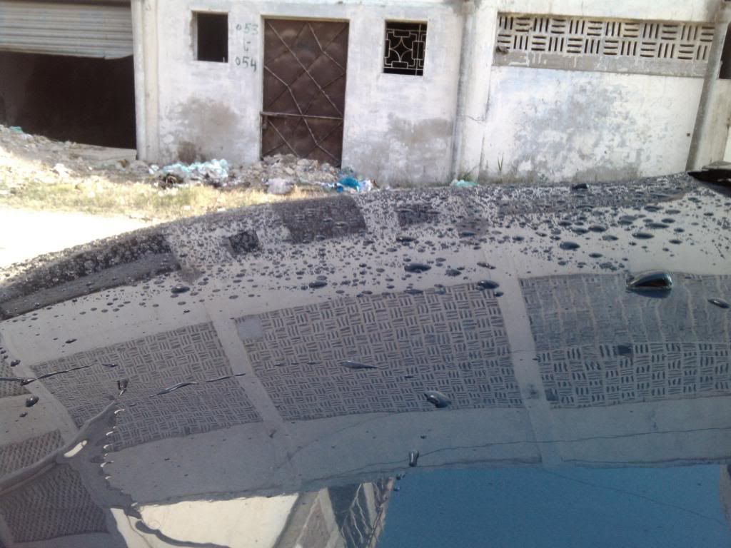

usualy after detailer spray less dust attracts but seems u use detailer spray liberally
detailer spray care light dust but incase of thick dust layer better shampoo wash.
in my view paint cutting at this stage would be useless if u dont learn maintaning swirl free finish so give urself a month or 2 to learn washing, drying, waxing, de-waxing and detailer wipes than go for light cut
