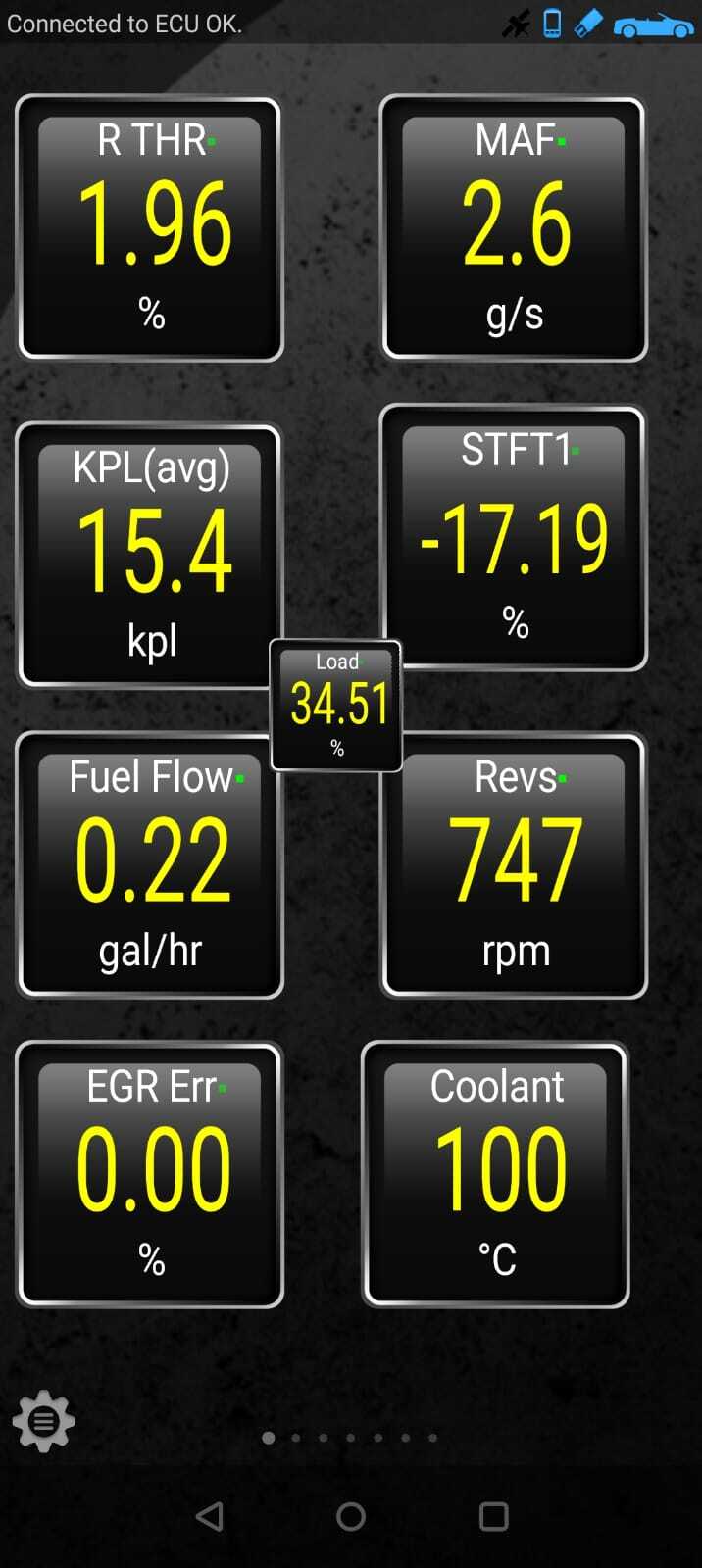

Have you been able to fix Negative STFT? I have the same STFT in my civic 2010. As soon as i remove the dip stick, the engine load goes back to 28-30% from 36-38% and fuel trims to -3 to -4 from -14 to 16%. I have replaced the cat (installed a kabi) , brand new plugs, fuel injectors , pcv, ect, done the valve clearance and throttle cleaning but no luck at all
