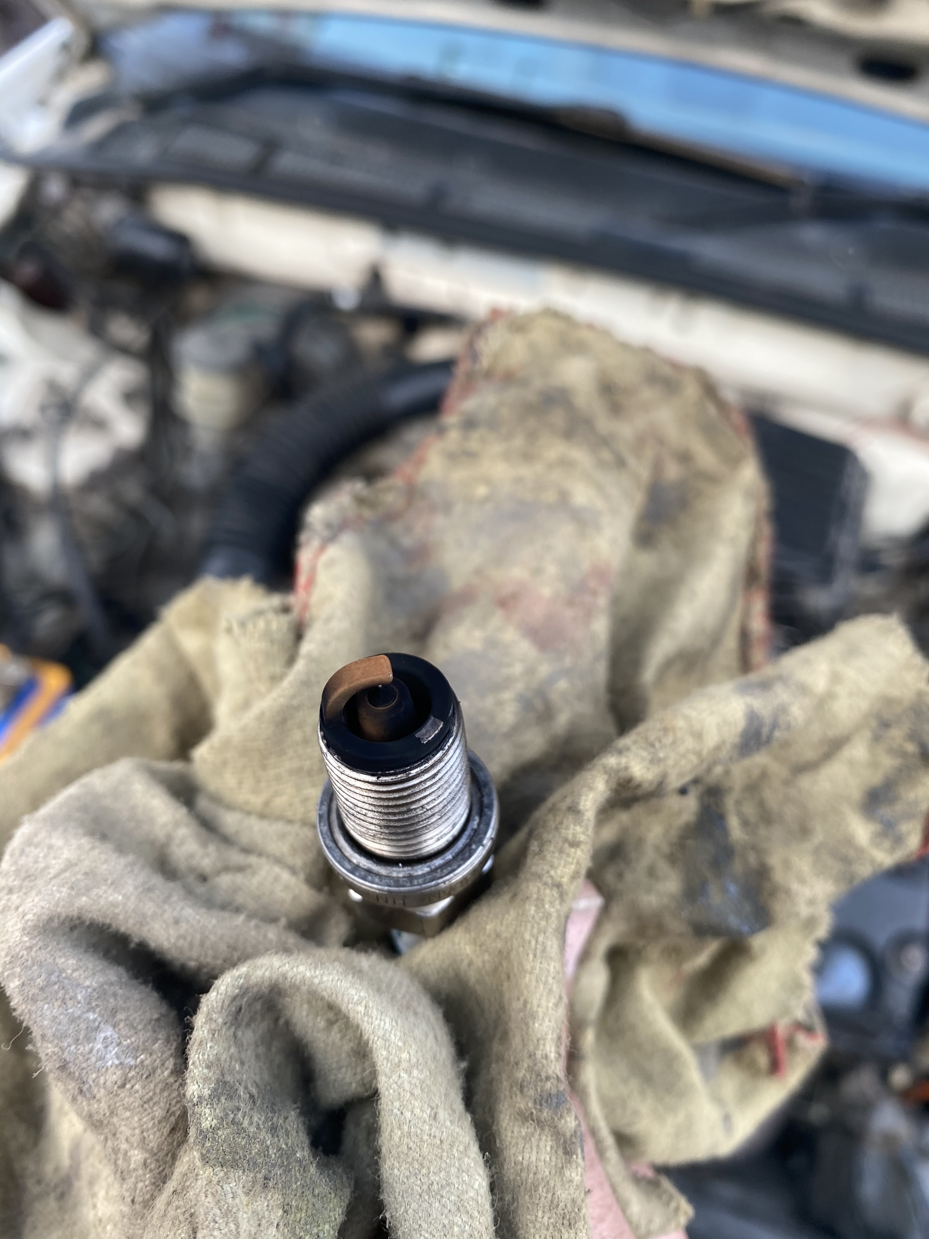

The main problem is the automatic solenoids are not working. I have attached the D4 switch. When I put the car in D on the scanner D4 switch goes on. The solenoids are connected with ECU too. There another switch on the scanner named PNP. The Value on it always stays in GEAR.
