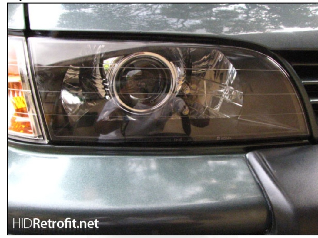

Projection retrofit mein apko chinese projectors 3k-10k tak mein mil jain gay Kabli Japanese universal 5k-10k
Aur apko chinese puri headlight mil gaye gi with projectors already fitted in them.

Your problem will never be solved by changing bulbs even if you use osram night breaker.I have already faced this, so there will be two options for you if you want better vision at night.1 buy some good quality projector lamps and fit in these lights.it will be a little d.i.y.2 option is to buy these orignal koito lights.

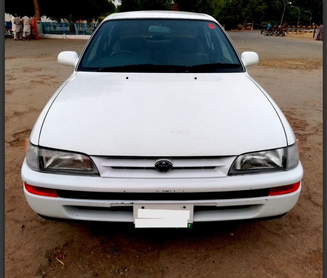

Thanks for your response @chbilalnasar . some electrician had told me this to buy its orignal lights (jis main lines hot hen sheeshy main)I think the projector option would be better. what are you recommendation ? projectors ki pair kitny ki mil jayegi ?and isky sath mujy complete light change karni paregi ya existing cores main adjust ho sakty hen ?
If u go for projectors, that would be a better option. I didn't recommend u bcz they are slightly on the expensive side but a great investment. And projectors look great too . U can use led , hid ,or halogen in projectors. Projectors also have a nice cutoff beam that won't blind oncoming traffic. Only catch is that projectors have to installed properly and their beam should be adjusted properly

Donot buy these projector lights you are looking at olx.they have cheap projector lamp in them which is of no use....try to get good projectors and fit it in you existing light.

Get a projector retrofit. U cant know what quality projectors are in that olx light. Low quality projectors can catch fire.

Yes but do it right. Consult someone if u need. Improperly installed projectors will cause even worse lighting.
Also i forgot to say, when u open the housing, clean it up pretty good and if u can, black out the shiny reflector, would look cool. Seal the headlight well afterwards bcz if water gets inside, it ruins the headlight
