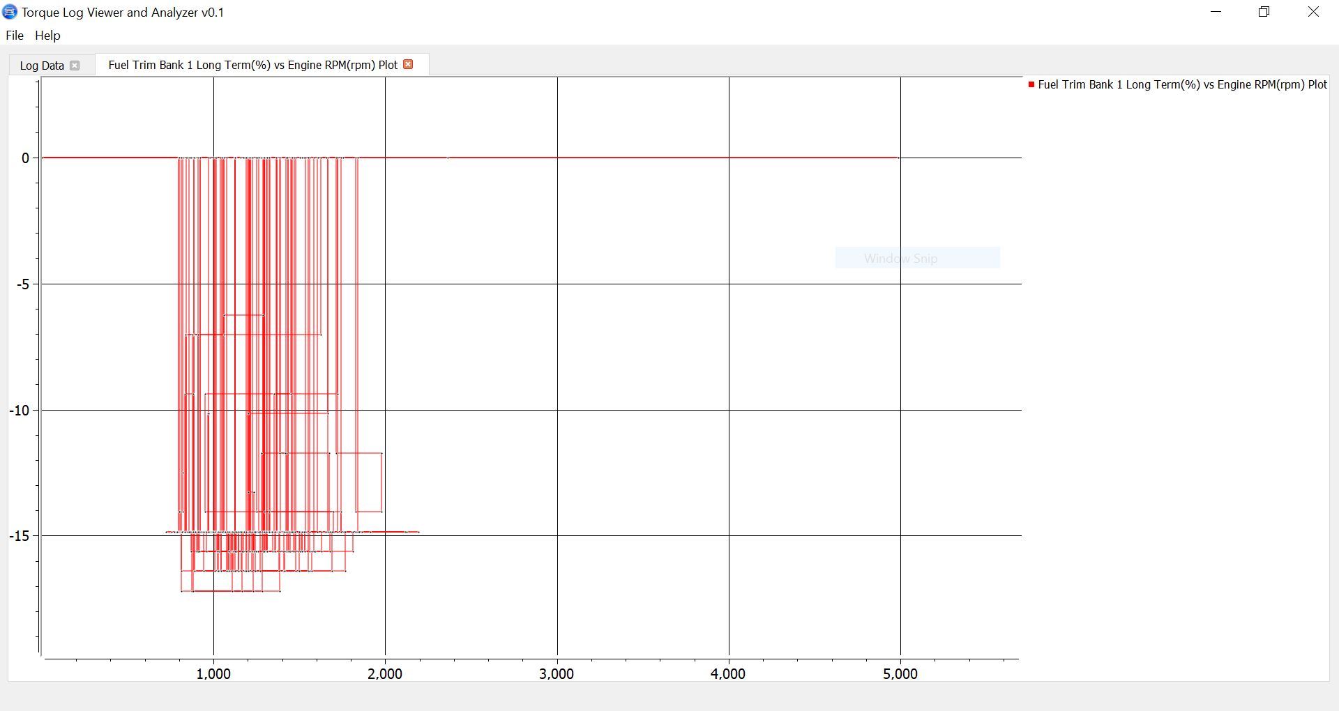

I will record then upload it. But can you tell if LTFT should remain 0% all the time or it can fluctuate?
Your accelerator paddle can be causing this or loose accelerator cable. At rest voltages feed back of tps should be ~0.45 and at wide open ~4.5
Why obd2 scanner only shows tps as percentage? Cannot see the raw voltage values through obd2...
You have to measure it through multimeter.
Long Term Fuel Trim against RPM

Add both STFT and LTFT . But negative means you car is running rich and ecu is taking fuel out. Better injectors are stock?

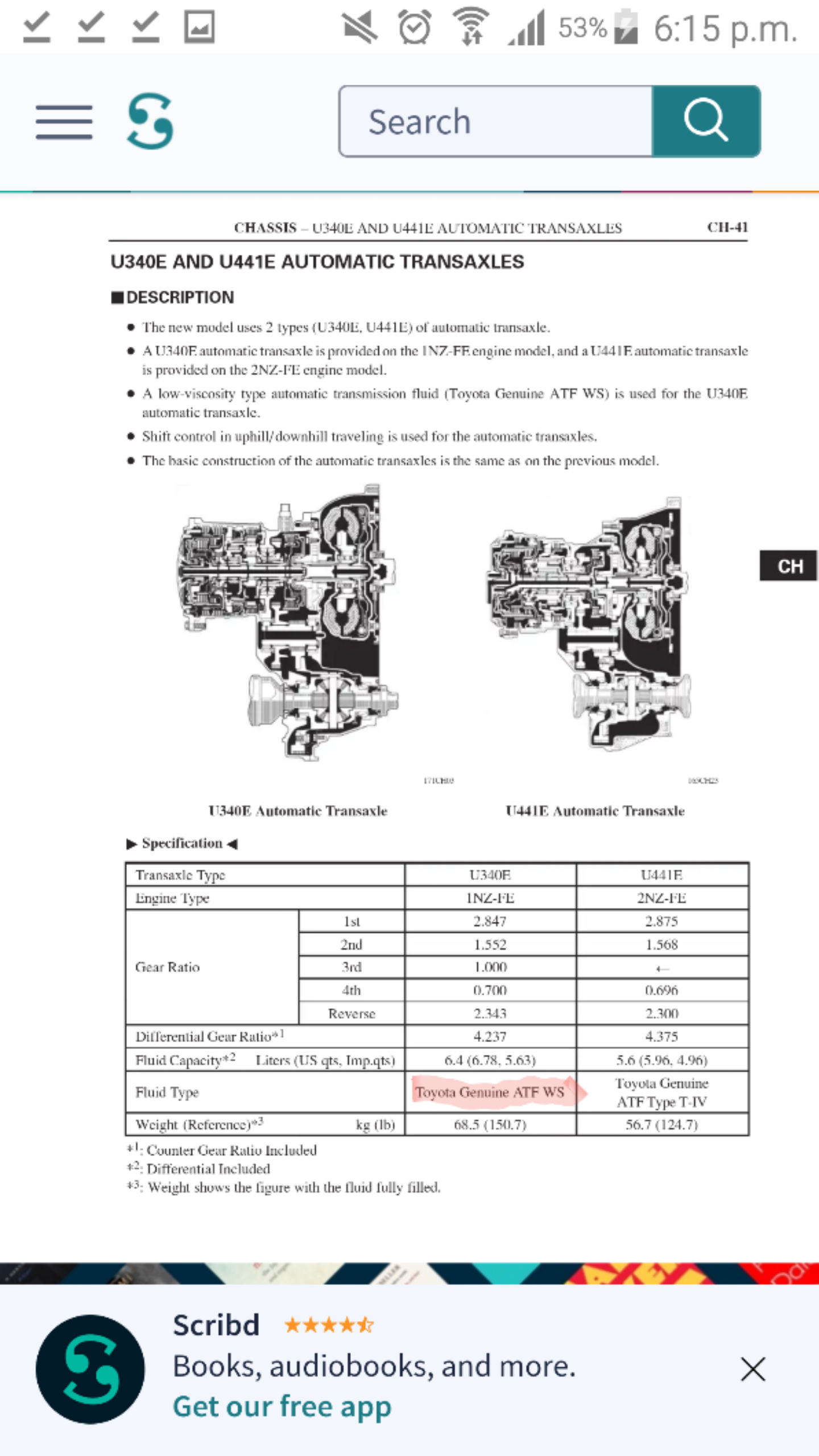

Is ATF WS different from Type IV?
