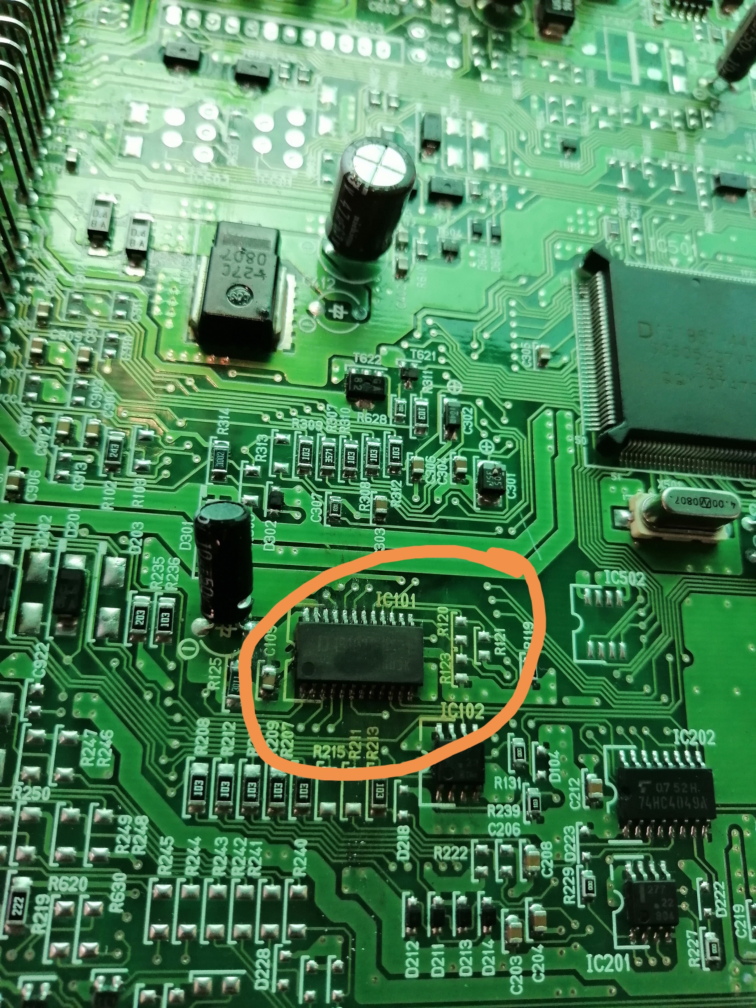

The cold start issue was with the ECU ignition IC. It was fried due to some short probably. Had to have the ECU repaired to resolve the problem and since then have not had any problems on cold start.
